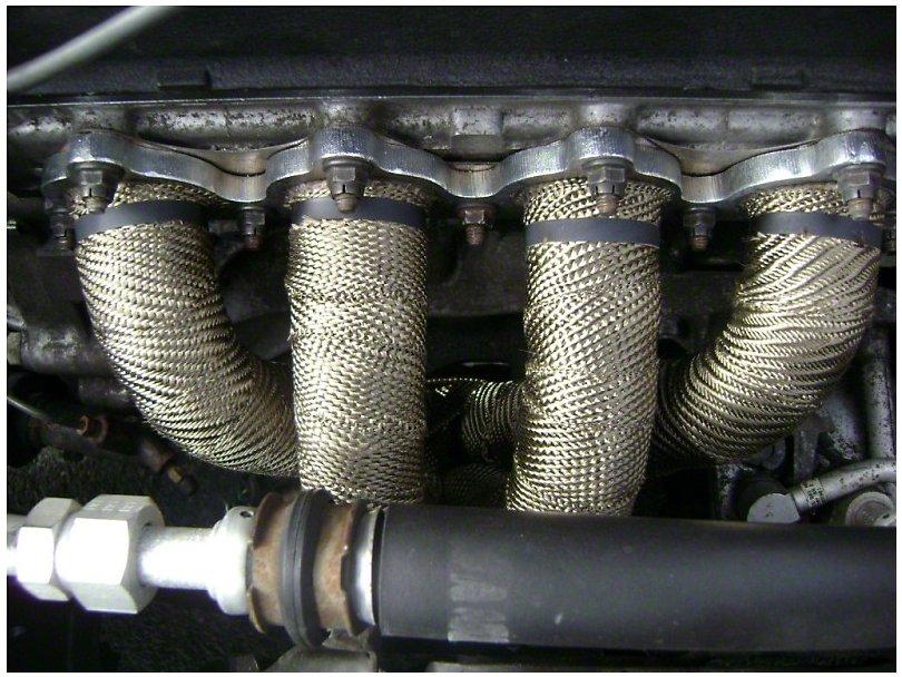

Very nice, will keep these ideas noted.. I appreciate the suggestions very much so dont get me wrong... your ideas and direction may be the ideal solution long term... Nevertheless I'm going to wrap wrap wrap, at least for the short term- to see how things are with the approach.
I'm weight adverse on the car, but as of now I am more heat adverse than weight adverse. :)
Worst case I am (slowly I hope?) damaging piping, portions of which I might someday replace if I can justify a tow rig :) (Headers ) ...while helping spare wear on pretty much the rest of the entire car, nearest & dearest components to the exhaust system being first in order of benefit and there seem to be many.
2 rolls of exhaust wrap looks to weigh 5 lbs... worst case 10 lbs - Worth it for a quick band-aid this summer! :D :headbonk: :headbang:

Interesting...I think wrapping the headers down to the first bend or at the most to the resonator point might help a bunch... think I might try this also. I had 2 headers on my '04 SVTFocus, one wrapped for summer driving, and one unwrapped for winter time. Worked out pretty good because changing the header was a 30min job....

Thank you for the supportive post; I have also noticed quite a bit of heat underneath the car e.g. console/shifter, something that apparently is not unusual after an aftermarket exhaust upgrade. The stock hotbox probably does a good job of being a heatsink.
Per suggestion from [MENTION=13048]MagnaFlow[/MENTION], I will make sure to wrap the exhaust pipes closest to the differential if not the entire / most of the exhaust down to that point.

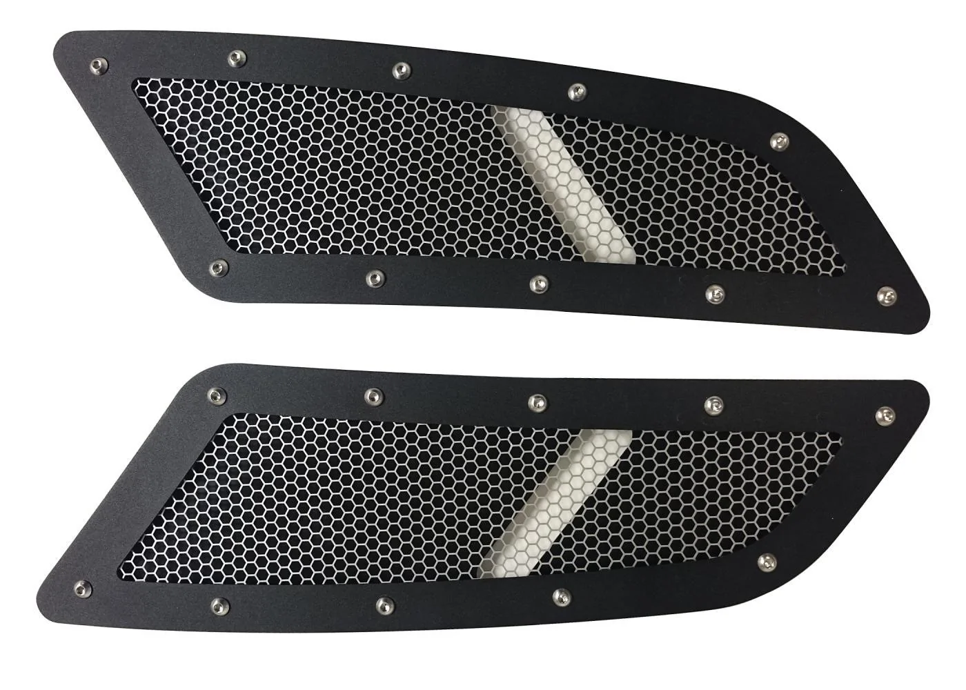

The stock hood blinker/vents look like a fantastic part for aftermarket replacement - larger ventage along the entire length of the part might work wonders in tandem with higher flow grill, no?
Pic to come
Pic to come

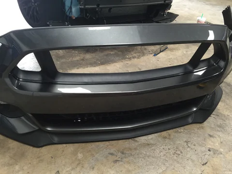

Yep, that's my stage 1 plan for high underhood temps - grill delete and these extractors installed without the backing plates.
(First pic borrowed from [MENTION=9374]Sock[/MENTION])
