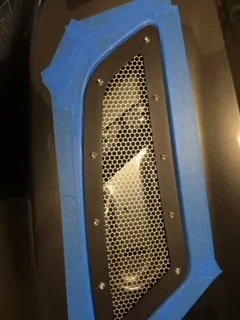

I bought the Scott Drake vents... hoping they will give some relief? Cut away some extra metal hoping it may improve flow? I need some smoke and wind like the video to see if it worked...LOL

Tie some string to them and drive around. It will show you if they work. :)
Not really; the string would be moving but it's going to be tough to tell if it's air from under the hood over over the hood.

Incorrect. If air is being pushed out, it will be easy to tell. Here is a quick example for you:

Yes I could tie them from below, and if they force their way out or up I would be able to tell. Sounds like a 6 pack project.
Also wonder about removing the hood seal and propping the hood Tokyo stytle...LOL

Cool - I didn't think there'd be enough air from below to do that.
