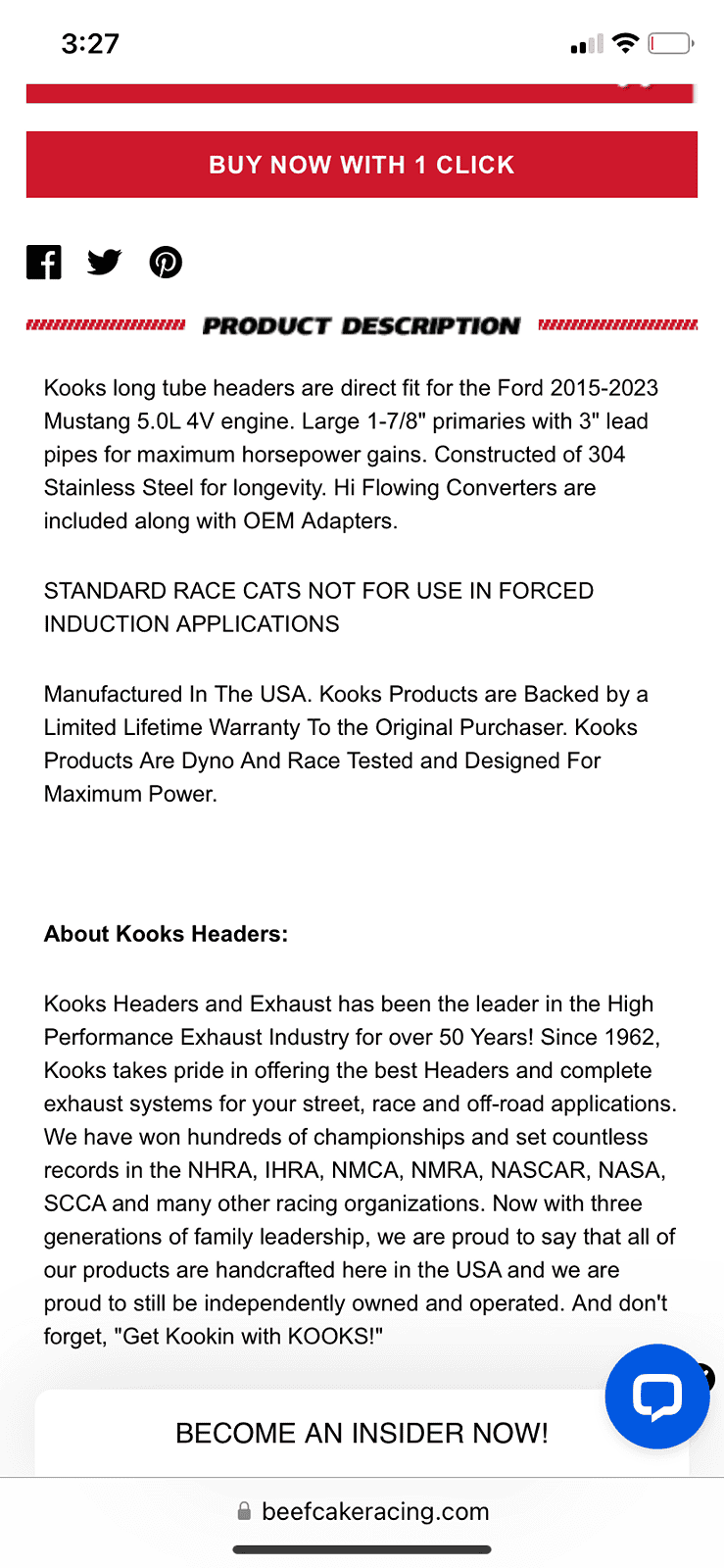

Just saw this on kooks description on beefcake website saying can’t use these with boosted applications. I want to run a ess g3 later this year on the car so is this true? And is this the situation with all high flow cats or just kooks, because I don’t see anything about this on ARH headers description. I really don’t wanna have to go catless when I boost.

That’s pretty much true for all cats, they just don’t hold up well to boost over time. The green cats are supposed to be better for boost, but I’ve seen those fail on people too. The best is catless for boost, or else you may just have to be willing to spend extra money to replace green cats with new ones down the line if they fail. Also fyi on Kooks fitment, I don’t recall seeing any stories of people needing to dent the tubes for clearance. They really are known to have great fitment.
