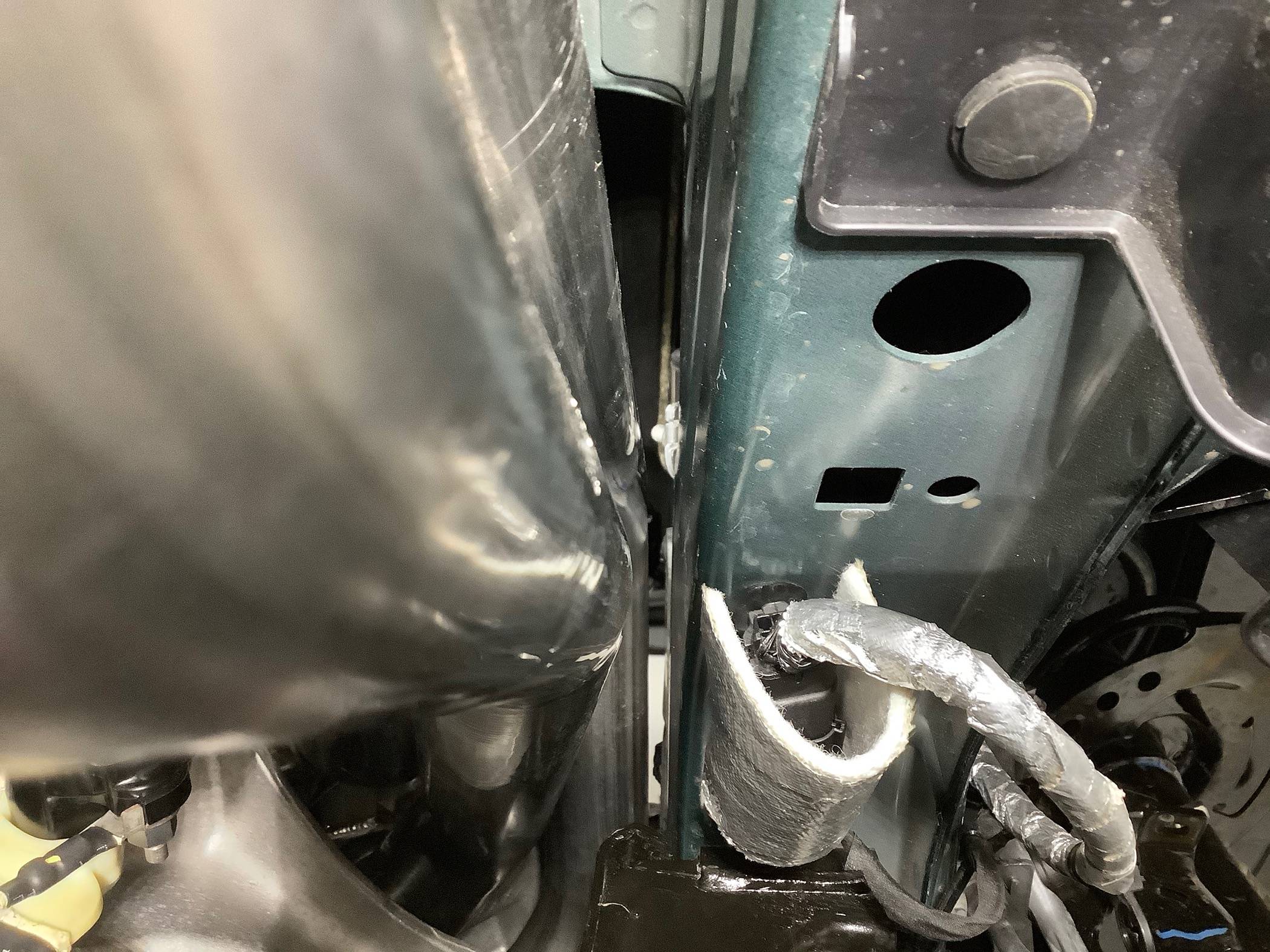

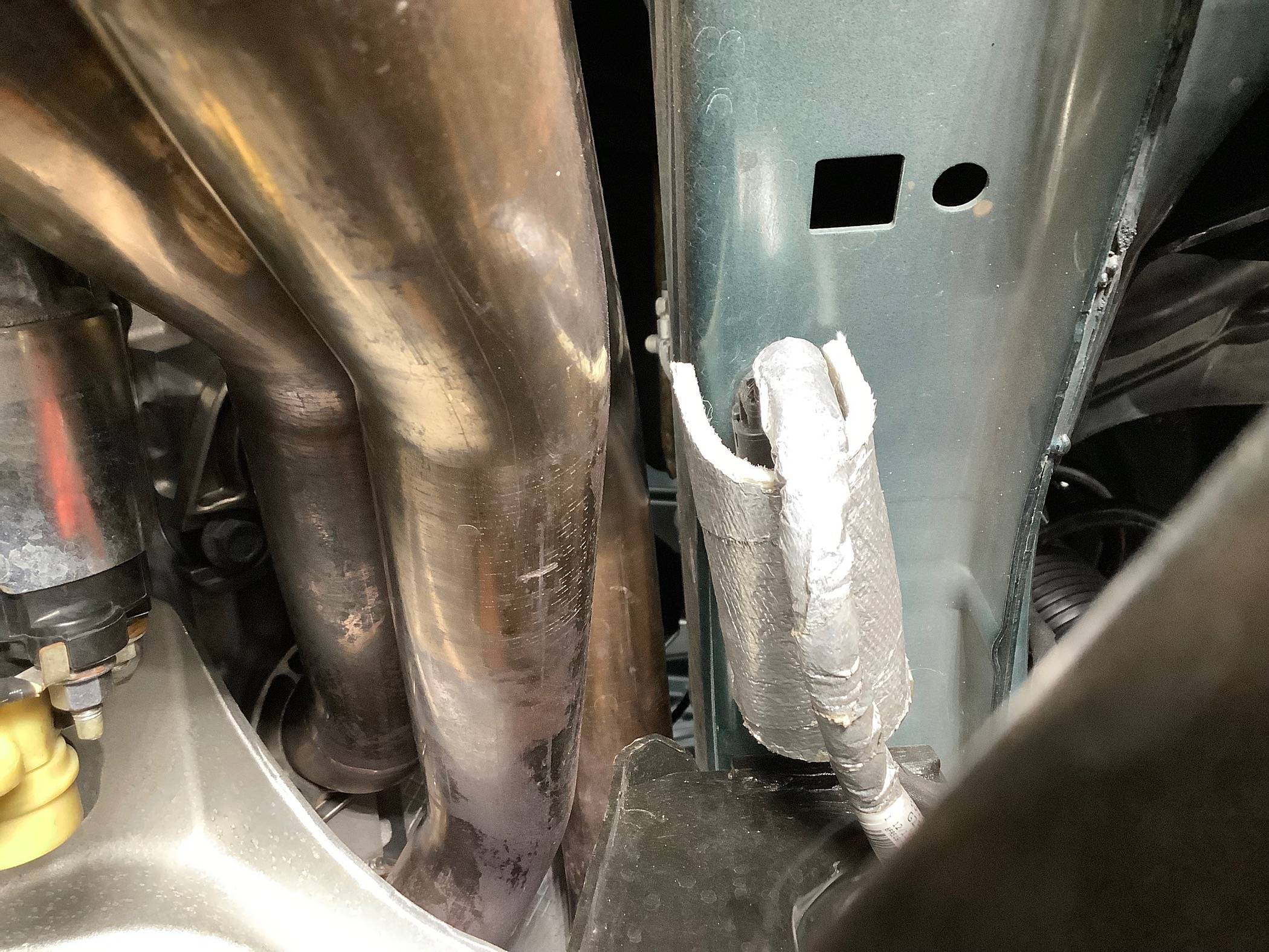

The engine barely twists even with stock mounts. Have someone rev it in your driveway while you watch. That shop dented it instead of shifting the engine or zip tying like you did. Kooks would be your best bet from what I've read. That AC block on the newer GT's is tough to fit around.

I don't understand them denting it that much. I know it's a tight fit but dang. I have Texas speed as well and I did the install 3yrs ago with no experience what so ever ( certified youtube mechanic at best ..lol ) there was just enough clearance. maybe I just got lucky.

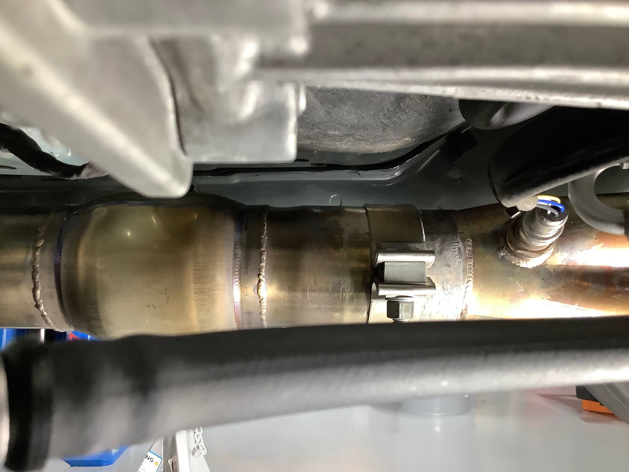

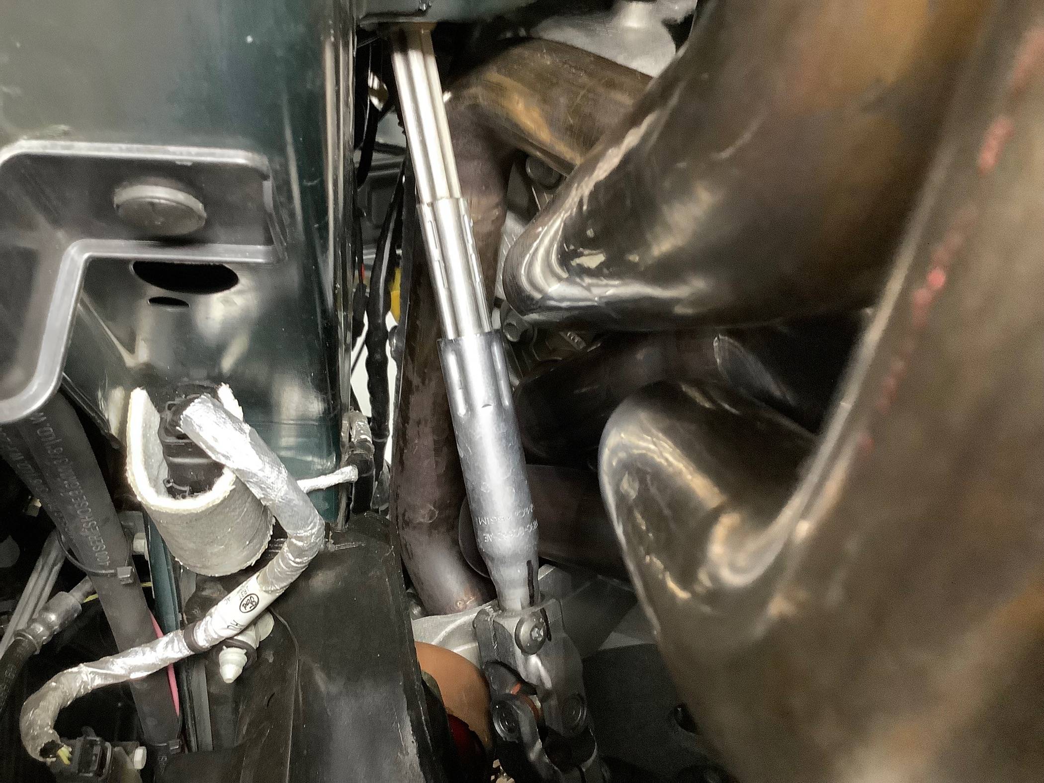

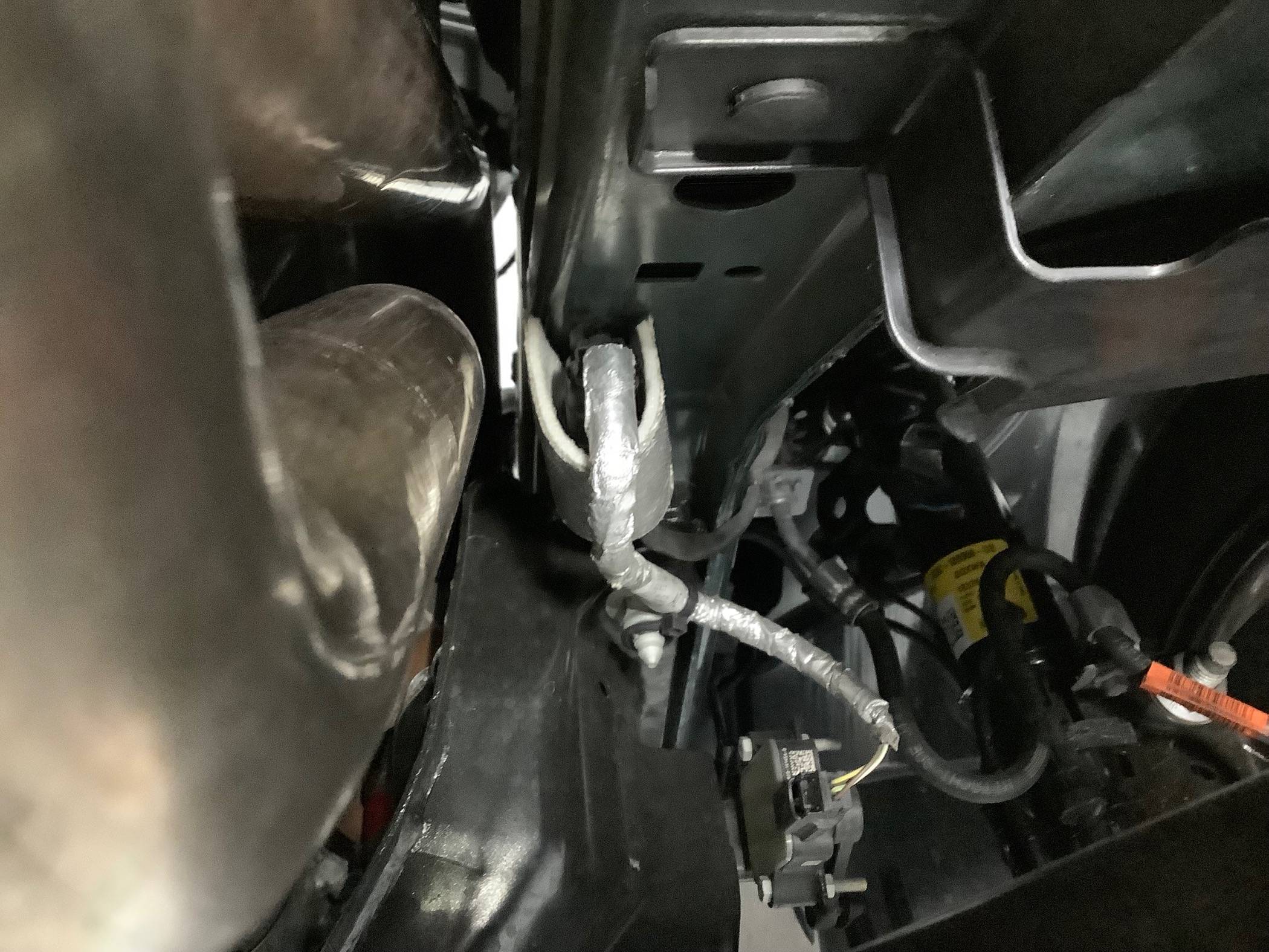

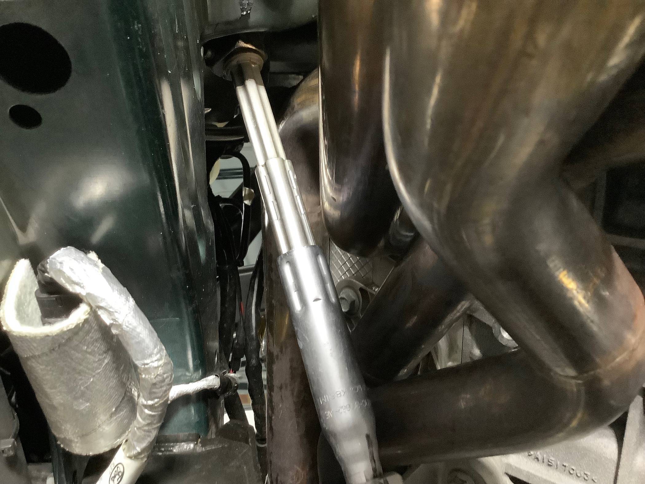

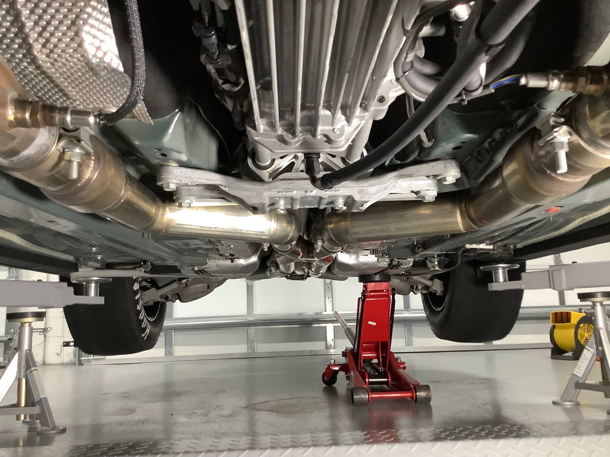

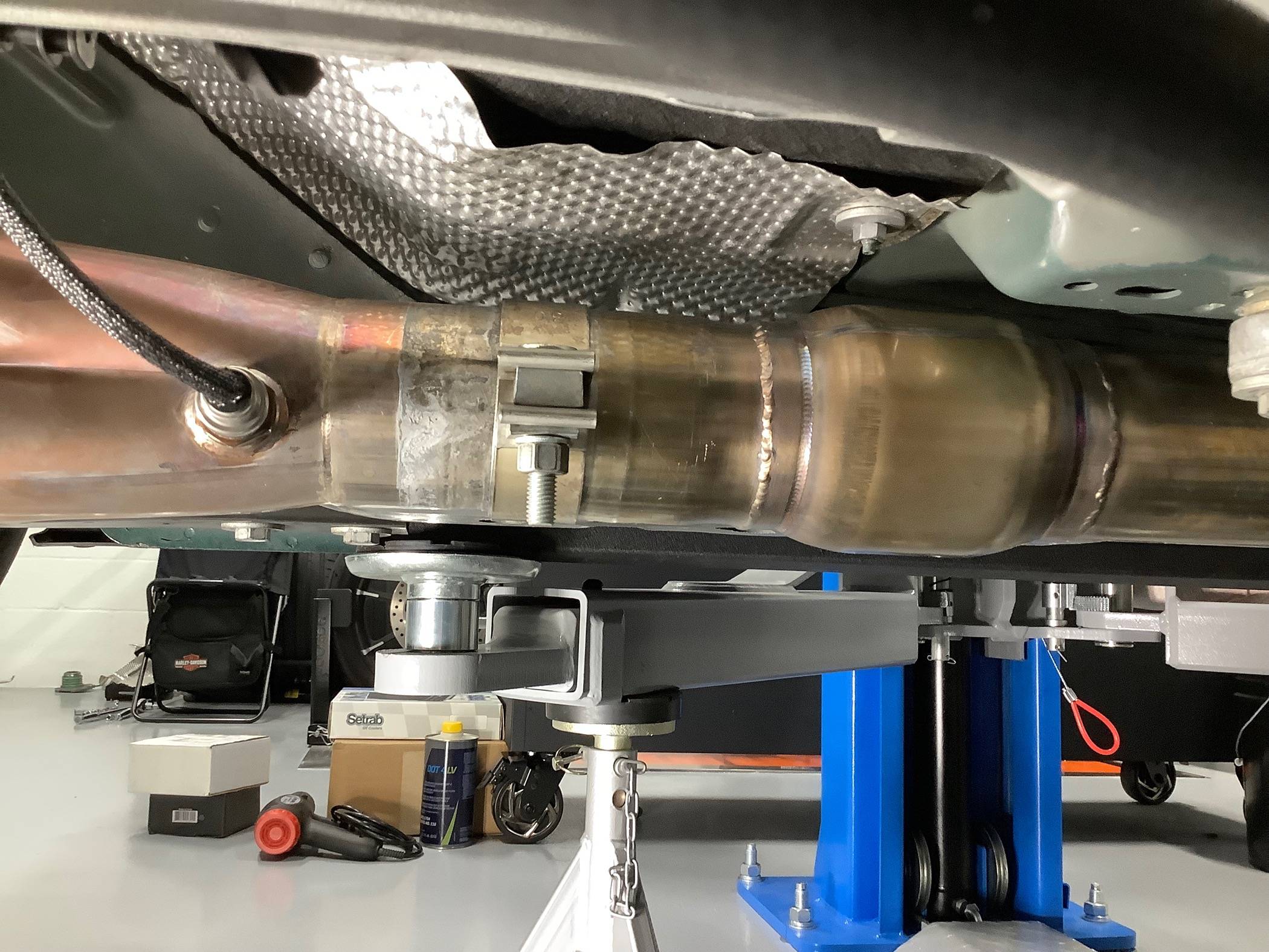

Are the Texas Speed headers slip fit design? My car is currently on the lift, so let me know if you’d like to see more pics of the headers on both sides to show how much clearance is there.

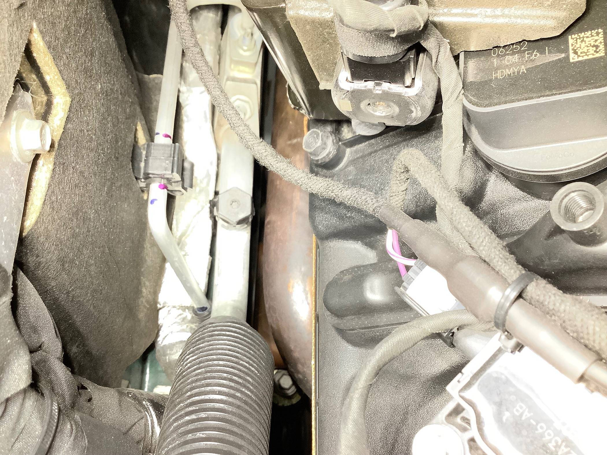

And yea if you could show more pics of the ultimate headers I’d appreciate it, some top down photos like the ones I posted would be good.
also forwhen I see the pictures is the clearance with the engine mounts adjusted?Or did u not have todo that, because I don’t want to have to screw with my engine mounts.

I did lower my engine 1/4”, but that was to make sure the cat bodies cleared the floorpan. I was wanted to make sure that I had enough clearance and could avoid false engine knock.
I now have Vibrant mini race mufflers in place of the cats and clearance has been increased more between the mini race mufflers and floorpan, so if you’re catless, you shouldn’t have to lower the engine at all.
Here are some pics. Let me know if these work and/or if you’d like to see some from a different angle.
