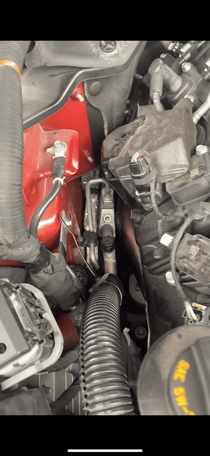

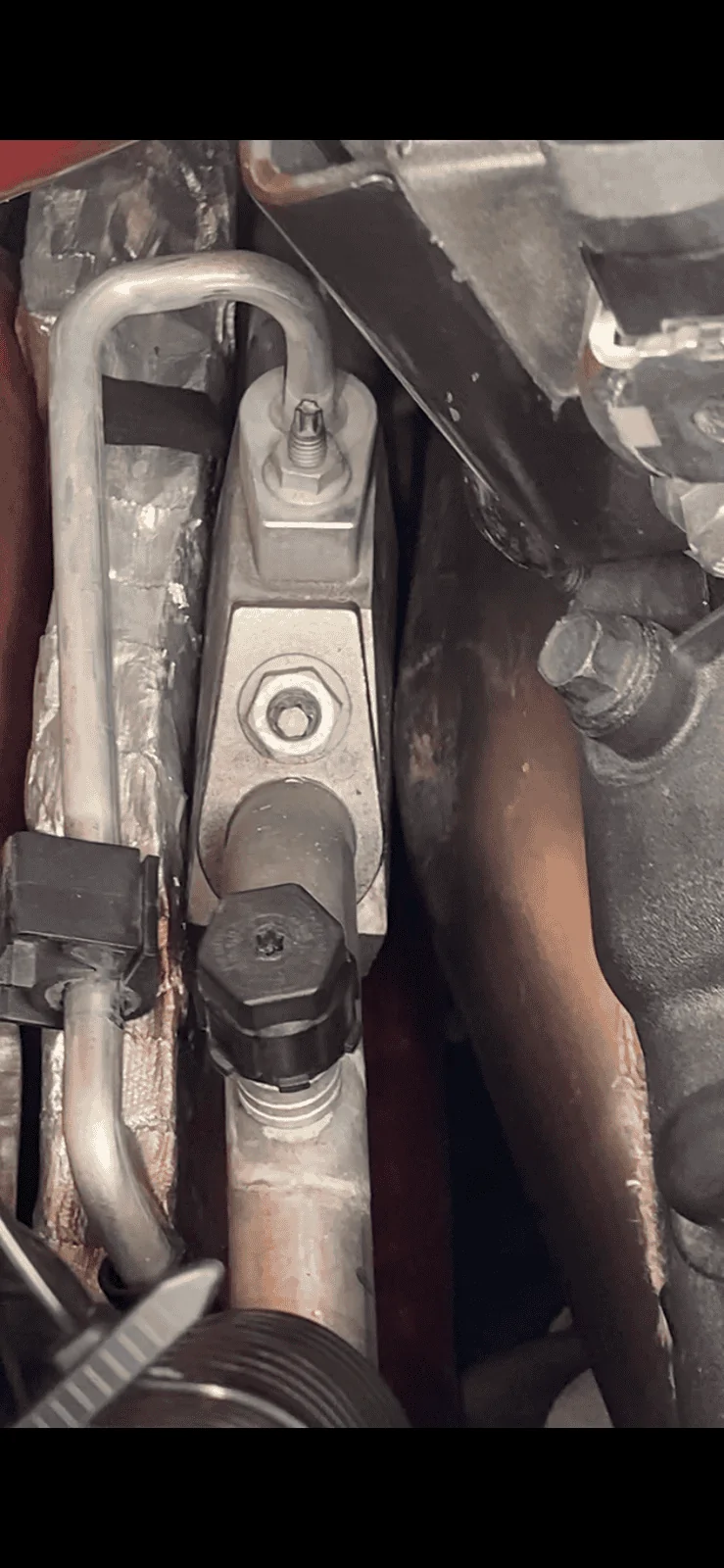

So I recently got texas long tube headers and had them installed by a shop.
I have been hearing a strange rattle from engine passenger side and decided to check around the headers and saw that a part of the headers is touching another part(have no idea what part that is) and there’s even a small dent from these parts rubbing I guess. I have Texas speed catted headers, did my shop install them wrong? Is this normal for long tube headers on mustangs and I just have to deal with it?
(Images are attatched)

That is your AC line.
The best option is to loosen the motor mounts and shove the motor to the drivers side as far as possible.
The second but easier and riskier option is to try and coax that AC line to move up and to the passenger side. The AC line is not the strongest thing so too much force on it is not encouraged.
Lastly, that has got to be creating false knock and killing your timing and subsequently your power.

Another way to make sure you get plenty of clearance from that primary tube is to mark it off where it makes contact, with thr AC line, remove the header, heat it up red hot and put a socket on a long extension, hold the socket against the red hot area on the header and tighten them down together in a vice to make a dimple in the header.
If this is not handled correctly and in a timely manner, the continued rubbing will wear a hole in the header and then you’ll have an exhaust leak right there.

Hey guys, I put metal zip ties for now and it worked. Rattle and banging is gone and the zip tie will be able to withstand the temperatures. Is the tiny dent anything to worry about? Should I try to get a refund or replacement for this side of header? It was 1320 Motorsport who did this job

The dent is nothing to worry about (other than aesthetics). It won’t affect power at all. I read an article ,a while ago about a test that was done on a header set. They beat the primaries with a hammer and dinged them up badly and it still didn’t hurt power at all.

Pretty sure the ac line is still rubbing under load sadly, might purchase kooks headers as people say the fitment of those would be better and I won’t run into these issues. The catted kooks are extremely expensive though and I don’t really need to replace my cats of course. If I bought kooks catless headers would they work with my texas speed high flow cat connection pipes?

Loosen the top of the motor mounts - place a pry bar between the passenger header & the body and push towards the driver side.
Have a buddy tighten down the motor mounts while holding pressure - I had the same issue with mine when they sent me their prototype set way back when.
The dents are nothing to worry about - people have been hammering their headers for years to make clearancing better - been dyno proven over and over again not effect power.
