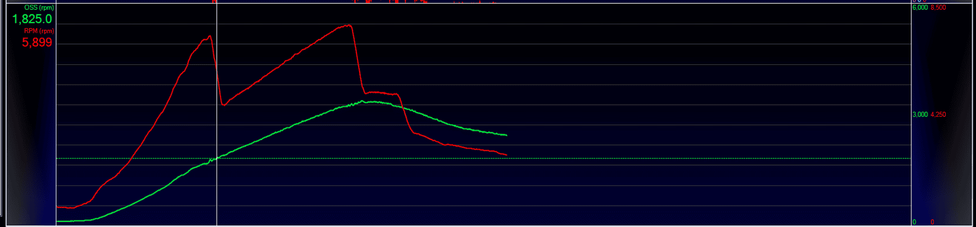

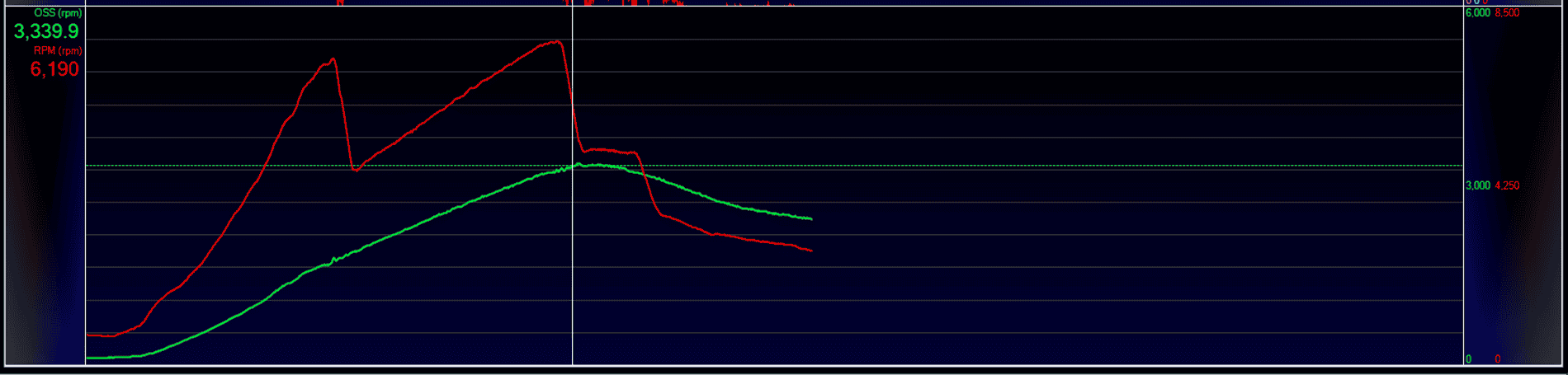

Shift are anticipated.
The commanded gear change will occur shortly before the target so that the shift happen at the target.
You made it seem like it was way off, this is dead on OSS.
So you are looking at the oss in the middle of the shift? I would of thought it would be at the commanded change or at the start of the rpm drop.

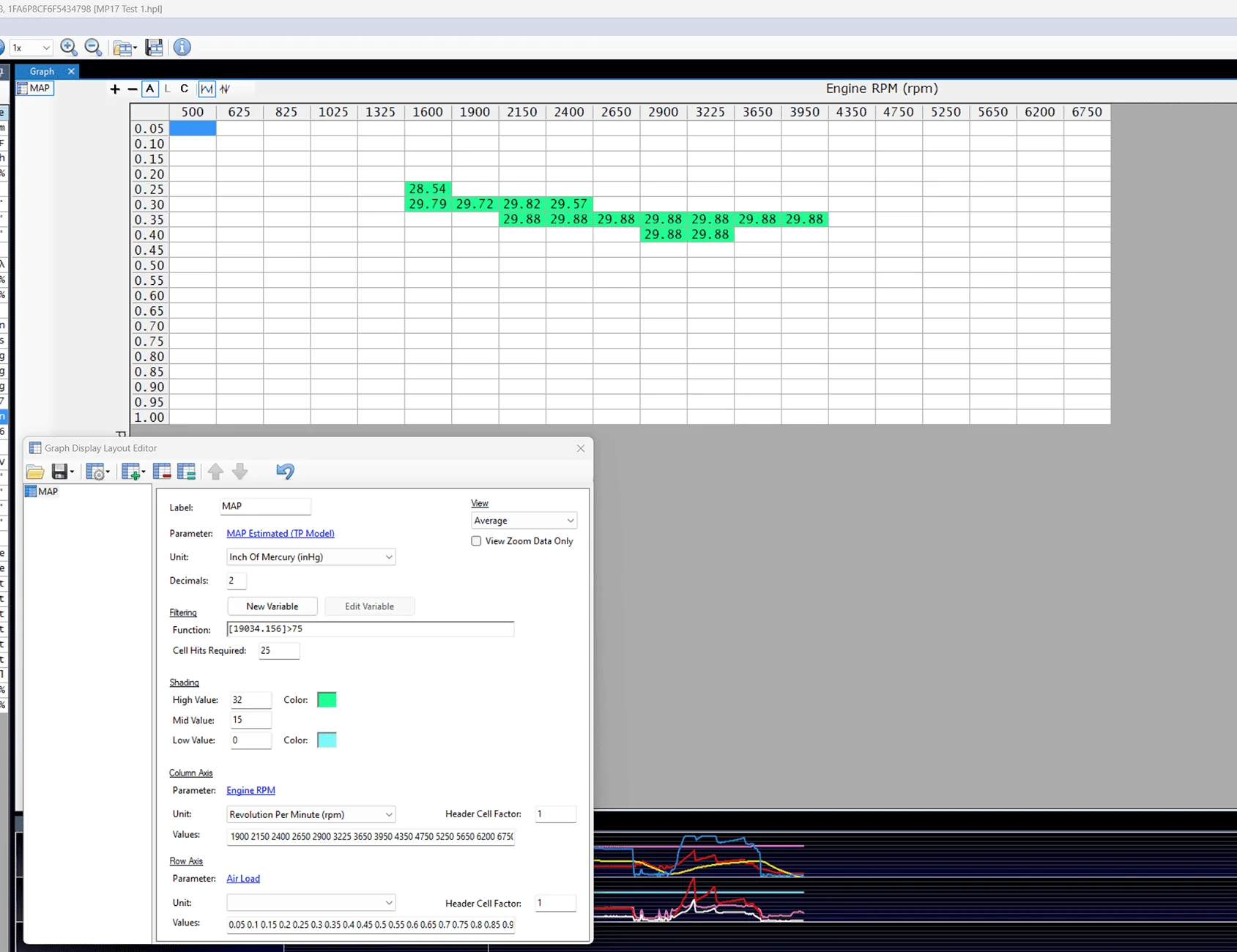

These are not good logs with enough data to see anything from. That applies to all the previous logs as well. You will learn tuning comes down to how well you can log the data to tune from, and it's a bunch of driving techniques similar to the RPM step logs in neutral most tuners have people do to verify their base tune.
You need to focus on holding RPM steady at a chosen value 1250, 1500, 1750, 2000 ect. and varying the throttle so MAP changes from low to high at that RPM. This is best done in high gears at various speeds that achieve the desired RPM. when you get to higher RPMs using lower gears is needed but it becomes harder to hold RPM and vary throttle in those gears as the car will accelerate so high speeds/ open roads may be needed. Really its safest to do this stuff on a dyno, but its exactly the same thing you are trying to collect just driving on the road not a roller. longer logs will have more data, and that's better. While driving you have to focus on driving, but you should have a set of targets you are trying to achieve before the end of your drive. Then just let the log collect that data.
I would be fine with tuning MP5 and MP 17.
If you want to start tuning MP 0 and 14 the base 0,0 angles that would be fine too. You just need to collect all the data in logs.
Now I have these targets for what I want in a log in my head, but realize newer people to tuning may not be as in their head space about what's going on. So what I propose is to set up a graph like the following. and look over at how its filling out as you drive along. Note this filters out MP17% above 75%, and doesn't populate a cell until it has been hit with 25 data points. You can play around with these thresholds as you see fit. As you can see there's not much to work with in this log. Yes, some cells will be physically impossible to reach.

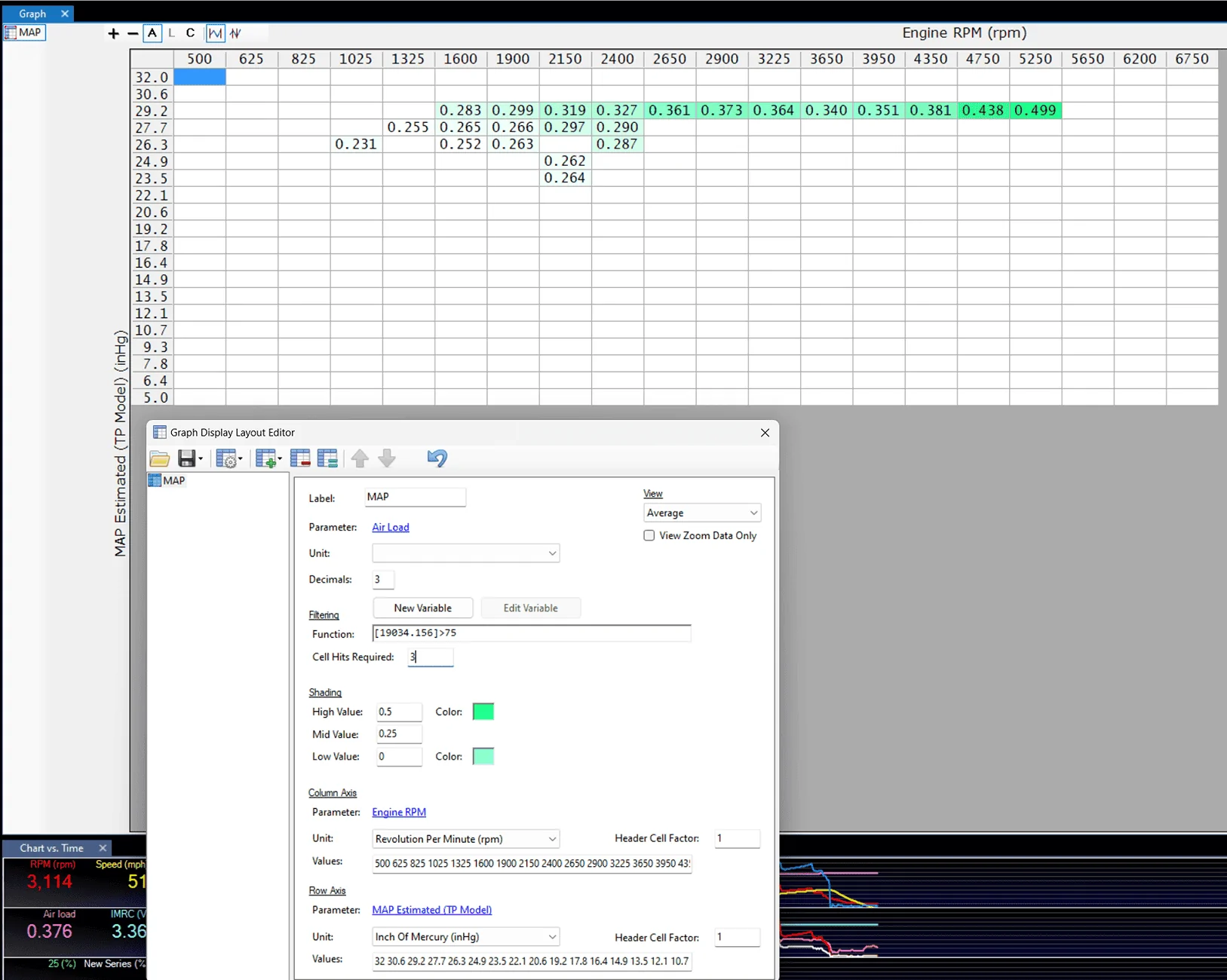

This would be another way to set it up.
All of the transmission stuff only makes sense once you understand engine torque tuning. The value of torque the ECU thinks the engine is making and modulating this value from one gear to another. disabling torque based shifting to achieve the target shift points easier is a common practice. This makes the paddle shifts not operate properly at all. If you are having issues it's because your engine torque control is having issues and needs to be tuned. Get the engine tuning figured out.
