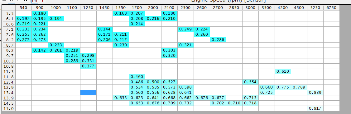

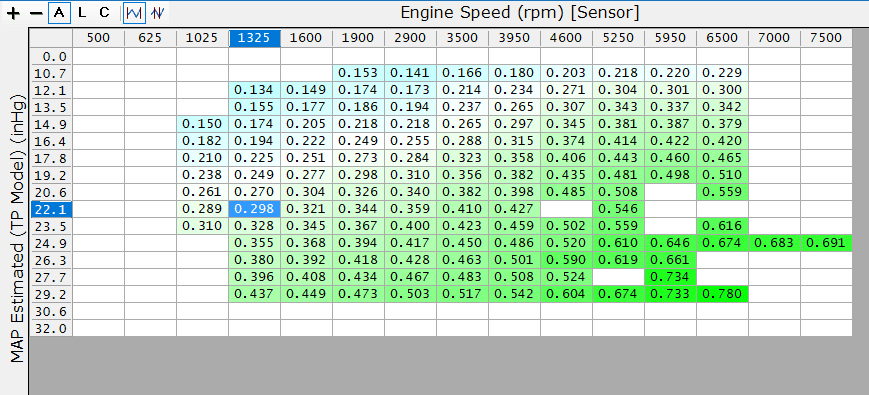

Have you guys tried rescaling Calculated MAP Max down to a lower number closer to what MAP hes actually getting near. Maybe be easier and faster to tune SD that way with populated information then when everything looks square, rescale it back up to stock and infer higher MAP for high load?

What is your y axis?
Pistol_91
Oct 25, 2023
1,438
1,466
Clearwater
2020 mustang GT
Copied histogram from the SD calculator in HPT, I dont have PCMtec, it is MAP

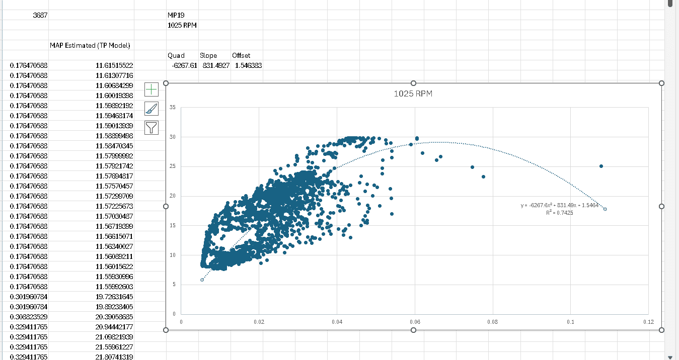

Here is the data chart:
Pretty terrible for usable data haha. Not sure if I did something wrong or if the car is giving me weird data because it doesn't like the cam angle? There are obviously a few outliers I could remove but a lot of the data is in a blob, not a line like I would expect and what @markmurfie showed in his example. My excel file is attached.
After thinking about it I think I forgot to filter it for only MP19 data. I will have to redo it and try again

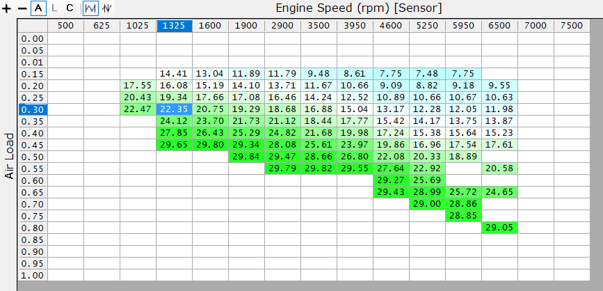

markmurfie
Jun 6, 2015
1,320
626
Hawaii
Mark
2015 Ford Mustang GT

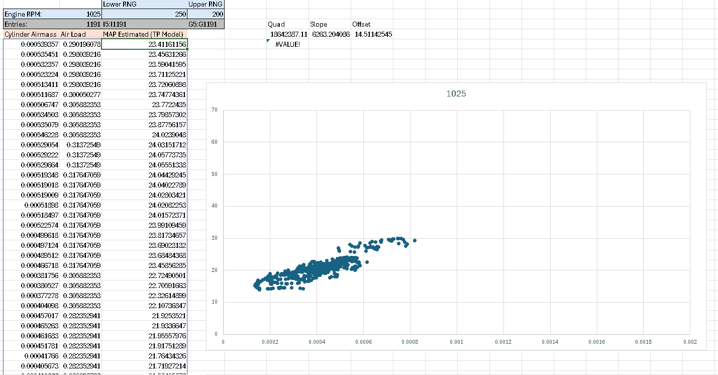

For 1025 RPM and MP 19 here is what I got from your full log. It's much better data.
I will get the rest later.

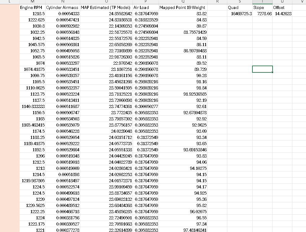

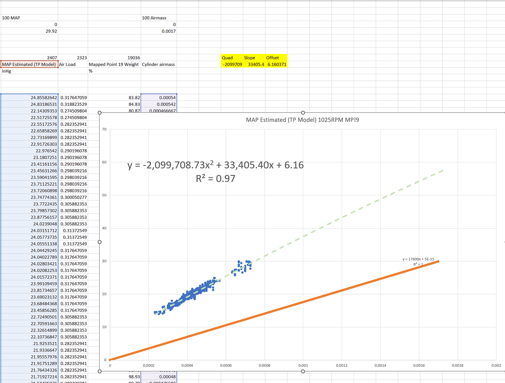

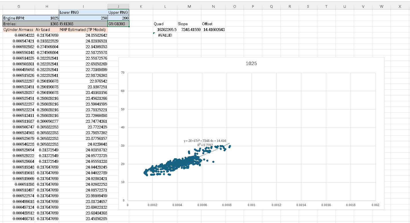

Not sure what I am doing wrong. I redid the cylinder airmass so it should be right now. My Quad is positive, slope is off and offset is off. I also have still a blob while you have a nice cluster.
Could you point out what I am missing? I don't understand why our numbers are so far off.
MP19 > 90%:
MP19 >80%:
Manual MP19 >80%:
Attached is a sheet with me manually calculating it. I assume cylinder airmass is (maf/rpm/4).
