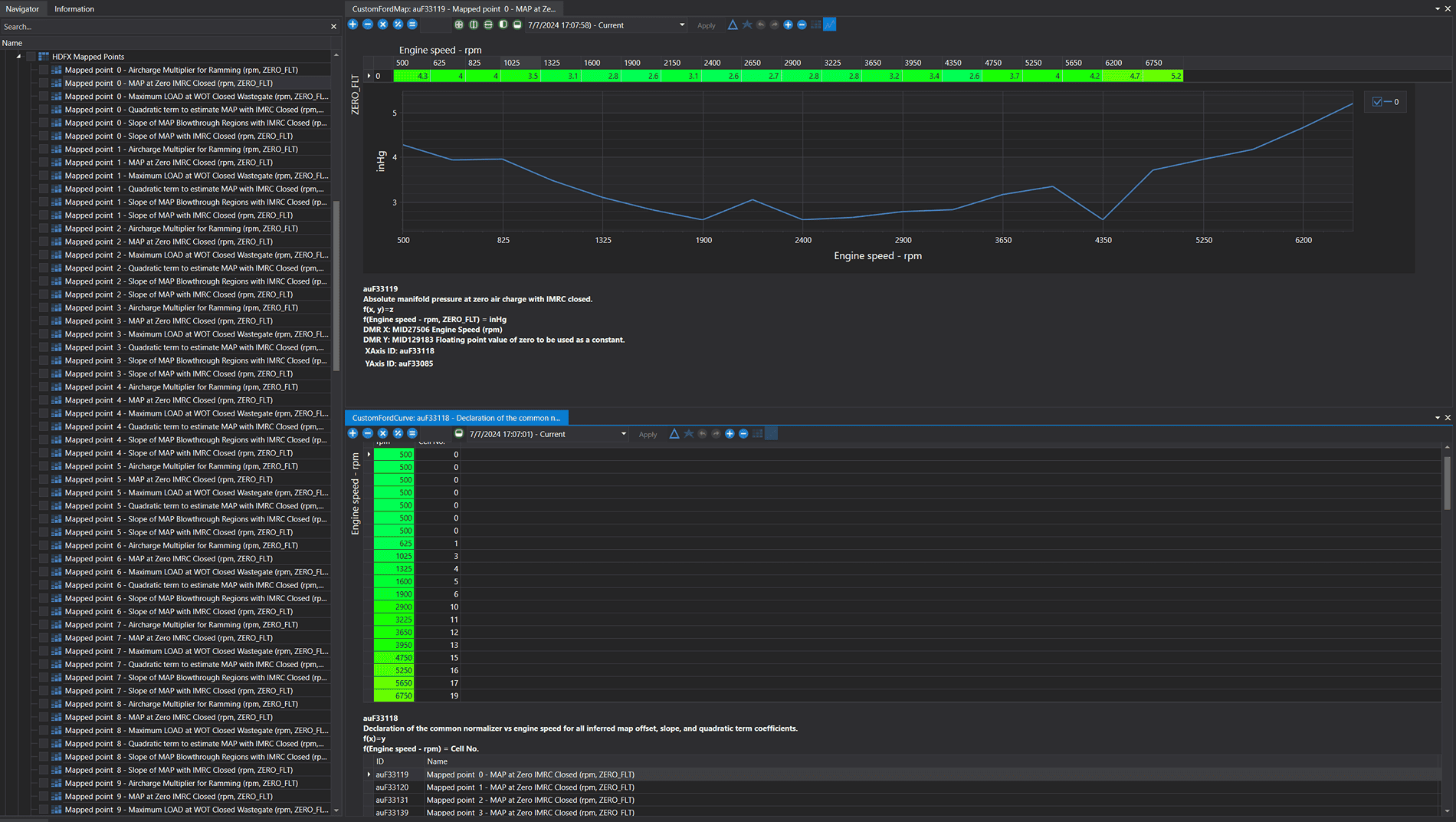

500 would be used when RPMs are actually 0-500. It would then interpolate 500-625. ect.
When coming up with the coeffecients, I try to do +/-250RPM from the RPM value I have the cell populated for.
For example, 1600 I filtered out 1350-1850, but when it didnt return coeffecients I had to expand and filter 1100- 2100RPM.
PCM tec shows table options like you can expand the table but it doesn't seem to let me. Not sure if this is a bug. Will probably just have to rescale the current amount of table options.
If the axis has a name and isn't a "null axis" you can double click the name and it brings you to the table to modify the values.
It shows you which cells they are interpolating the values for. In this case you can have 19 axis values, but 2,7,8,9,14, and 18 where not filled out directly just interpolated. you can not expand it beyond the 19 axis values, just remove any interpolated values or interpolate all 19 values between two RPMs you choose.
It shows you which cells they are interpolating the values for. in this case you can have 19 axis values, but 2,7,8,9,14, and 18 where not filled out directly just interpolated. you can not expand it beyond the 19 axis values, just remove any interpolated values or interpolate all 19 values between two RPMs you choose.
Yep this is what I was looking at. Try and see if you can expand it past 19. I tried and any past 19 wouldn't show when I went to the actual table to modify.
Excuse me it should be 20 total cells. 0-19, 0 being one of the available cells.
