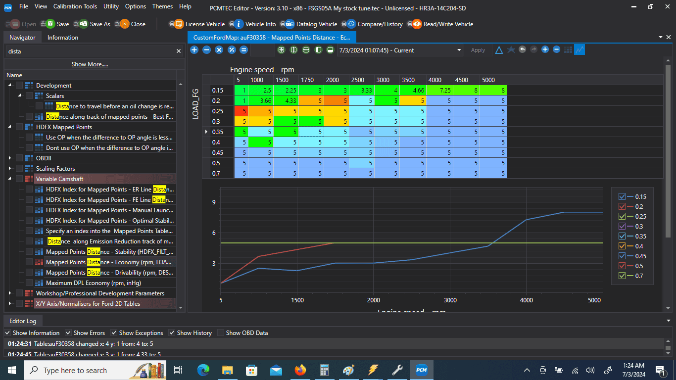

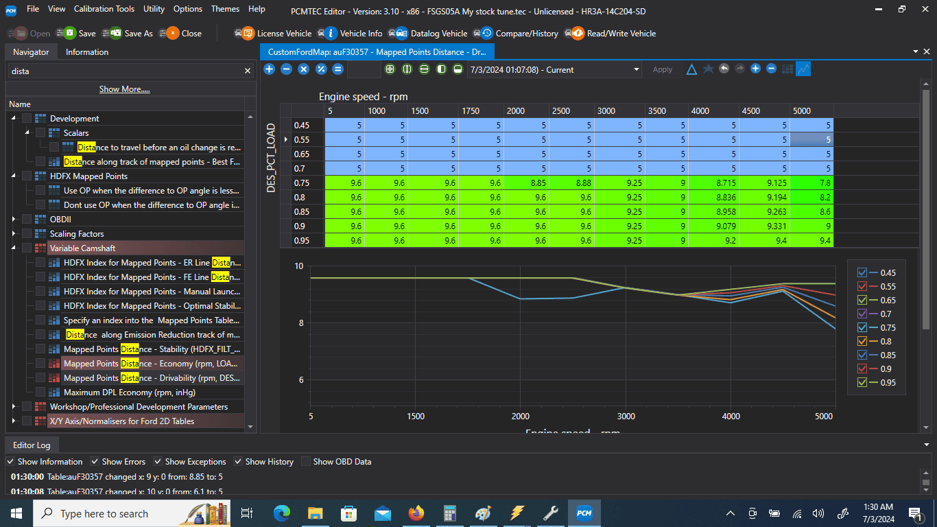

One way is to populate the distance tables with only 1 mapped point for all cells.
MP5
tdstuart
tdstuart
Apr 6, 2021
72
2,570
1,299
Arizona
Triston
2015 Mustang Gt Premium
MP5
I have the line distance table set to mapped point 5. Still isn't holding. Part of the problem is the limiting based on temp/time like I mentioned.

WHat is the line distance table
I think this is the PCMtec equivalent table
K4fxd
Apr 2, 2020
122
13,491
12,321
NKY
Dan
2017 gt, 2002 FXDWG, 2008 C6,
Might also need to change the best drivability cells below .7 to MP5

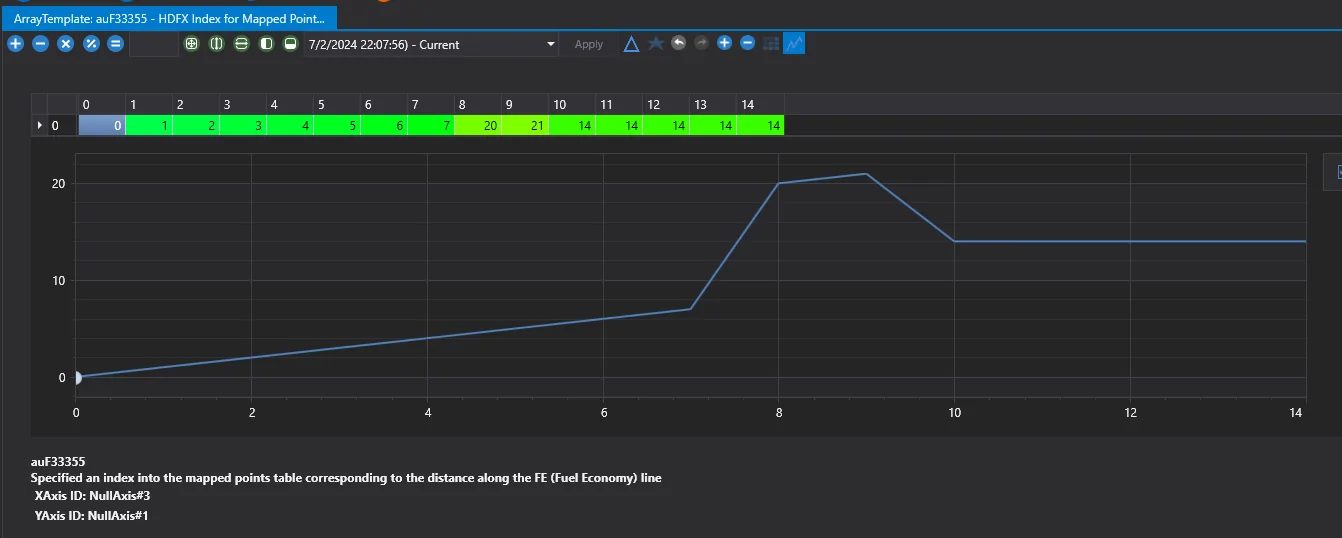

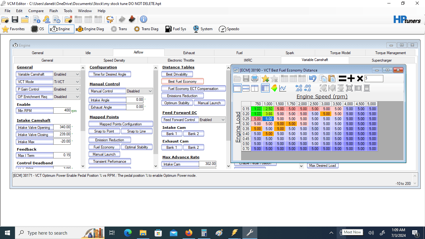

Line distance is what actually controls the mapped points right? That table number is corresponding to the distance number not the mapped point... at least that's what I thought.
here is the line distance:
The table you showed corresponds to the line distance table above and the line distance table is what actually points to a mapped point.
Someone correct me if I am wrong but from my testing when doing the ghost cam that's how it works. In this case it works out because line distance 0-7 correspond with MP0-7 but if you set the table you showed all to 8 then it would actually point to MP20.

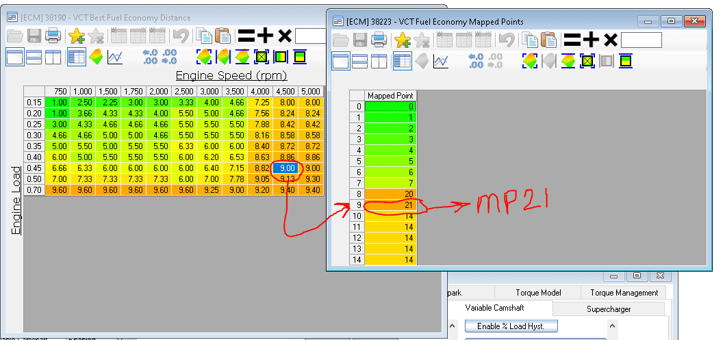

For example in hptuners:
If in fuel economy mode and at 4,500rpm with 0.45 load you would go to line distance 9. Line distance 9 for fuel economy is mapped point 21.
I don't know how the blending works with numbers like 8.82 (4000rpm, 0.45 load). Does it blend between the line distance values of 20 and 21? Idk.

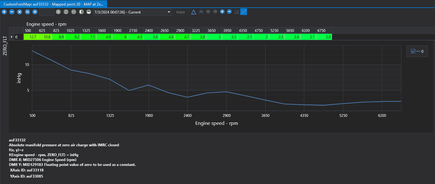

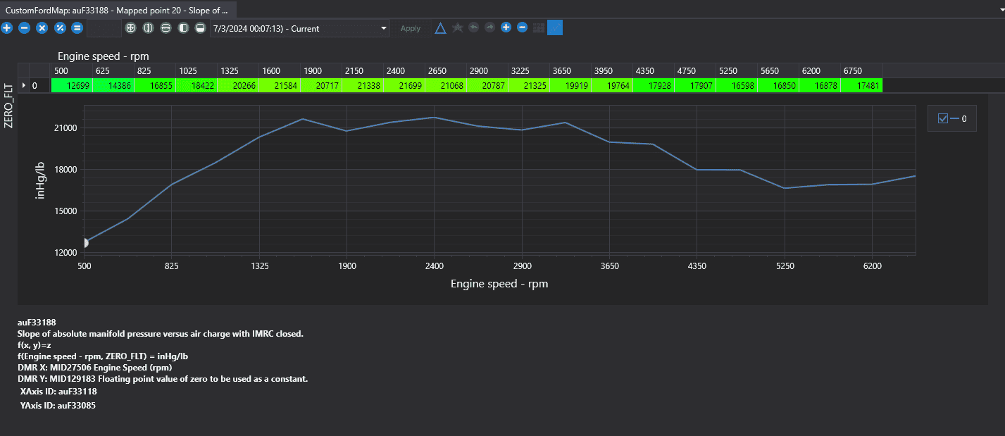

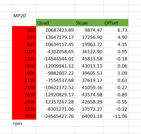

How hard is it for me to calculate myself?
Excel - MP 20 SD test.csv - Excel - 2 July 2024 (loom.com)
Heres a short 5 min video of how I am manipulating the data in excel o get the quadratic, slope, and offset of just one RPM for MP20.
Above 3500, there wasnt a lot of data points in that log.
Around 1600 RPM theres an interesting thing that happened. The filer of +/-250 RPM only returned a single airmass and single estimated MAP.

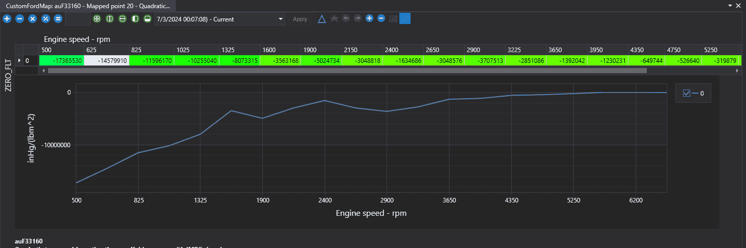

Also here are the rpm values it uses:
500
625
1025
1325
1600
1900
2900
3225
3650
3950
4750
5250
5650
6750
Should I rescale these to 8000? And for 500 would I use rpm ranges from 500-625? Or is it like 500 rpm is 0-500, 625 rpm is 500-625, etc?
