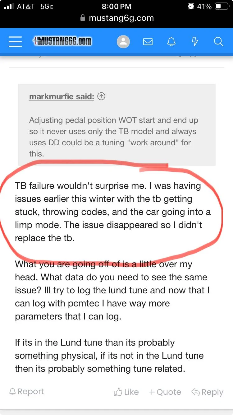

From my research, the manifold volume might influence the speed density calculations so I want to try updating that.
I think what I was getting at was if your stock throttle body and model is not agreeing with your stock MAF sensor and housing about how much Air is getting into the cylinder. You might be chasing your tail with the SD tuning.
Still think it's something with your throttle body.
You can't mention needing new parts pretty soon @GregO will demand I replace the entire car for new parts 😭
Shouldn't we be able to compare voltages from my logs to someone else with a 15-17 throttle body? The car can only see the voltage so if it was truly the throttle body we should see some weird voltage things. From what I see the car seems to be reporting that the throttle body is perfectly fine

@tdstuart I’ve tried manifold volume numbers down to 0 and up to huge numbers and never saw a load or SD issue. However, throttle response was drastically affected.
Okay Ill give it a shot anyway. Its my only thought since I know nothing about the SD stuff
The throttle angle is on a PID feedback loop and very sensitive to errors. It will throw a code very very quickly if it isn’t where the pcm thinks it should be.

@ 133,000 miles who would argue that.
Also is there any merit in a new DBW accelerator pedal, that’s a lot of cycles at this mileage ?
Too bad I can't just throw an 18+ tb in. I think my friend has one laying around.
I guess I could try borrowing my friends tb off his gt and test.

The logs don't indicate to me that anything is weird with the throttle body. Voltages hold steady, and the car thinks its fully open.
My point is that how much more do you want me to replace? First it was the maf, then the cai, then the injectors.
My car has a weird paddle shifting issue when you shift from 3-4 at high rpm. Is your first guess that its a transmission issue because the car has 133k miles? It's a tune issue because I had Lund specifically tune it out and it was a weird thing that was appearing in my stock tune file.
Its not that I don't appreciate your insight or opinions but I would like to see a little more proof that my tb is the issue before I spend money on a new one. I'll see if my friend has time this weekend to let me swap ours.
