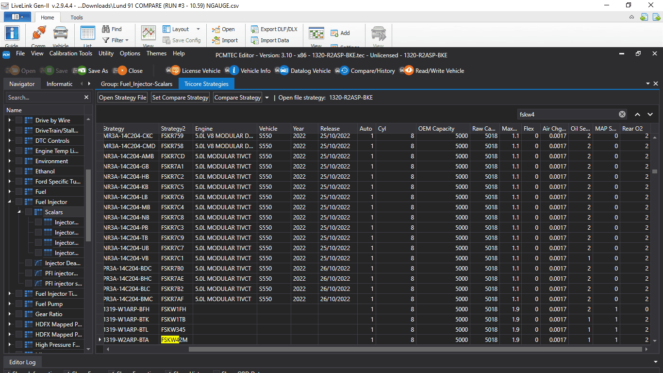

If it’s the same 47# injectors that Roush uses, pcmtec has Roush files in their built-in library.
Where do you find those files? I was just using there stock rebuild tool to look at stock mustang ones

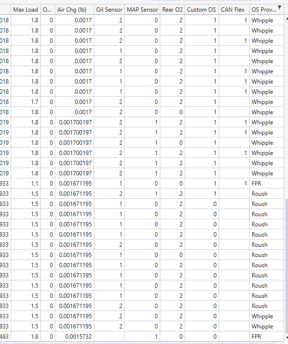

It’s at the top, in the "Calibration Tools" drop down. It's called “show tricore calibration list”. Then you can sort by year, engine, etc. if you want to find Roush, Whipple, or ford racing cals then don’t filter on anything except “os provider” on the far right.

Look for FSKW4. It is a gen 3 Roush tune but has correct LU47 injector data

How did you get OS provider? Mine stops at rear o2 sensor

Try right-clicking on the heading and hit the "show column chooser" button. If you don't see OS Provider in the list you might need to update your version of PCMTec.
