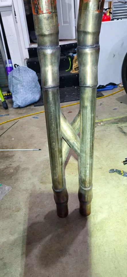

I am currently running kooks into the switch fire into the factory active system.
I like the sound and get complements all the time. It does have a bit of a bark around 2700-3000 rpm anytime the skinny pedal is more than 50%. I think this is due to the stupidly small butt connection Ford used for the factory resonator. Causes flow turbulence and sound waves to go crazy in that small 2.25” section.
That is my only dislike.
ATM I have some 3” vbands that I plan to put in to eliminate this issue into the switch fire. I have about $65 in parts and a few hours with a tig should get that fixed.
