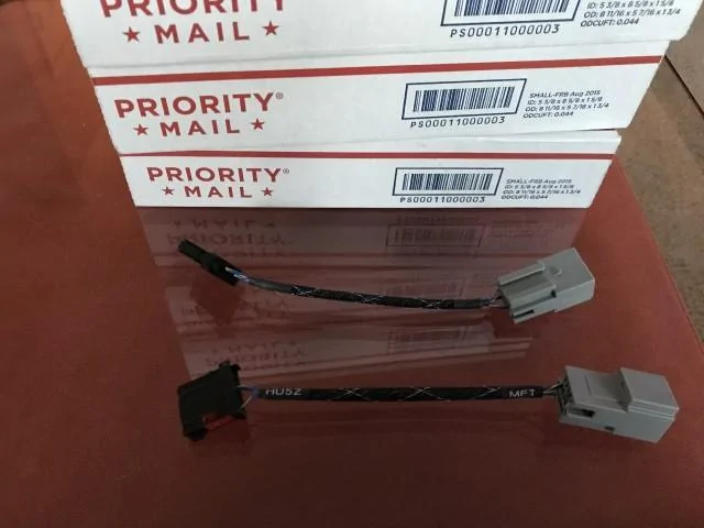

If any of you are installing Sync 3 into your 2015 and the Sync 3 unit you are installing came from a Mustang Harness By Hextall will send you a FREE HU5Z media hub adapter with the trade in of your MFT screen brackets.

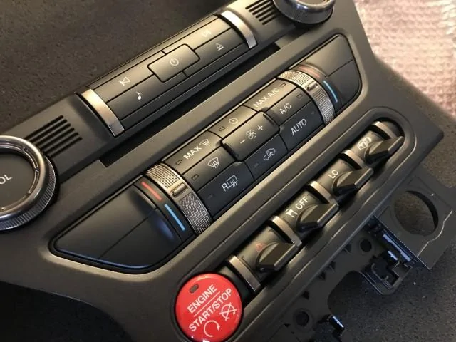

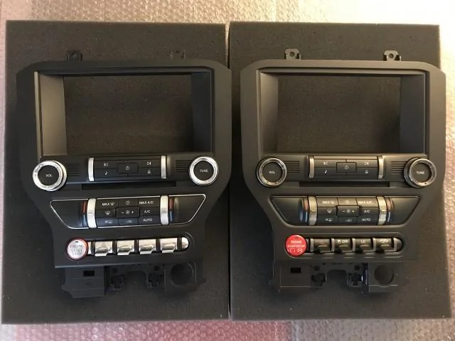

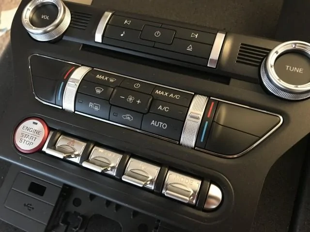

Could one upgrade the firmware on the 350 FCIM to work in a standard mustang? I want black toggles....

If you had access to it, in theory you could. You could also spend $375 on a GT350 bezel and swap the switches, and trim. But you’re still left with mislabeled switches.

Yeah, the GT350 FCIM (aka radio bezel) has it's own circuitry, it's actually a module of it's own in the Ford system just like the PCM or APIM.
Unfortunately, the functions of the toggle switches on the GT350 are different from all other S550's, so if you do a direct swap with no mods you lose functionality.
Honestly, I think the toggle switches in the regular S550's are nicer. They feel metallic (even though they're probably just chrome plated) and premium. The toggle switches in my GT350 just feel like plastic blah.
A lot of the interior differences in the GT350 are just that... different. Not necessarily nicer.
Grass is always greener, I guess.
I have already done my install with your harness. But this thread gave me so much information and saved me so much time and money I will send them to you for free. I want to do an audio upgrade with amplifiers someday so if you do the the harness for that send me the information to order and we will call it even. PM me with where to ship. Might be next weekend before I can ship them however.
