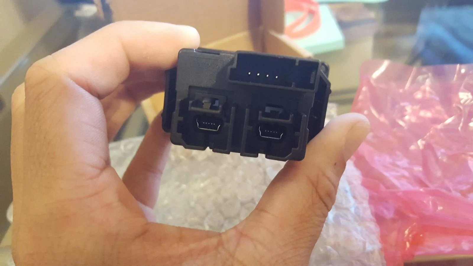

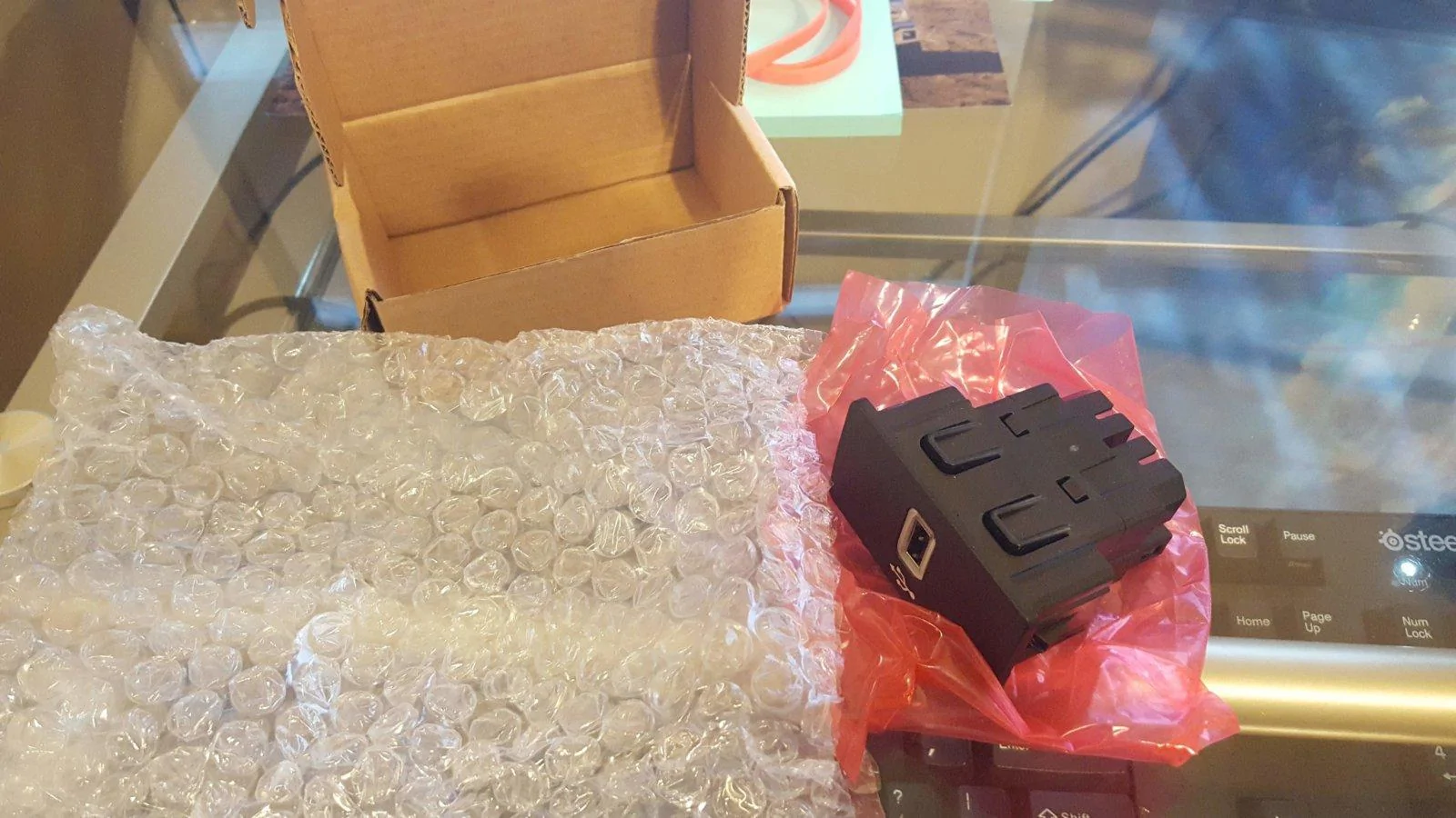

People looking to swap from base to Sync 3 or MFT to Sync 3 BE CAREFUL of eBay HU5Z hub resellers. I have had 3 people in the past two weeks purchase hubs (that were supposed to be genuine Ford) come to them in either plastic bags or brown cardboard boxes. AVOID THESE AT ALL COST. One of my FB customers bricked his APIM.

Thanks for the headsup....I think I got one too. The hub came in a box with GT brand logo, however on the hub itself there is a FoMoCo logo embossed. Good thing I didn’t get to installation.

Those I’m not sure about. They could be remans. I asked the person who’s APIM bricked to send it to me for inspection.

Do you know what seller he purchased through? I bought this one. Just opened the package and it came in a brown cardboard box with no markings. Inside the box it was was the hub wrapped in a red bag then bubble wrapped. Has the FoMoCo stamp, but your description has me worried...

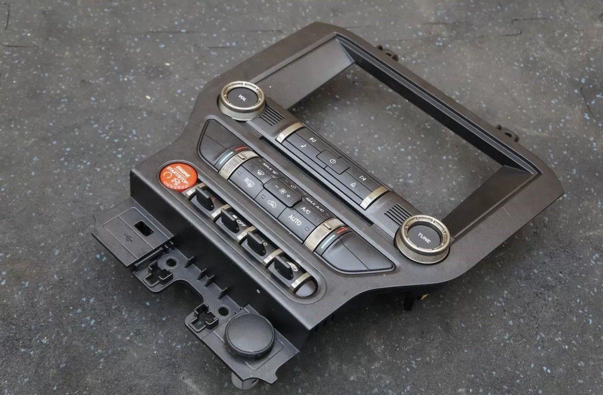

I don't know if this is the right place to post this but for anyone doing the 4" to 8" upgrade I'm selling my GT350R premium bezel. I'm also gonna sell the screen and CD player and conversion harness, so if anyone needs anything let me know. Heres a link to the bezel i have it up on eBay https://www.ebay.com/itm/232958409630
