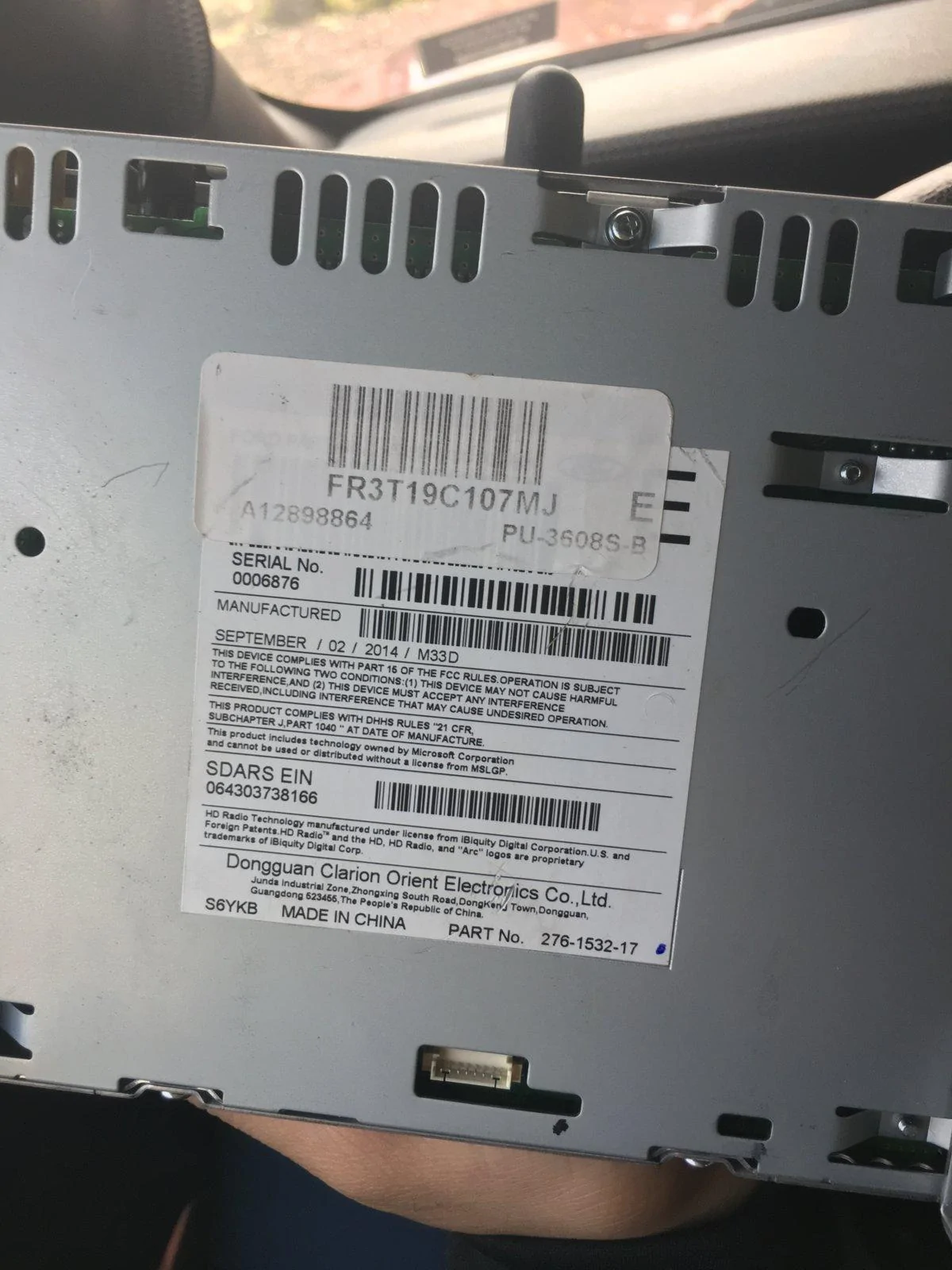

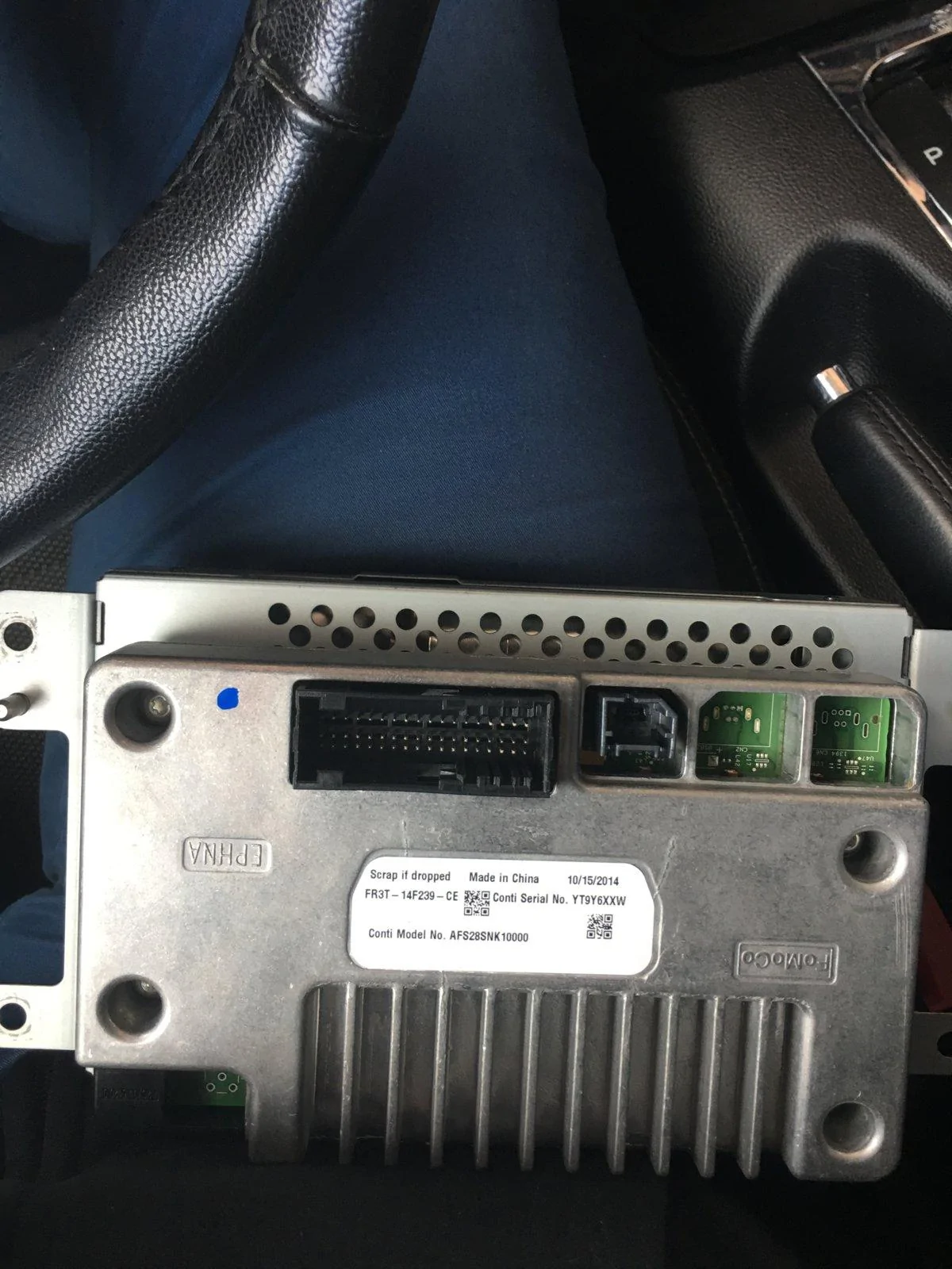

First of all, excuse my ignorance, so I bought these APIM and ACM, before relaizing how complicated the installation is. My questions:
1- the APIM I bought is MFT? Correct? That means I won’t be able to add sync 3?
2- how do I know if this one has a navigation?
3- my car is 2015 v6 base, if the one i bought has no navigation and and I won’t be able to add the Sync 3, would that make the installation easier? Which steps do I need to skip?
TIA!

Yes the apim is MFT so you cant get sync 3 you can add nav to a non nav MFT if you want will need a map card. The ACM is independent of the apim you get that if you want HD radio or Sirius or both, its complicated if you're going to make you're harness but Hextalls550 makes conversion kits for sync 3 for base cars you can talk to him and see whats up i think he makes harnesses for MFT conversions too
