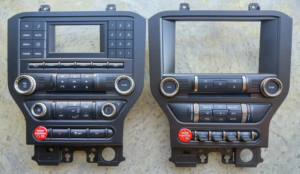

I'm confused, the 4.2" bezel in the GT350 has a LC button, as does the Sync 3 bezel.
Are you saying yours isn't working?

[MENTION=7184]Patio208[/MENTION] What bezel do you have? I thought there was only one for the Tech pack cars.
[MENTION=13588]Blade007[/MENTION] I’m starting g to think there are differences in the EB and V8 FCIM as built data. Two different EN wo t clear the HVAC related codes but all of the V8 cars I e helped with did. I don’t have an EB customer locally. It may be awhile before that can be figured out.
I have the bezel from a Shelby with the electronics package (no heated and cooled seats) same as Spart posted.
You are correct. Yes the LC toggle has no function. I am still able to access it through the steering wheel controls.
This is bizarre to me. I would imagine that both bezels send the same CAN signal. Does the LC button work if you plug in the old bezel?
Also, have you looked at flashing your FCIM as-built to a same model year car's with the tech pack? The FCIM = radio/HVAC bezel FWIW, it is it's own module.
Okay, sitting in car now downloading Sync update 3.0. Hit the LC toggle for shits and giggles. I now show the LC icon on my display but it does not open the app itself. Honestly never used it with the button before the Sync 3 upgrade. Is that propper function of the button/toggle? As far as flash goes I tried the tech track and R codes. This is as close as I've been to having it work.
I see now thats how it works from the toggle. I was expecting to be promoted to select RPM before launch. Apparently that only happens when using steering wheel controls. How i deleted it in the first place is a mystery. I went back and flashed to original data then carefully re-entered my changes. Was too frustrated to catch my mistake but obviously I made one somewhere. Thanks to those who tried to help and offered advice.
