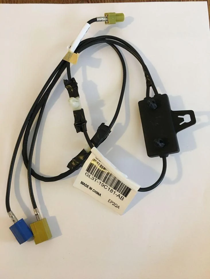

How much is that splitter? There isnt one specific for the Mustang AFAIK otherwise HextallS550 would have used that instead of a aftermarket one. The GPS antenna is cheap and mounts right where the factory one is under the center dash panel so I dont really see the need TBH.I came across a YouTube Video the other day where a guy was showing a conversion he was doing on a F-350. He went from the old school simple Radio/CD to a Sync 1 with nav.

Now what caught my attention was how he provided the GPS signal to the new headunit.
He had some kind of splitter wiring available. It plugged into the single cable coming from the SIRIUS antenna and had SIRIUS (curry colored) and GPS (pink) connector on the other side.
He did not need any additional GPS antenna!

He used a very similar splitter to wire in his new fin shark antenna. That one had the blue fakra connector attached to it which is the one that plugs into the back of the sync3 APIM. However in his Fusion the splitter used a dual input from the antenna (see pic #6 in his post).
So I went on and found that on the Ford F-150 they use this splitter:
Now my question is:
If that splitter is able to get Sirius AND GPS Signals out of a present Sirius antenna, would it be possible to use that darn thing on my 2015 Mustang to get GPS to my SYNC3 which I'm about to put in?
What would be the right part # for our cars?
What do you think?
I’ve found one on ford parts which is around 17$, but I’m not sure it’s the right part. You’re right, the gps antenna is cheap but if I can do it oem style for nearly the same price id prefer that. The second advantage which Dan already showed in his post is the improvement in gps reception by using the roof mounted antennaHow much is that splitter? There isnt one specific for the Mustang AFAIK otherwise HextallS550 would have used that instead of a aftermarket one. The GPS antenna is cheap and mounts right where the factory one is under the center dash panel so I dont really see the need TBH.
The Mustang GPS antenna is in the dash, the only ones that have the roof antenna are the cars with Sirius/XM from the factory and I'm pretty sure they still have the factory GPS antenna separate. [MENTION=28081]HextallS550[/MENTION] could probably chime in and confirm.I’ve found one on ford parts which is around 17$, but I’m not sure it’s the right part. You’re right, the gps antenna is cheap but if I can do it oem style for nearly the same price id prefer that. The second advantage which Dan already showed in his post is the improvement in gps reception by using the roof mounted antenna
