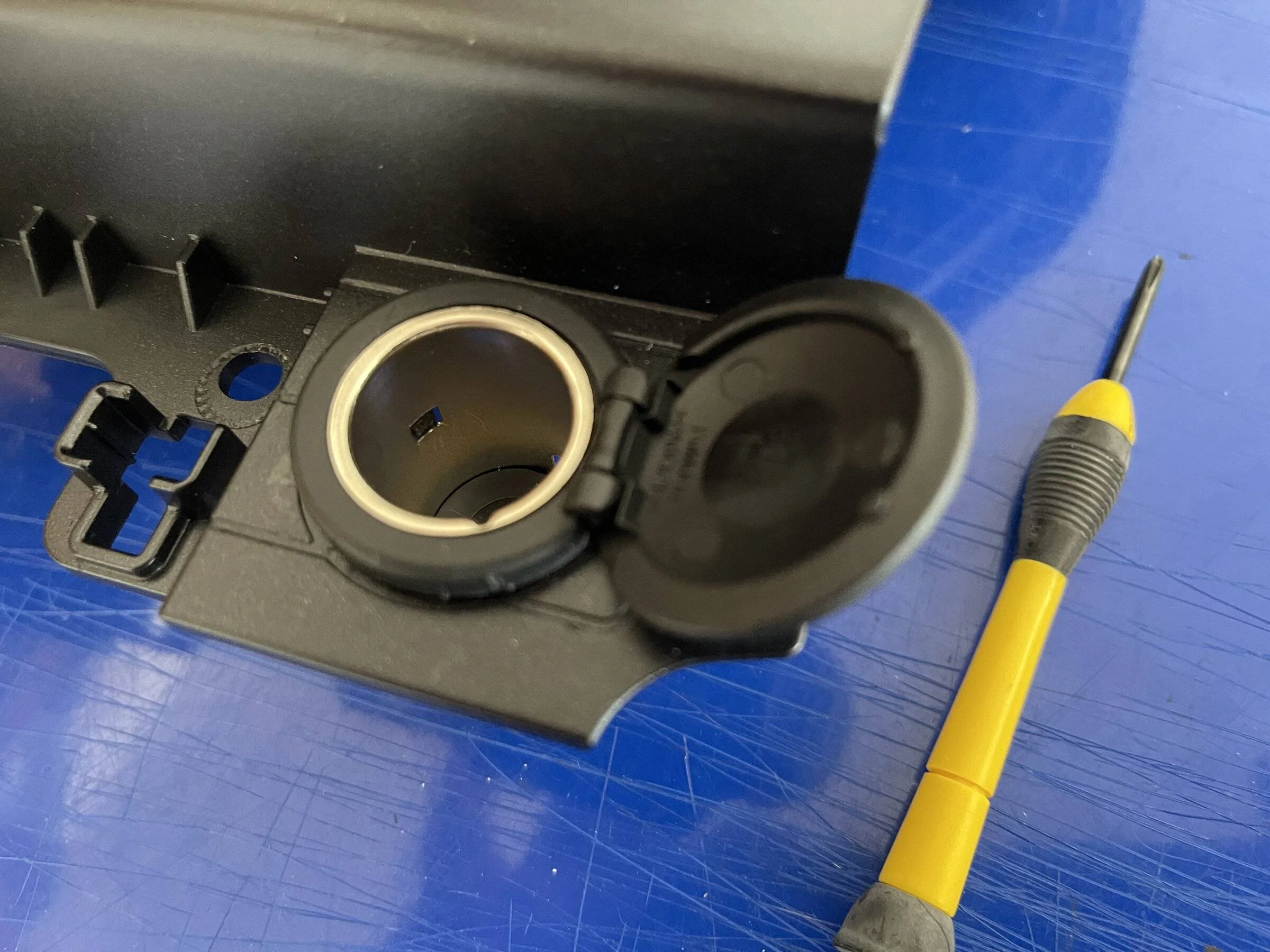

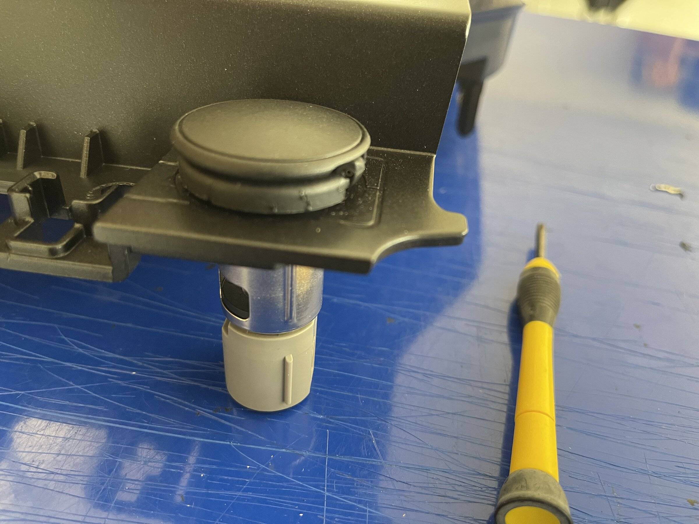

Installed my Hextall hardware today! Initially, buttons on FCIM didn’t work - push those connectors all the way in! waiting on my programming, and all will be final, but this makes the car so much better….absolutely worth it!
one thing - I’ll have to buy a new cigarette lighter outlet and cover, the stock one got all loose inside the old bezel, but would NOT release.

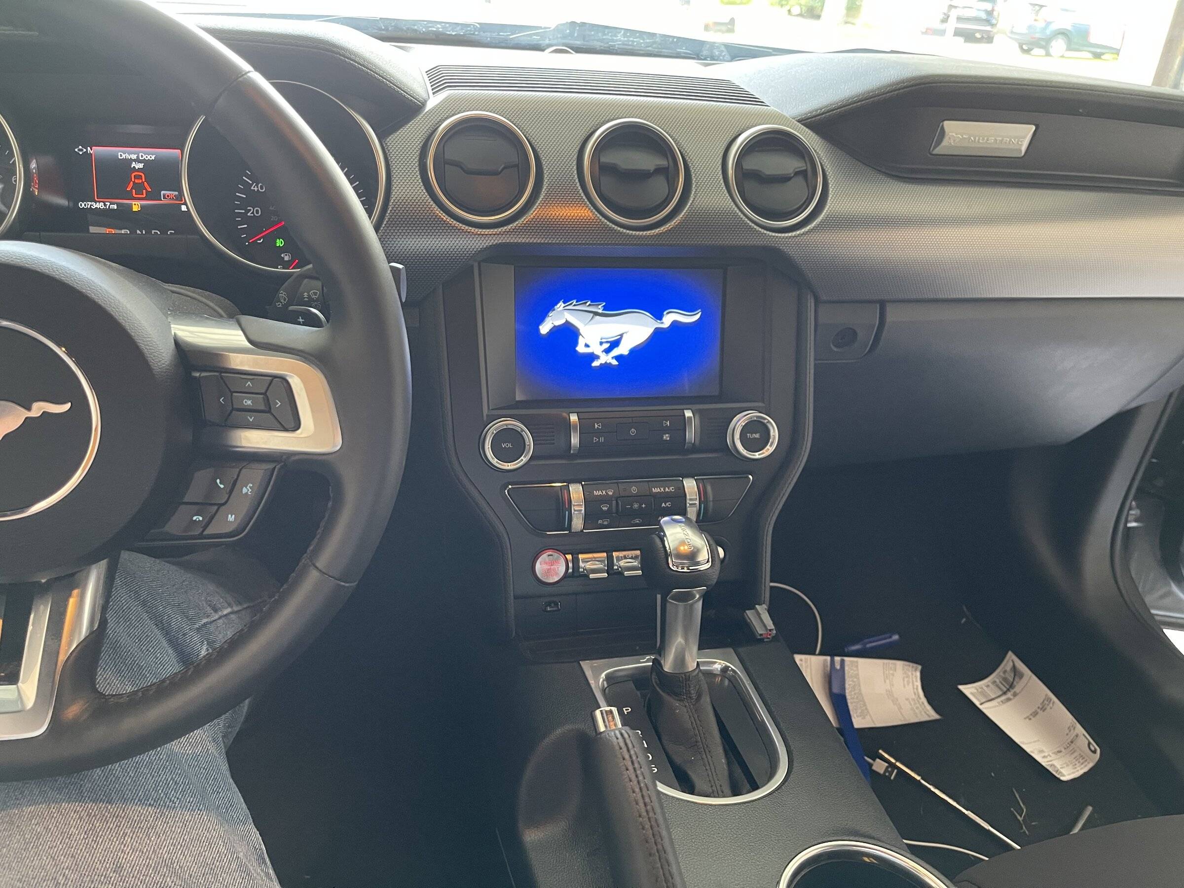

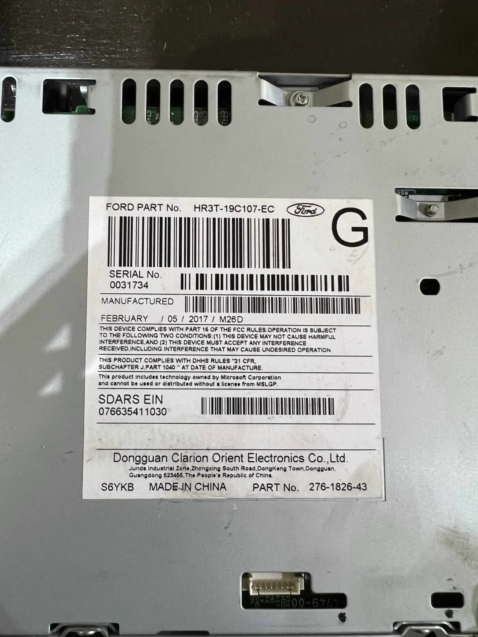

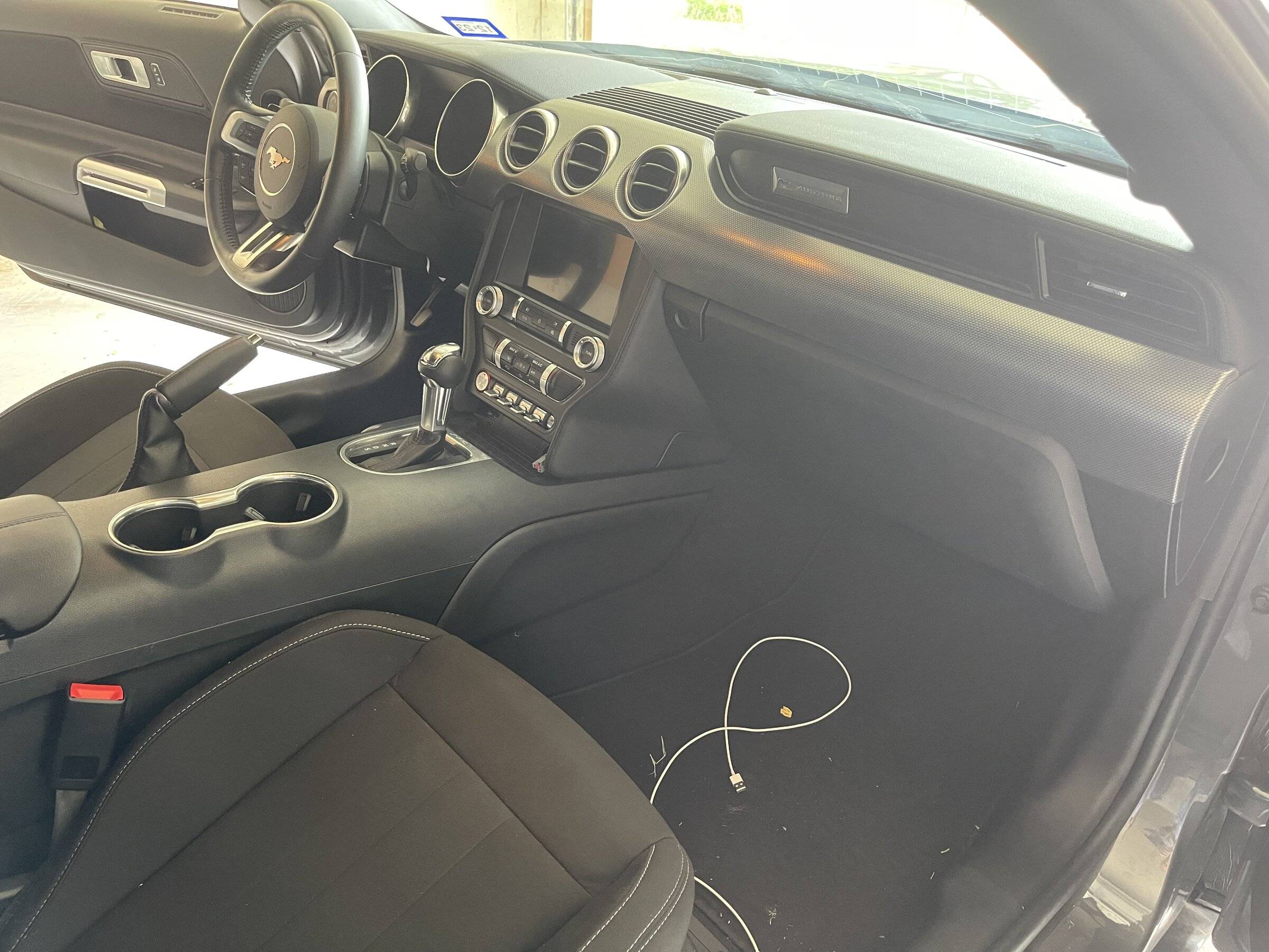

Is anyone able to help me figure out what options this has? SAT Radio HD Radio? Nav?
I bought this in a rush since the price was good- guess I could have done for research.
