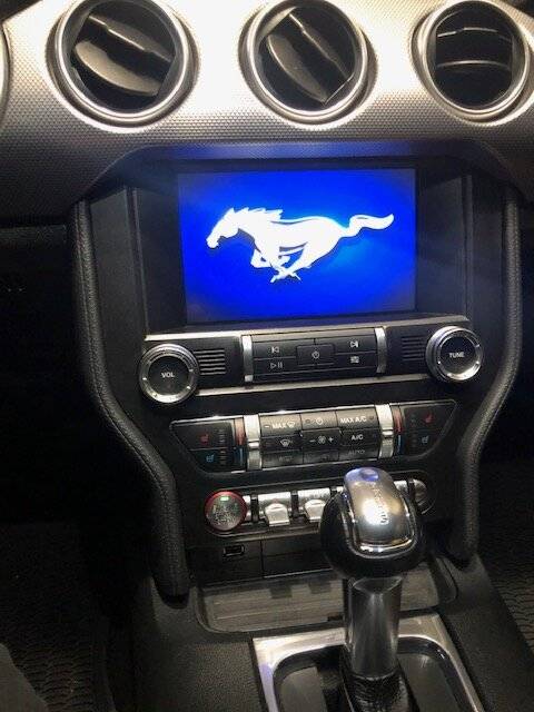

I placed my order with Hextall the other day.Hi Brian, I recently just did my install (2015 V6 as well) and the APIM you receive is pre-programmed and ready to go. Everything, as far as the infotainment system, will work fine out of the box. The changes that need to be made to the car's programming are (I think) to activate the different drive modes, etc. You need Forscan on your laptop and the OBD link for your car; Hextall will remote into your laptop and make the necessary changes via Forscan, then you will be all set. Hope that helps put your mind at ease.

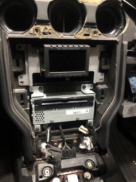

I`m newbie on this forum, and Mustang v6 2016 cabrio version I own just one summer. I`m happy with this car , but try to do some upgrades. Include swap 4" screen to 8".
I bought 8" screen and bazel from Mustang v8, and would like to swap it to mine.
Is it possible? Can anybody give advice, what kind of cables and adapters I need to buy ?

Yup, base 4" in 2015 V6, Forscan stuff went off without a hitch (Tom remotes in and makes the changes for you). Drive modes are enabled, even in my V6 . With mine, I didn't have zones for heating/cooling and the changes don't enable that, otherwise, a HUGE improvement. Car Play is the main reason I wanted upgrade and it's great!!Nice!
