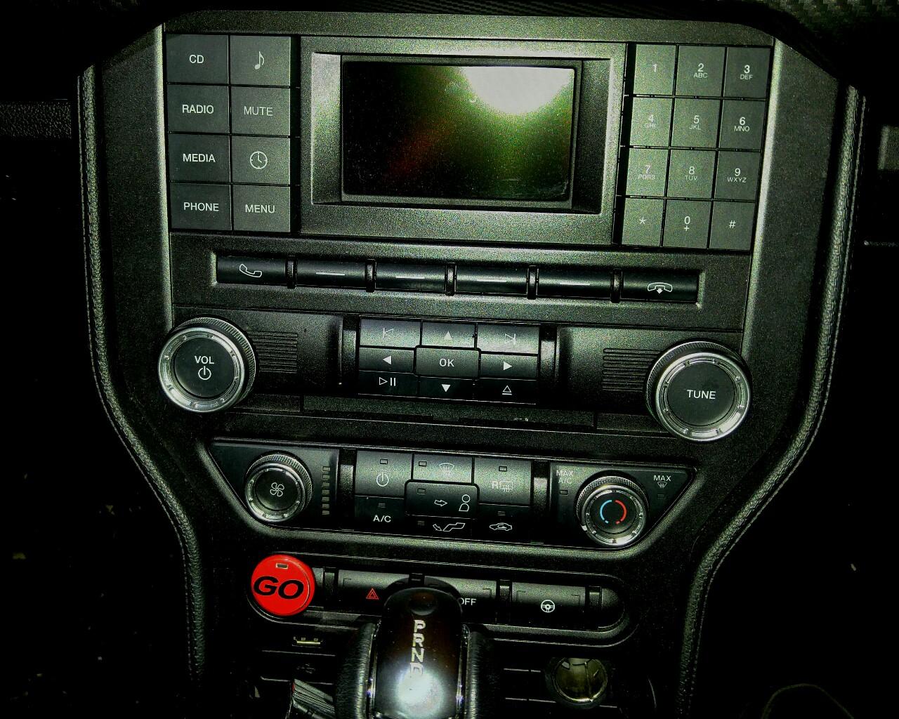

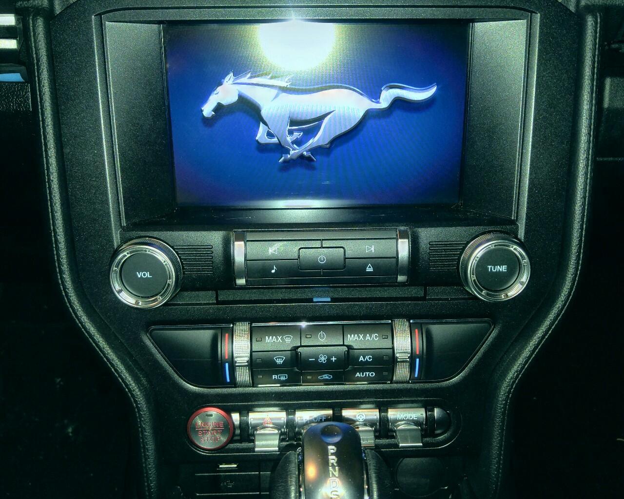

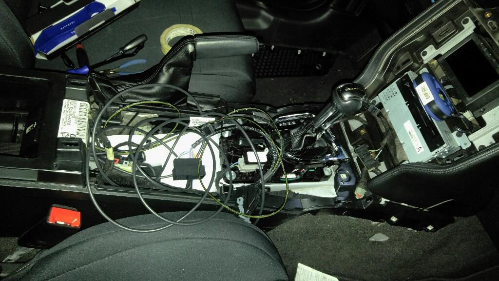

I completed my Sync 3 swap last night. I am a novice at this sort of installation so if I can do it almost anyone can. :) It took me longer than most, primarily because I was being overly cautious about prying out dash and console pieces and I had a hard time getting some connectors off. Finally, I watched the installation video from infotainment.com, which helped on those connectors. :blush: The video also helped with routing the 3 cables from the dash to the media hub.
The wiring harness from Thomas is great and the flashing he did of the APIM and FCIM made it truly plug and play. Love the upgrade.
