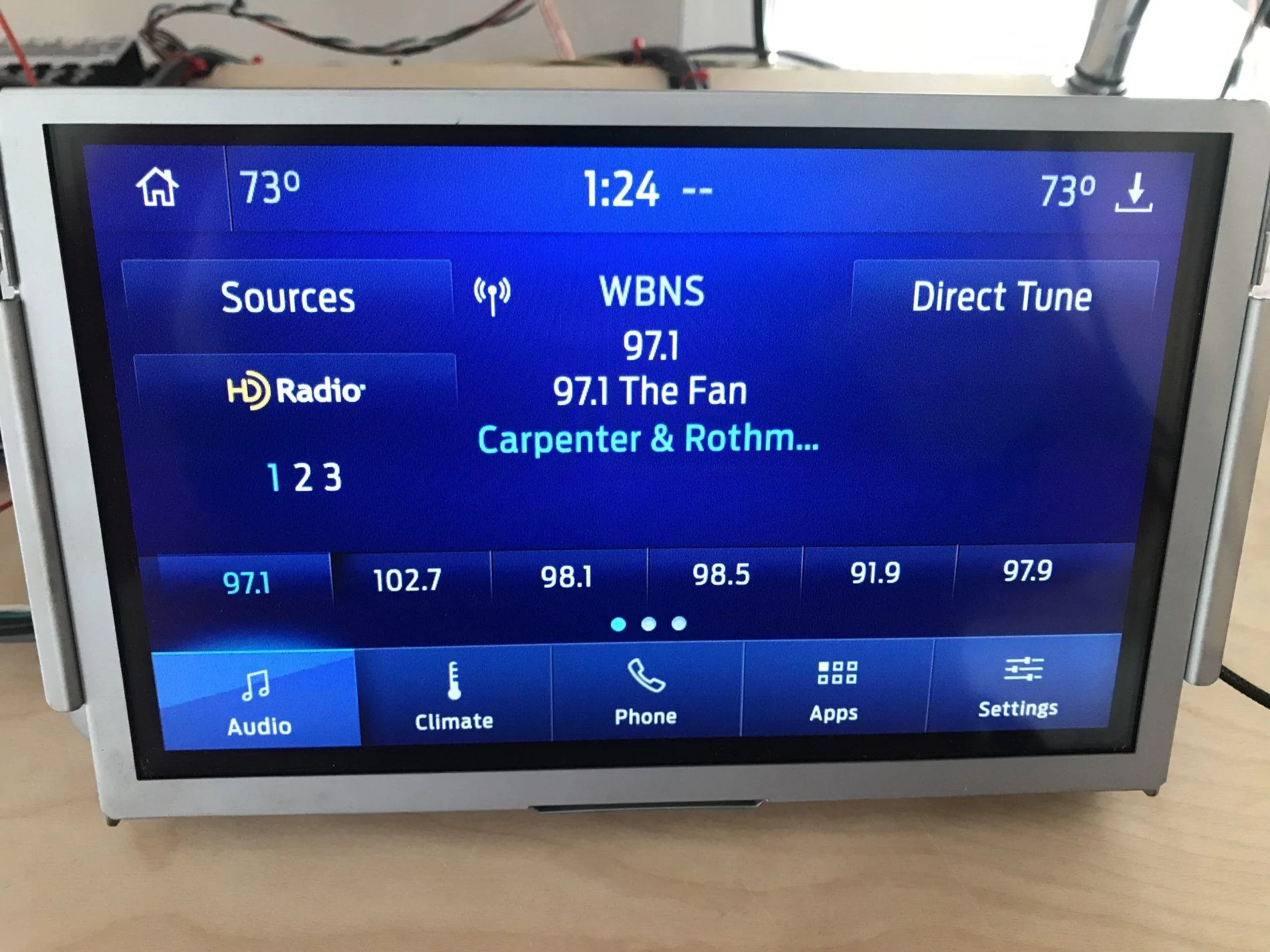

Late last night my software engineer was able to find the correct order and made a modification of the v3.3 files to enable us to flash a Sync 3 calibration into a 2019 4” APIM.
We started with v3.3 and then thanks to a copy of v3.4 shared by Sam Reeves we were able to get this:
