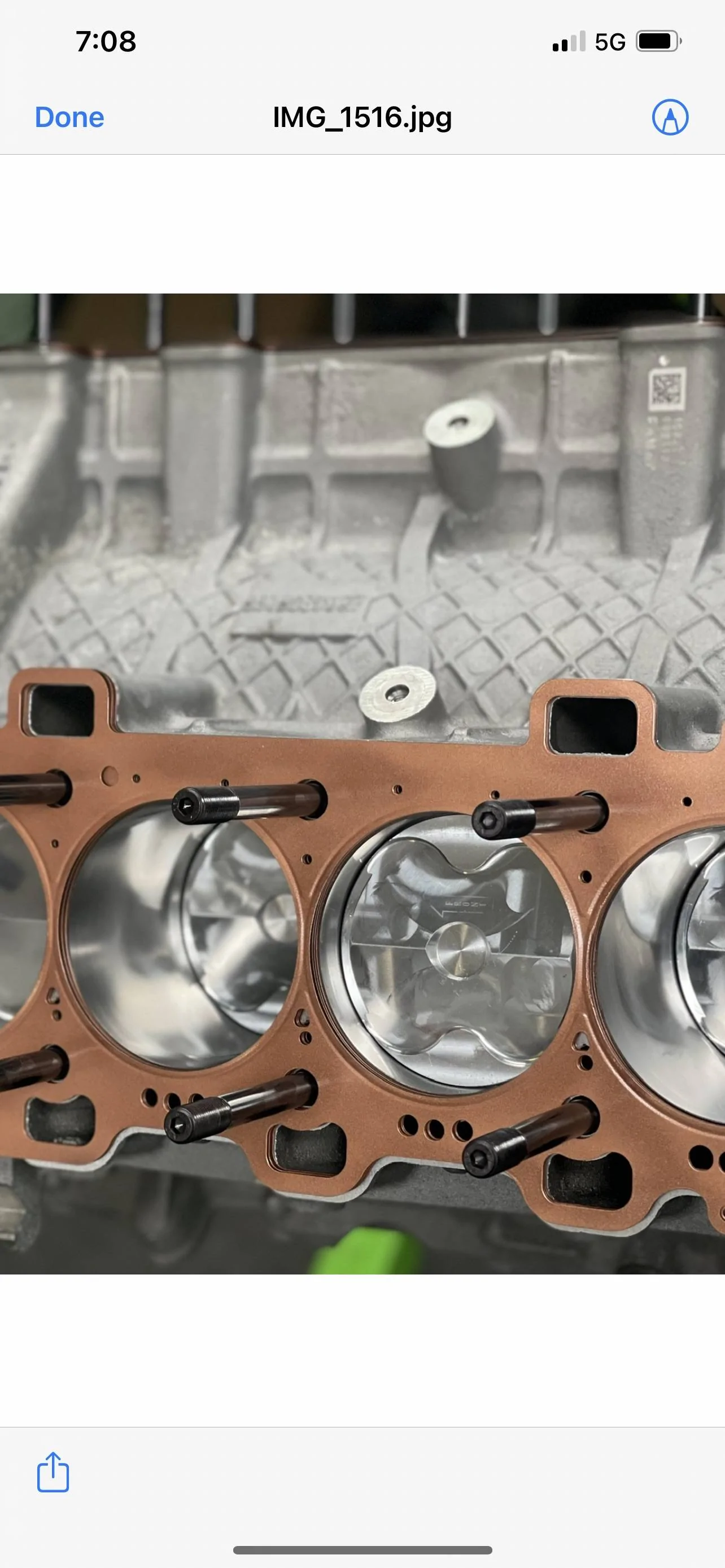

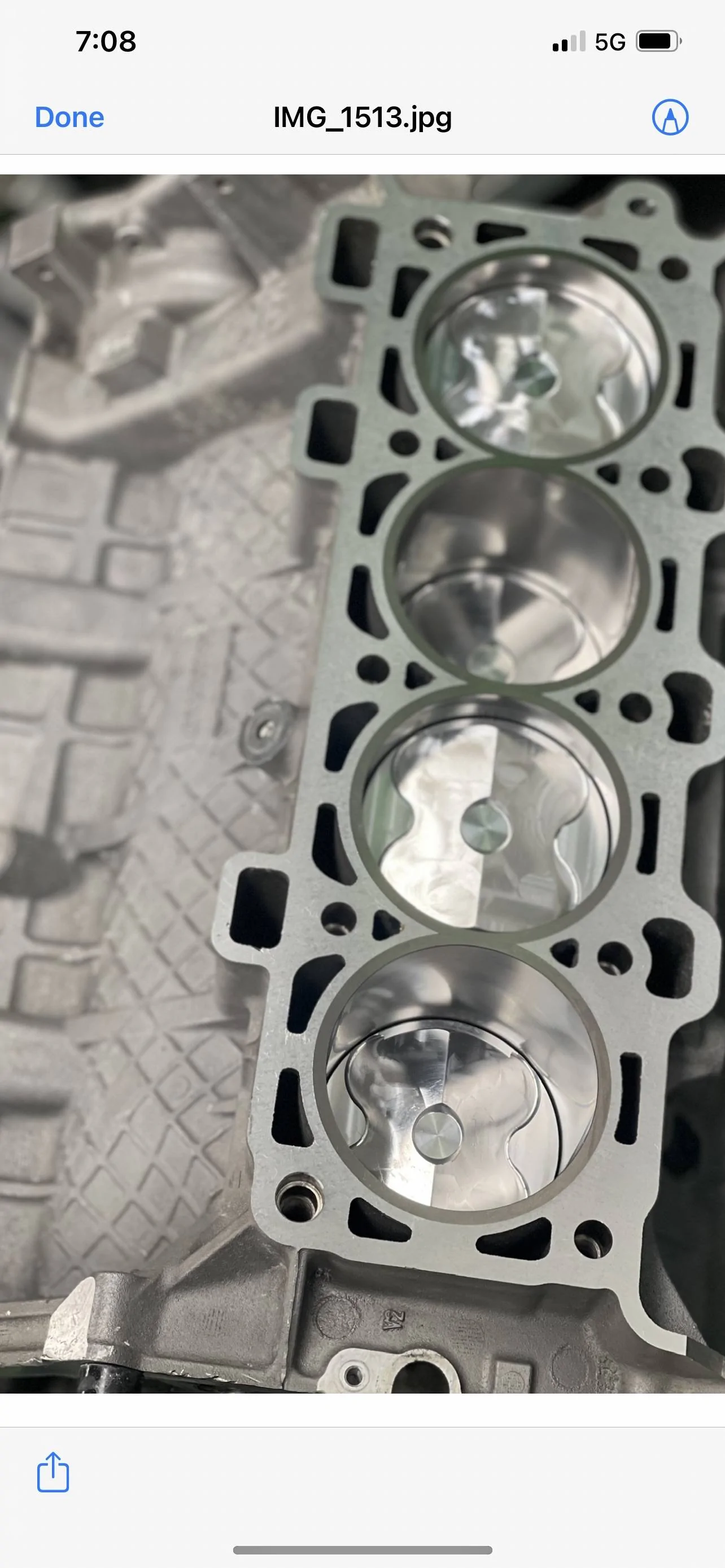

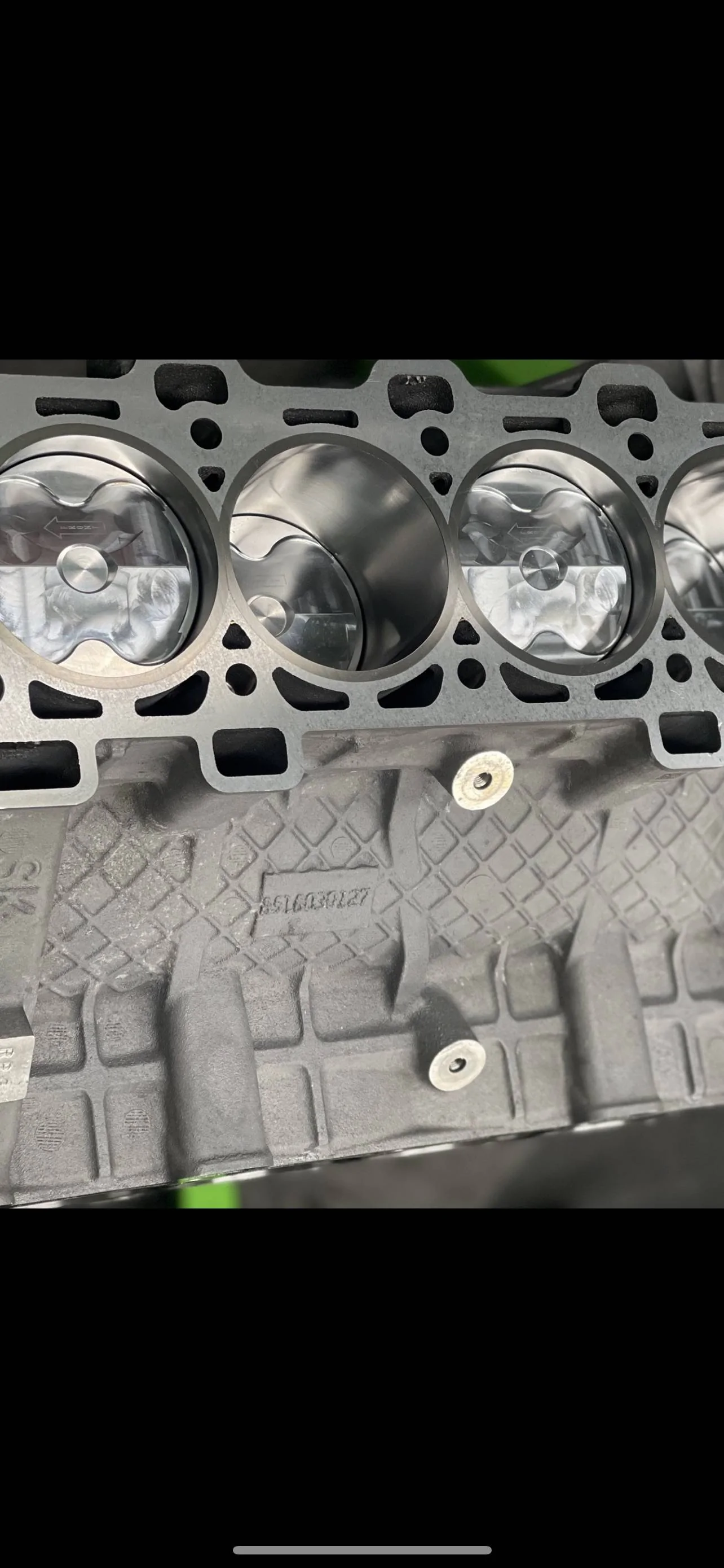

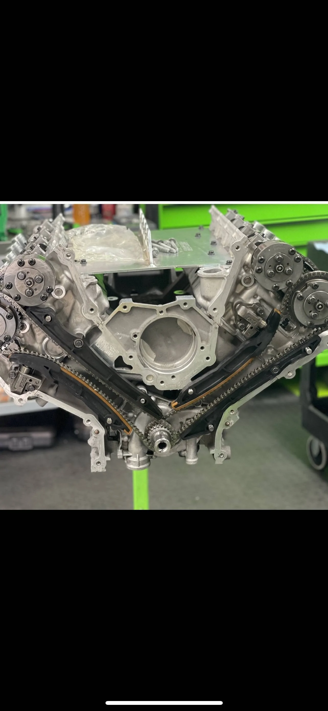

Will Rollins is one of my buddies but he didn’t build my current motor. Lund stated on the log that everything was perfectly fine, I had no issues once I did a WOT pull that the car was acting strange. I came to a light and noticed she was making noise as if I broke the header again. Once I stopped at the builder shop I showed him the log and he confirmed everything looked great. I read for any codes and noticed intermittent lost of signal at the crankshaft position sensor and misfiring in cylinder 6. We ran a compression test and noticed the loss in cylinder 6. We ran a bore scope down in the cylinder noticing slight burning in the edge of the piston. Valves look great so I’m happy with that.
Below is my current build list:
Gen 3 2.9 Whipple Supercharger
132mm Whipple TB
123mm Whipple Intake
Darton Racing Sleeves
2020 GT500 Predator Block
Flat Plane Crank
Manley Extreme I Beam Rods
Manley Extreme 12:1 Pistons
King Racing Bearings
ARP Head Studs
ARP Main Studs
ARP Side Studs
Ferrea Valves-Stock Size
PAC Valve Springs-Stock Size
Mishimoto Radiator
170 Degree Riesche Thermostat
ATI Damper-Stock Diameter
Boundary Oil Pump Gears
Boundary Crank Gear Sprocket
MMR Timing Chain Guides
MMR Secondary and Primary Tensioners
Stainless Works Longtube Headers
OEM GT500 Catback
MBRP X Pipe
Fore Double Pump Fuel System (TI Automotive F90000267 Fuel Pumps)
Injector Dynamics ID1050X
UPR Breather Catch Can
Active Exhaust Valve Deletes
Ford Performance 200amp Alternator
Brisk Spark Plugs RR12S (Gapped .028)
