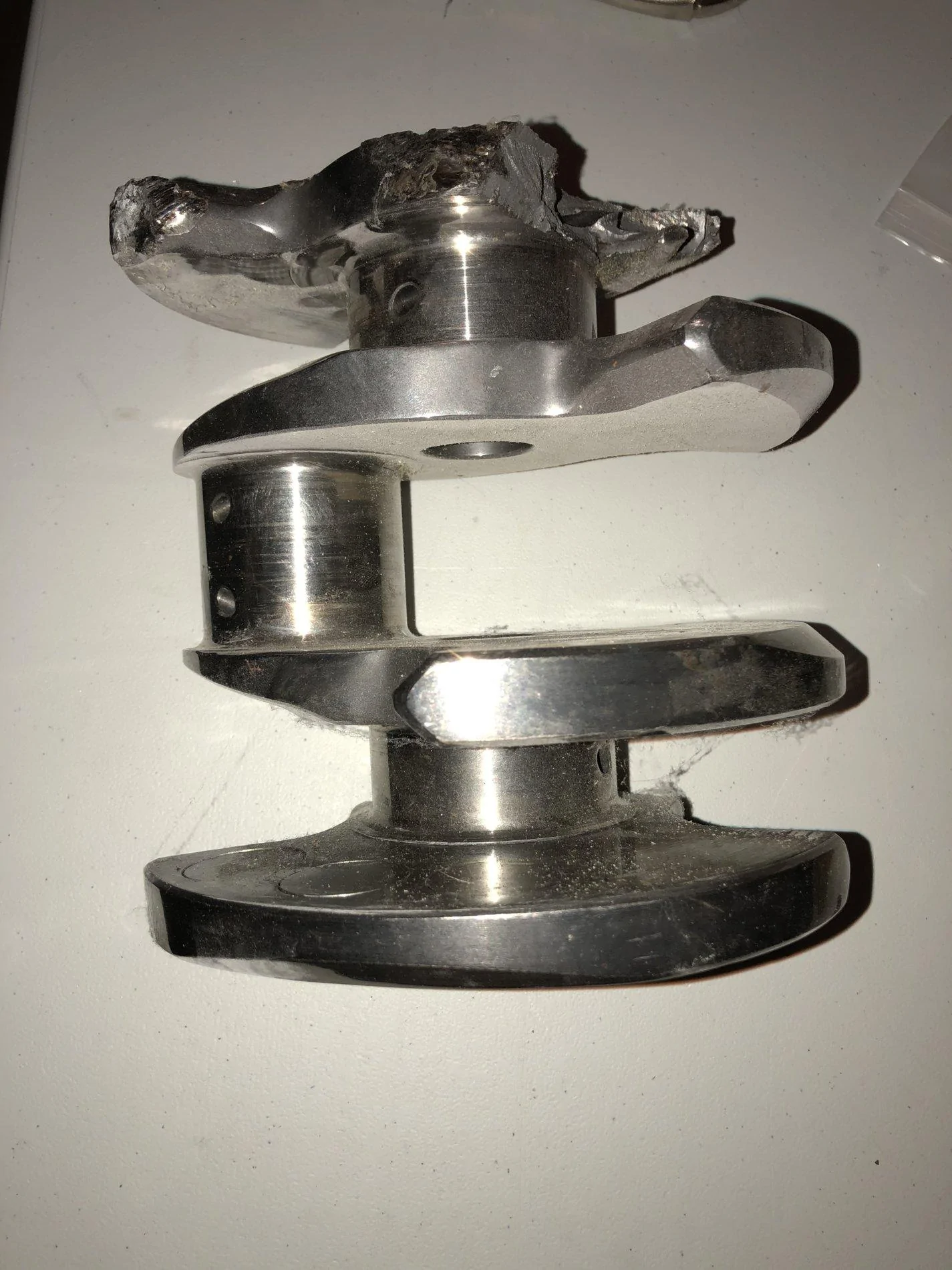

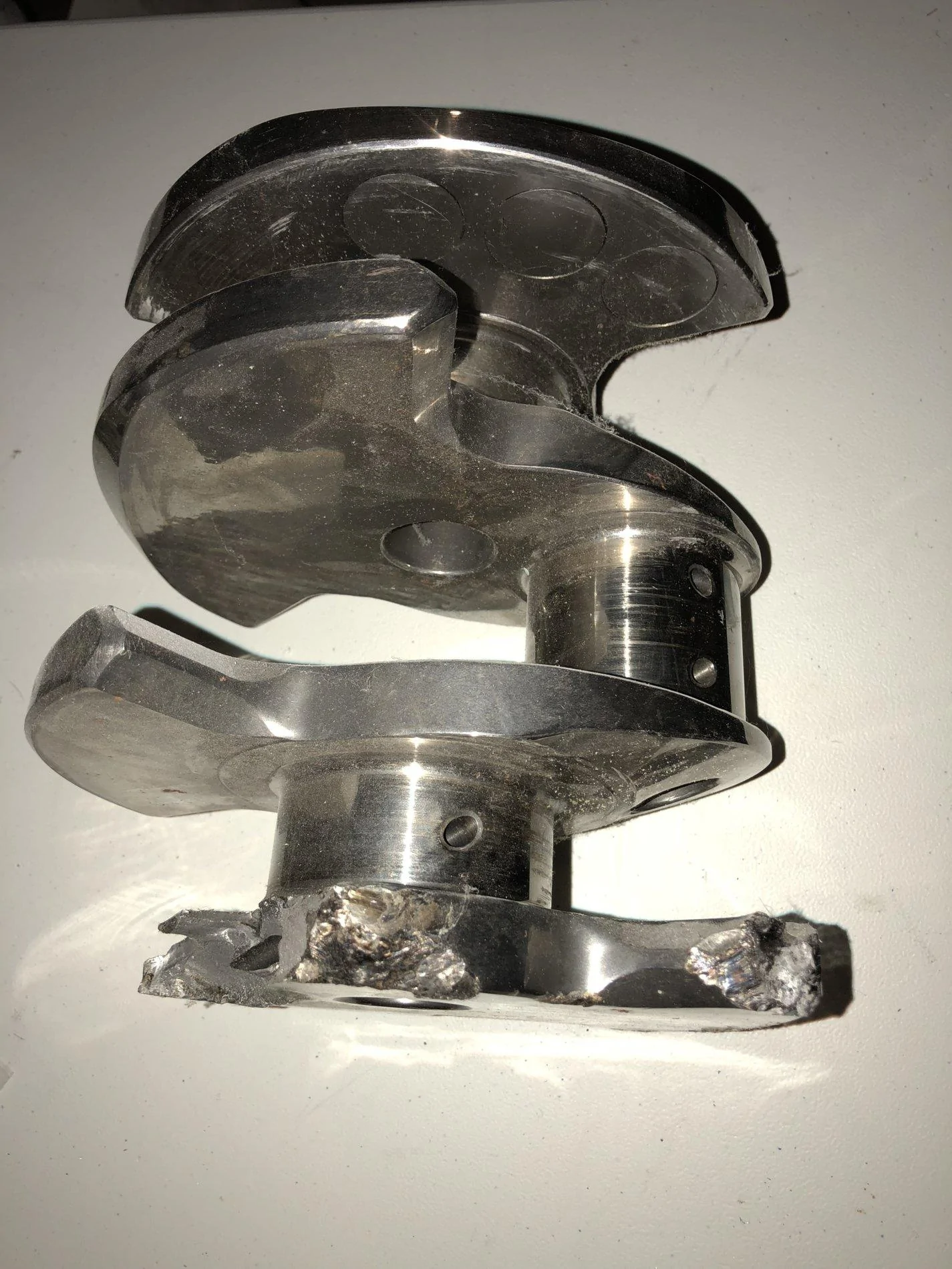

I spoke to a vendor today about boosting the GT350 and received an interesting response. Not only did he advise against adding any type of power adder he stated that "there have been many broken cranks out there with stock power and just bolt ons tuned"
I have not heard of a single case of this and wanted to see if anyone has.
In fact, in all my days I have never seen a broken crank shaft. I have seen plenty of spun bearings, broken or bent rods, blown head gaskets etc, toasted pistons but never a crank failure.
Thanks

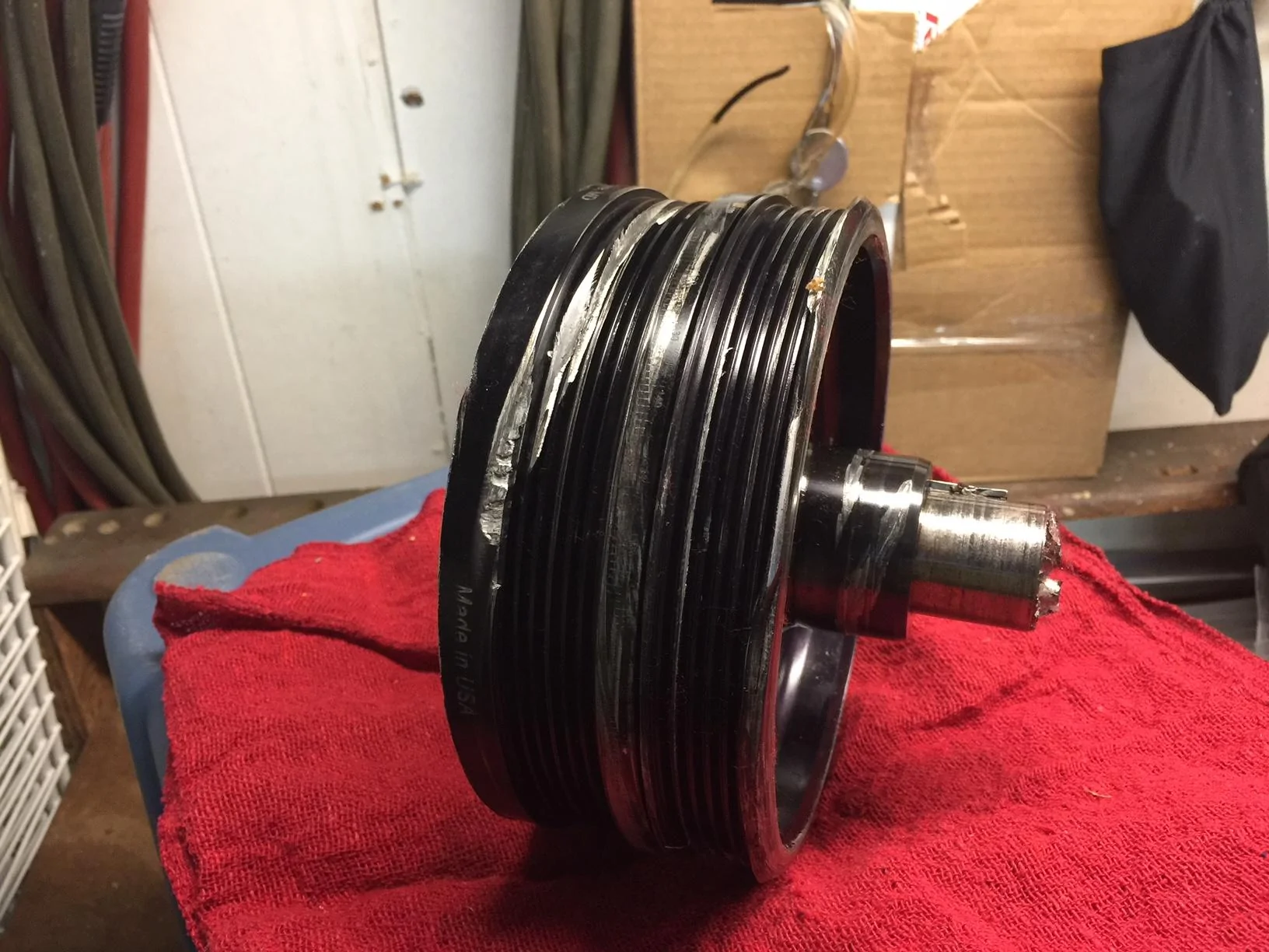

2016 gt350 -P-1 procharger just broke the crank pully off yesterday as a matter of fact
Pully came off with part of the crank still connected
