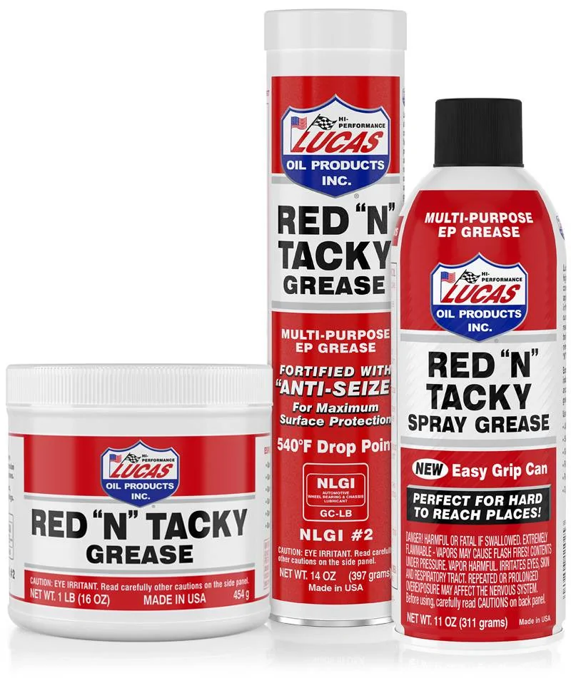

I like that Lucas grease for general purpose everything, but I can see how graphite or MDS spray would be good on an ARB bushing.
