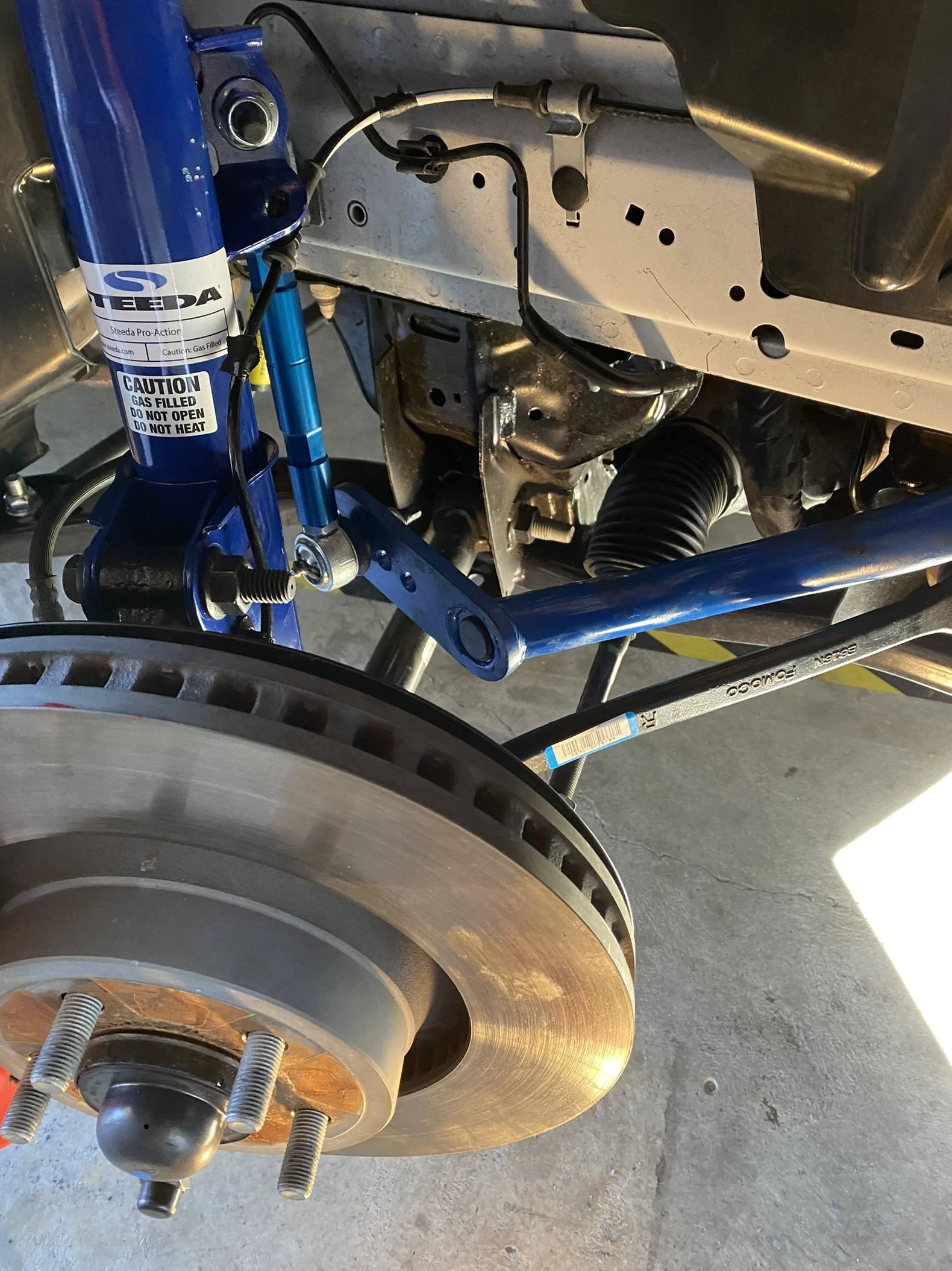

I don't know what the answer is, but I can tell you the sway bar is installed the correct way. Here's a picture of mine, I have no noises

Thanks so much for validating that things look correct, that’s one thing checked off! Appreciate your insights!

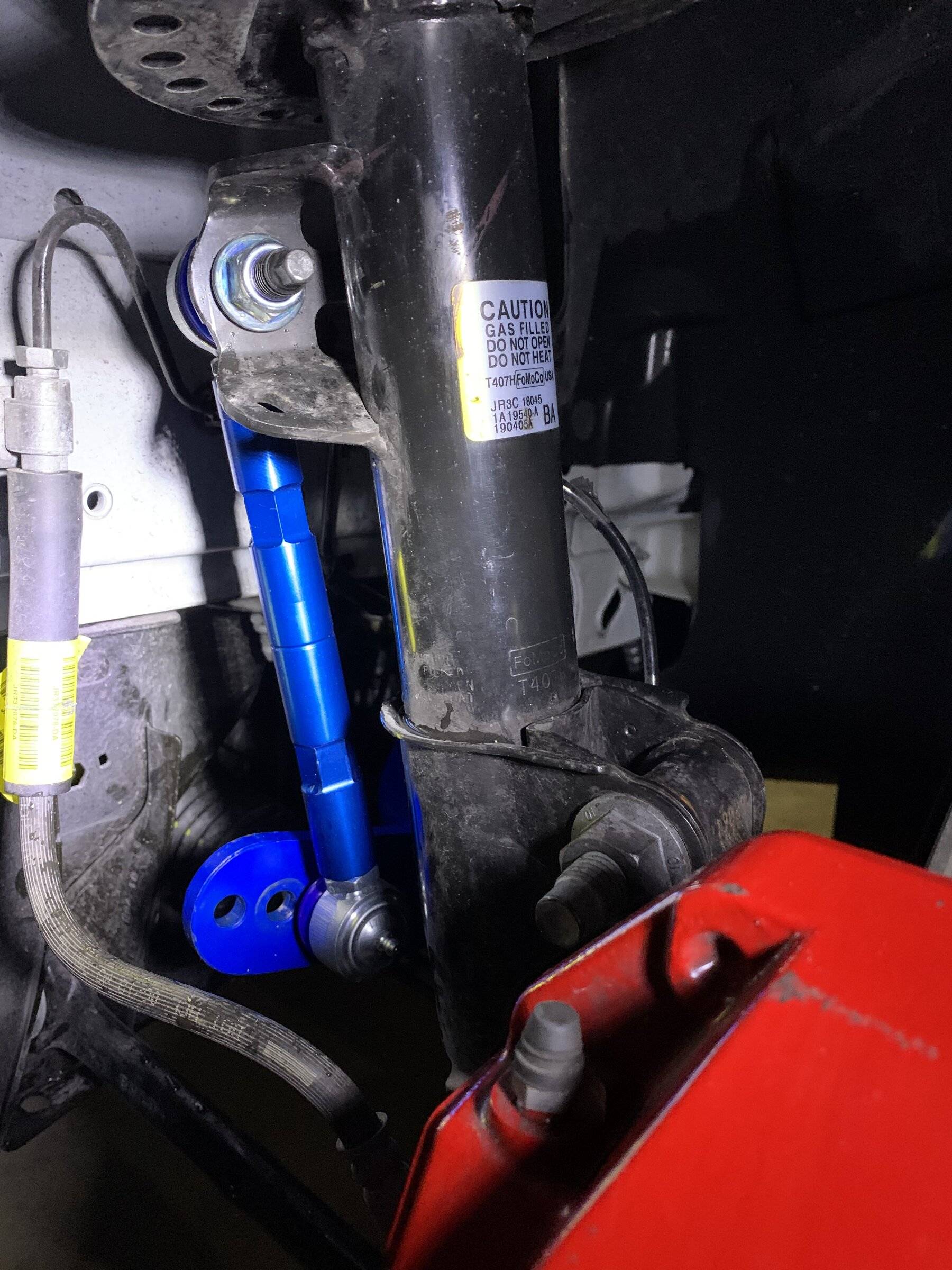

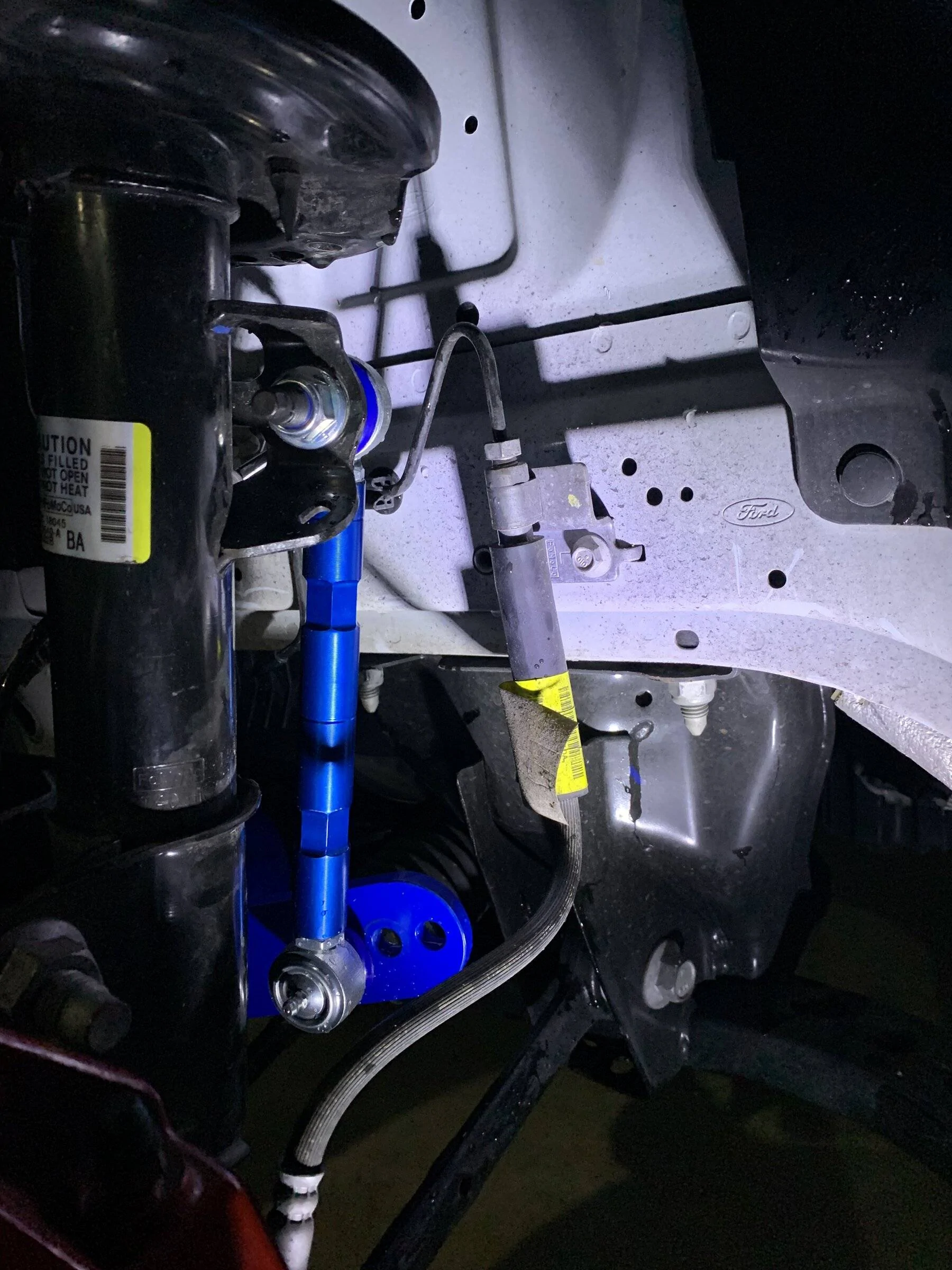

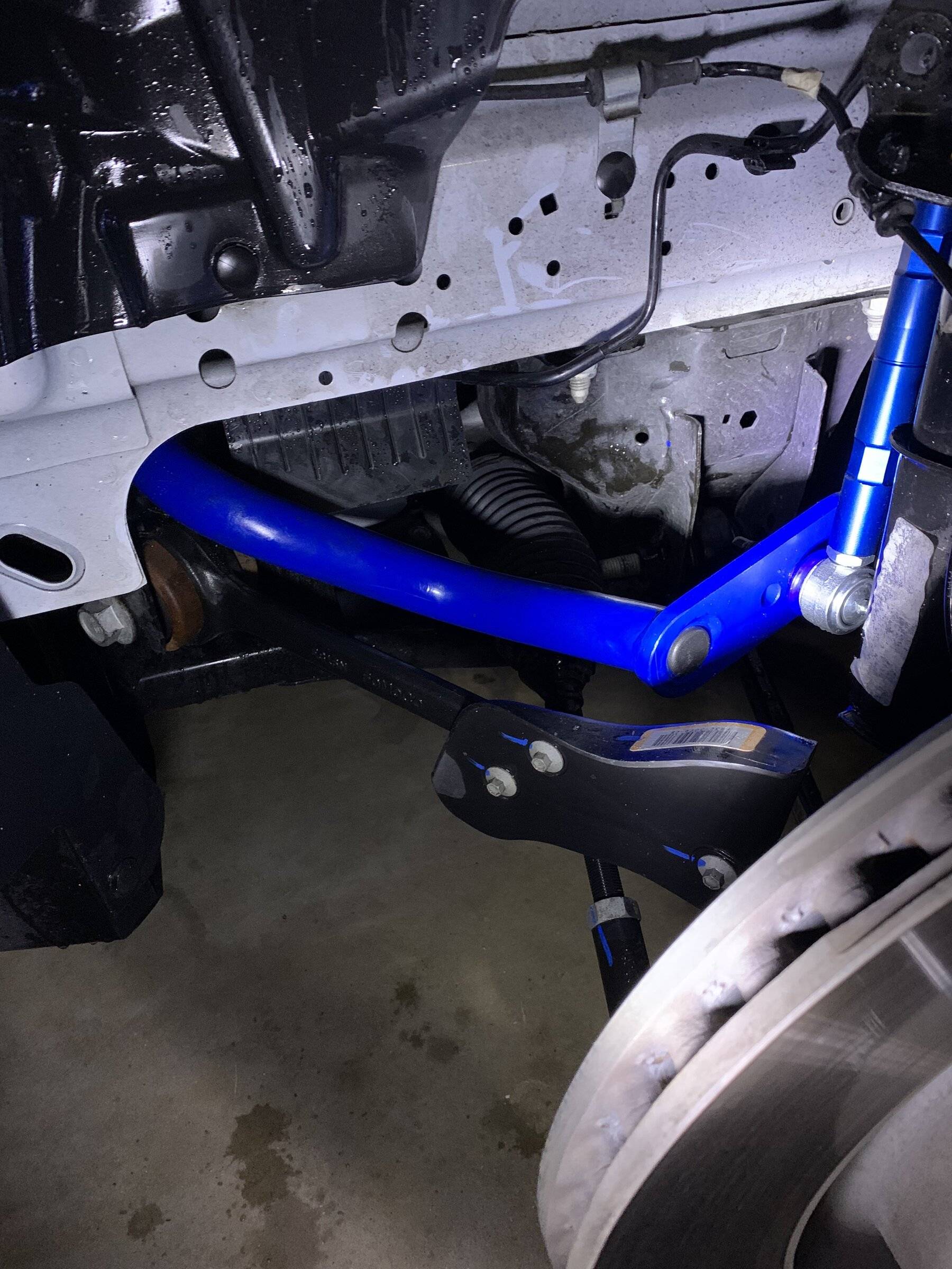

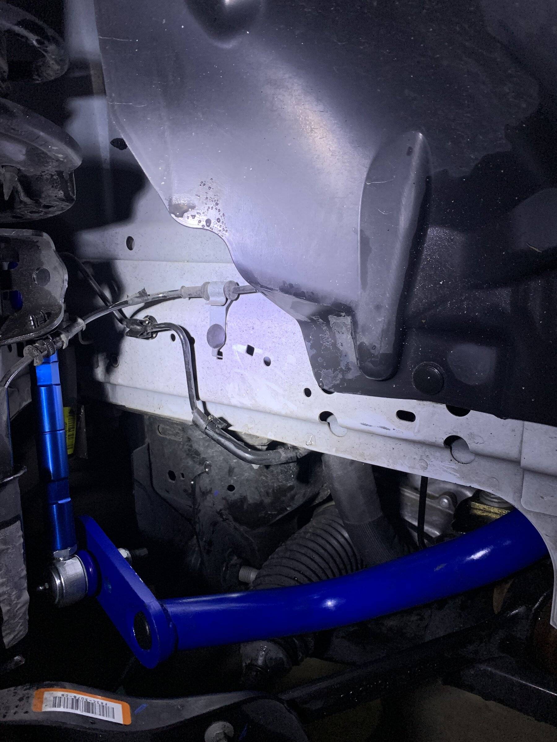

Adjusted the endlinks to allow the swaybar ends to be more parallel to the ground. The sway bar and end links make a near 90° angle as is intended. Everything is absolutely torqued to spec.

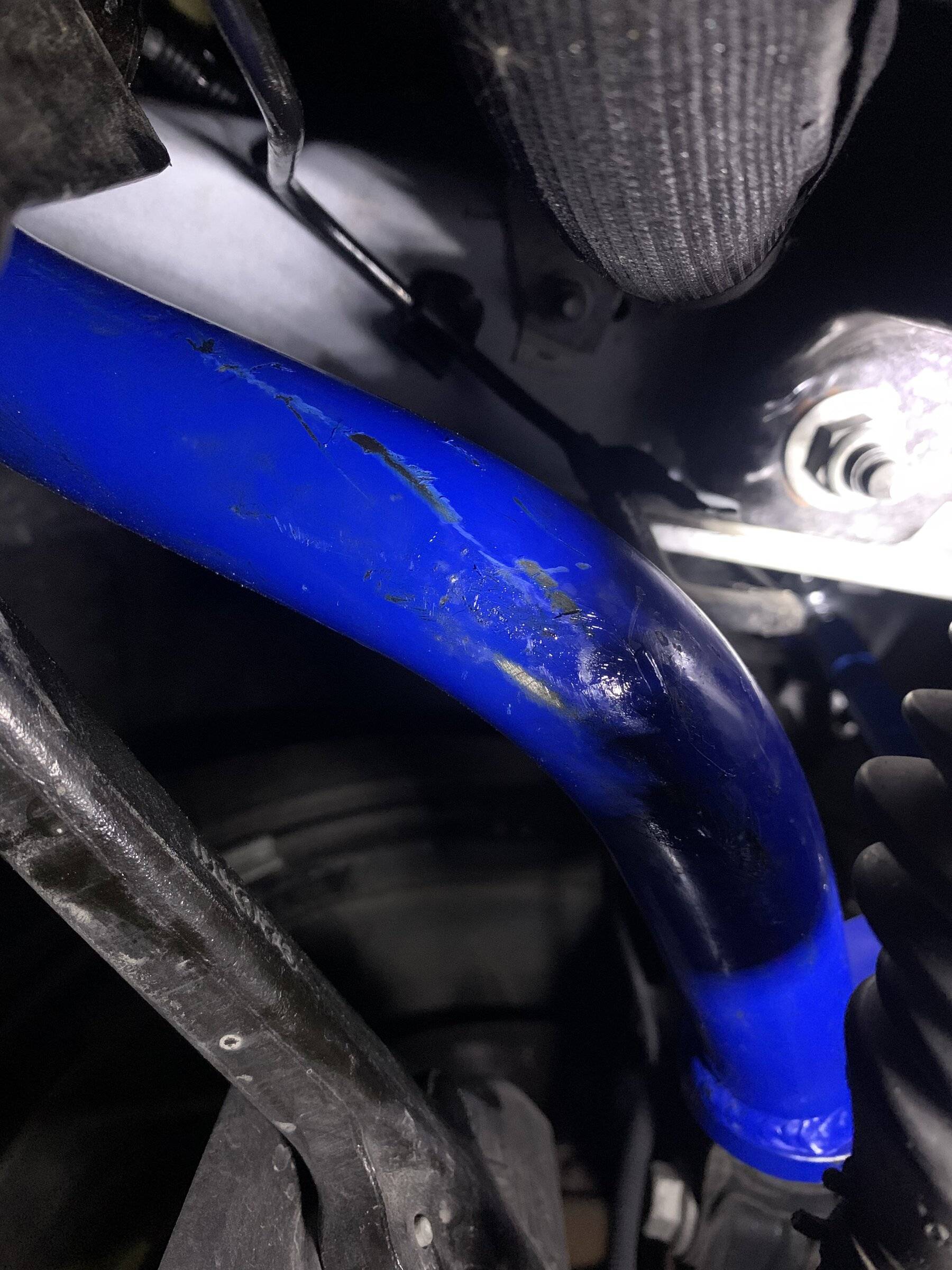

And this is the current picture of the bottom of my sway bar on the passenger side. This thing looks like it’s went to war….. Not sure if that level of wear could occur from installing 2x…
I am essentially ruling out the end links being the problem as the issue occurs with both the factory and aftermarket end links. Which leaves the swaybar installation to be in question however the sway bar installation is for bolts all of which are torqued to spec..

Back your swaybar firmness back one hole. This is better for the street and will give more clearance on turns.
If you keep the firmness as is, mount the endlink to the inside of the swaybar.
