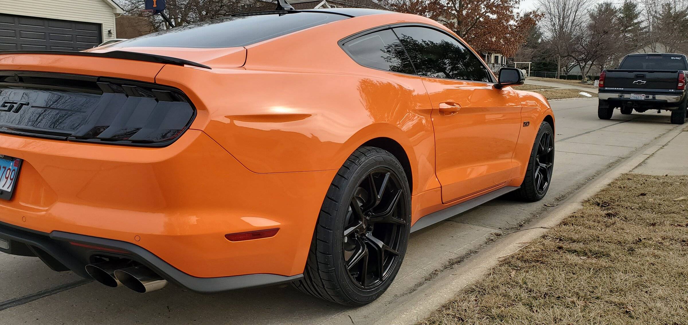

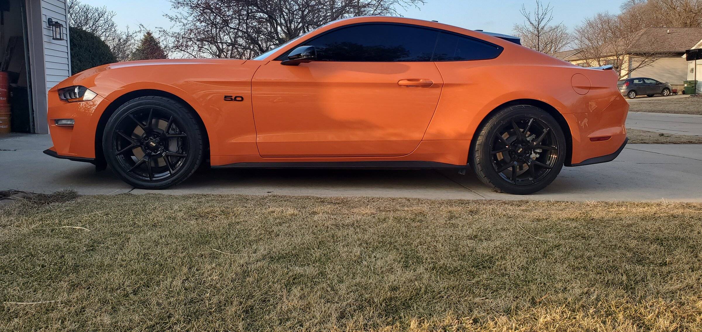

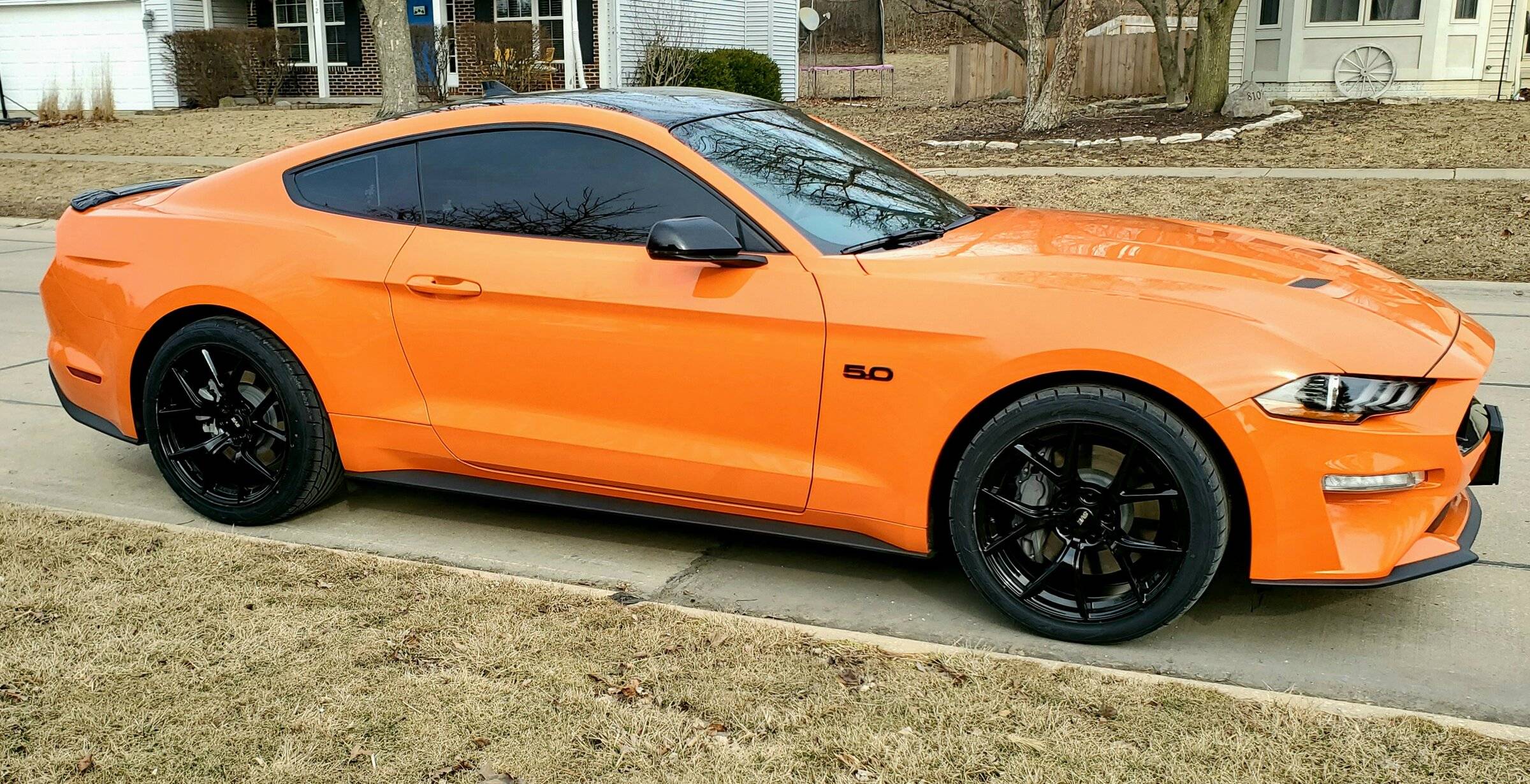

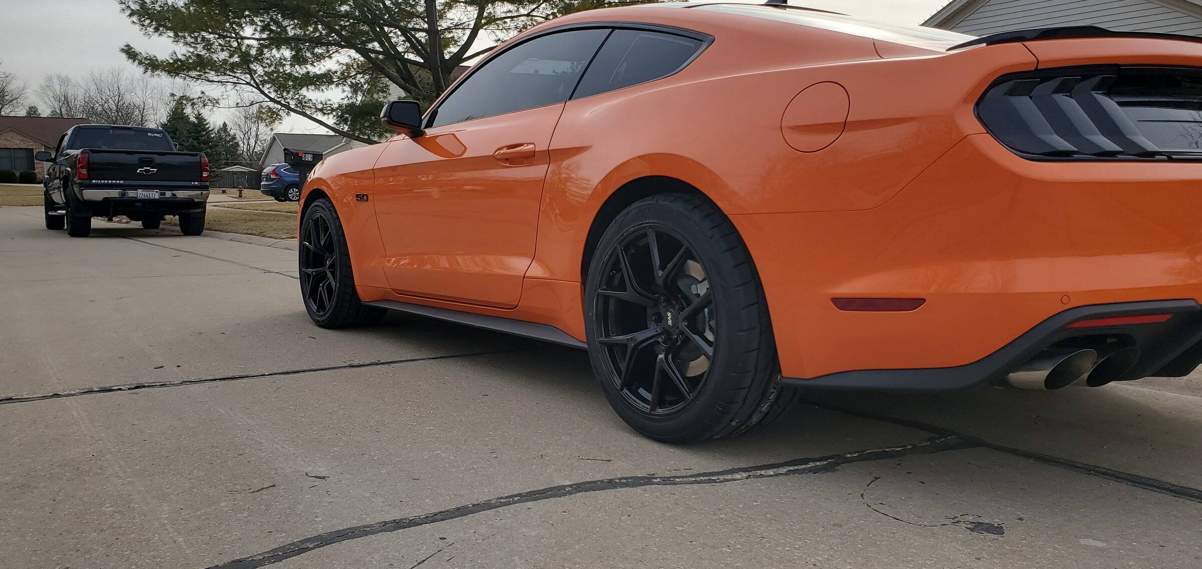

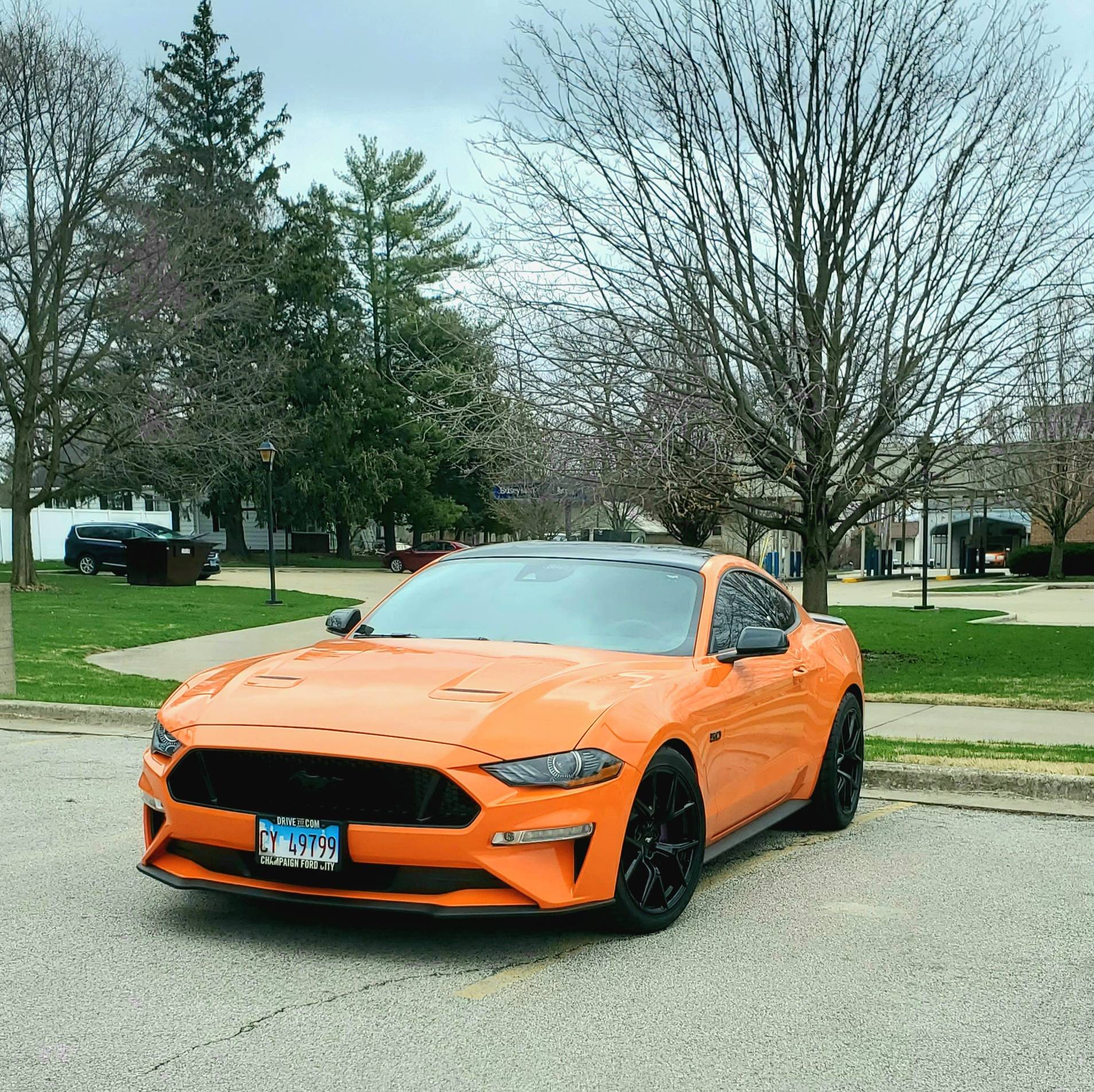

What size tires are those?
  • Front: 19x10 wrapped in 285/35/r19
  • Rear: 19x11 wrapped in 305/35/r19
I also just installed Ford performance street lowering springs and the stance is perfect!
