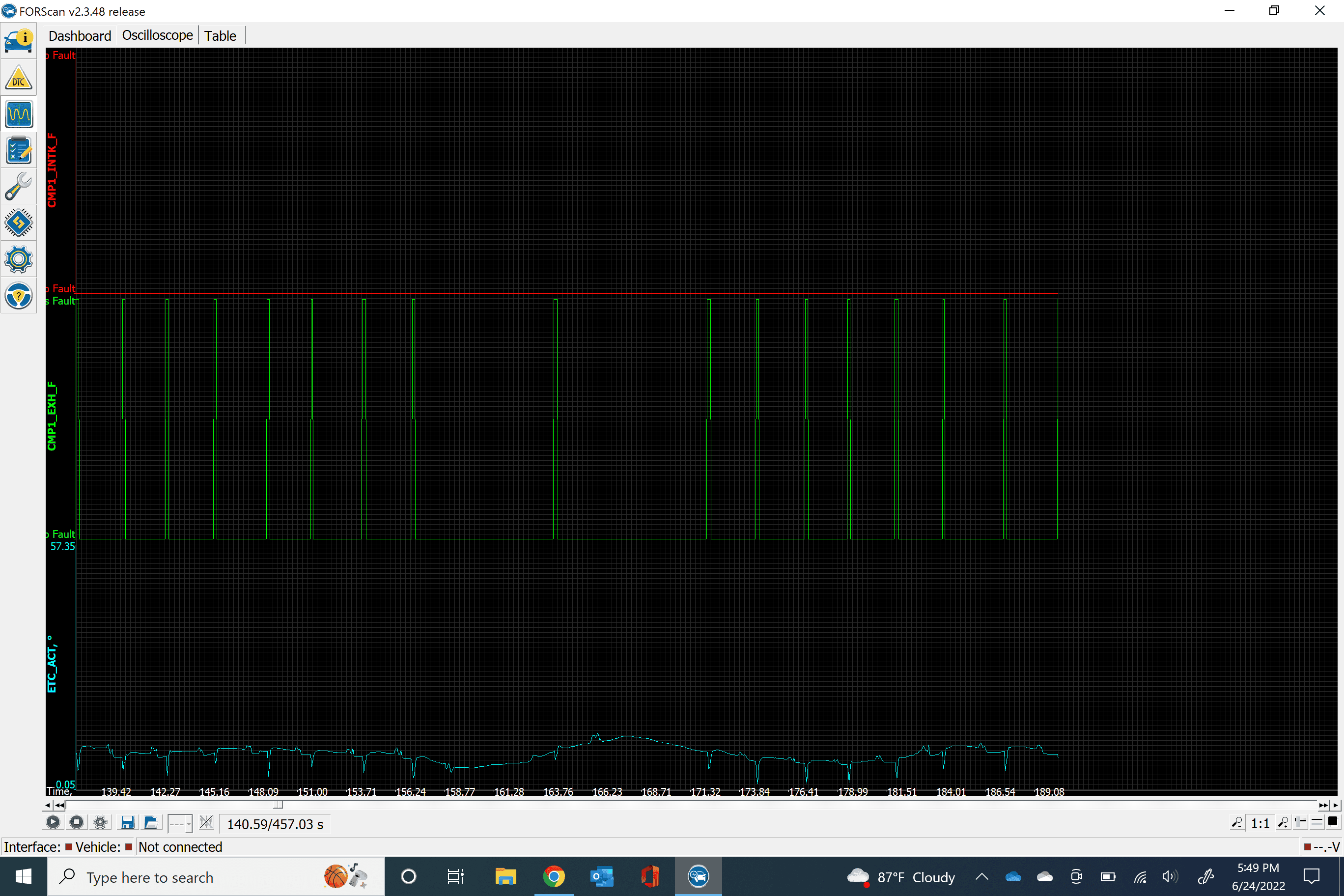

Soooo, I’m dumping my dealer. CEL popped up again Sunday night, I read the code as noted above. Took it in yesterday, they tell me there are NO codes stored. I showed them the pictures of the codes I read. Nope, none stored. On my way home, CEL popped again, I get the codes, the same 2 are in there. To be fair, the air shutter code isn’t throwing a light, but come on guys…hoping the next dealer is not incompetent.

Interesting news, light popped up again today so I took to the dealer as they asked me to. COuldn't possibly pull the codes, no time today. Come back Monday lol. Eff this dealer, came home and jumped on the oscilloscope feature of Forscan. Logged the sensors, and sure enough bank 1 shows faults. When the fault happens it also causes something weird to show up in the throttle body position too, so my guess is this is causing the surges. They happen exactly when the faults occur so I've correlated it to this issue. I swapped the sensors, and the fault did not follow the sensor so it's the wiring or the PCM. Now to get the dealer asshats to actually take a look, thats another issue altogether. I'll let y'all know how it turns out. Here is a pic of the log in case anyone wants to see it.

Well, I got some more information on the issue I believe. Last night on the highway about 2000 rpm in 6th gear (cruise set) I got a CEL. Pulled the code and got a P0369 Cam Position Sensor B Circuit Intermittent (Bank 1). Both cam sensors seem to be plugged in properly and don't look suspect, but I'm going back to the dealer with new info. I'll update if I get an answer.
Plugged in properly and operating properly are 2 different things. I think on the GT350’s there’s a known issue that the cam sensor harnesses get damaged due to being too short and cause sporadic issues.
Check your harnesses to the cam sensors - not just by looking at them, but pull the connectors and do continuity tests on the connector pins AND do the same with the actual sensors. Compare your readings of sensors to what they should be for a good sensor.
Any sensor or connector can look good, but that’s not to say there’s an issue within the wiring casing, connector pins or sensor itself.
Also check the crank sensor too. There have been M6G members that found the crank sensor to be faulty AND/OR the pins within the connector to be loose, which causes weird faults too.

I’ll definitely check into the harnesses. I did a quick and dirty test just now, swapped the sensors from exhaust to intake side and the fault stayed with the exhaust side so that means it’s got to be wiring (or possibly a cam relcut or wheel/timing issue?). What’s odd is that these faults WILL NOT trigger while the car is at idle, only while driving. I unplugged a cam sensor while idling and immediately got a rough idle and DTC. Idk I hate to mess with it too much since it’s under warranty, and I definitely don’t want to track down a harness issue. I just like to have all my info straight when I go to the dealer service department and show them where the problem is, they only have to fix it.

The saga continues…VCT solenoid didn’t help (as I suspected, but they have procedures). Check engine light came back on next day while the surging during part throttle cruise continues. The tech actually called me, and we discussed everything they have done to diagnose, and he asked what I had noticed. He was actually very interested in the logs I’d taken, and had me send them. Asked if it was tuned, I had to answer with ā€œI don’t knowā€ since I just bought the car a month ago. We decided going back to the factory tune might be a good step, so he reflashed the PCM to factory. He also mentioned an SSM bulletin that said cars built in this date range with code P0369 were to receive a new bank 1 cylinder head. Something about a ā€œMega capā€ that’s out of spec…don’t know what a mega cap is but he ordered the head. To be installed once it comes in, let’s hope and pray this solves it, because if it doesn’t I’m driving it off a cliff.
