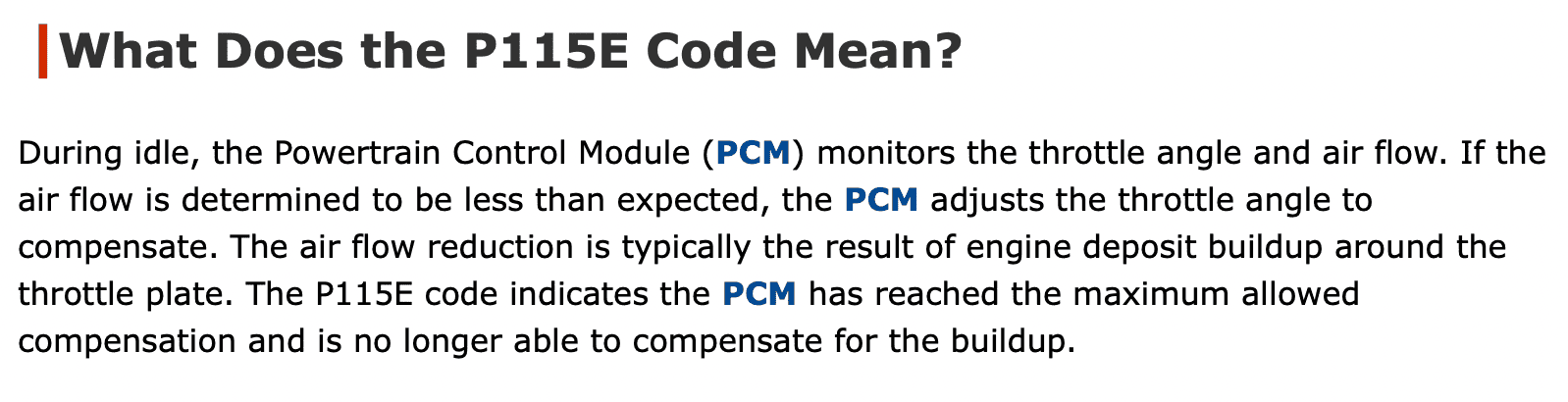

Actually is a code p115e. Tried clearing and it just comes back.
I cleaned the tb when I had it off. Thoughts?
I have nothing to contribute advice wise, but heres the code.
edit guys, I didnt see there was 4 pages. im sure this code has been explained

Lund gave up on me. Says there is something mechanical with the car. They were able to clear the pI15e code. But don't believe there is anything wrong with the car. Trying a new tuner next month when I get back home. The more I drive it I realize around 2500 rpms there is a minor surge that I can feel. I am pretty sure it is tune related. I will keep you informed.
