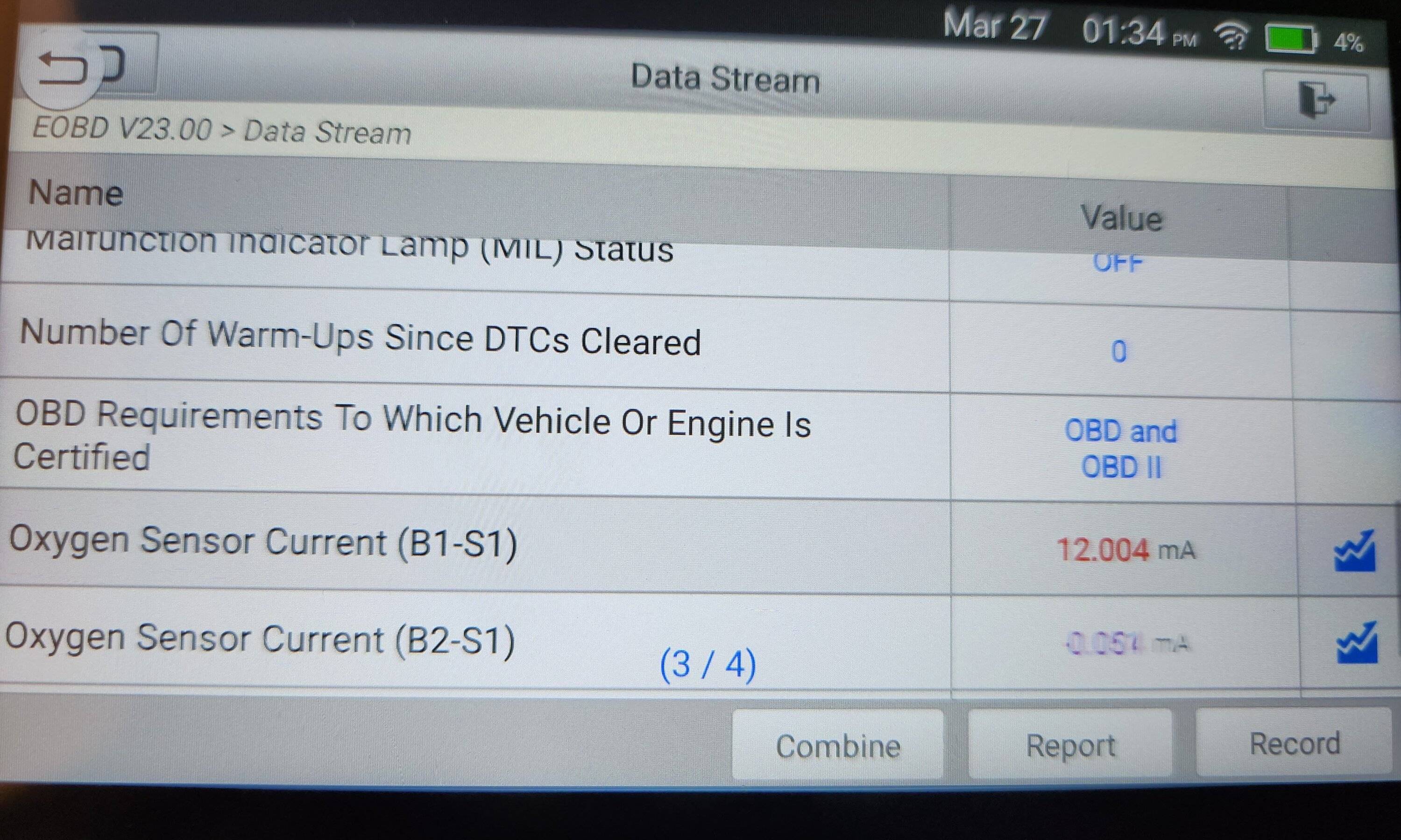

So... borrowed a buddy's scanner and got a P2251 code and this while the car was running. I actually had to replace the downstreams 2 years ago from driving in some crazy downpour.
So is this telling me just that one O2 sensor is bad? I'm going to replace both but just curious

Vacuum is dependent on engine RPM. If the idle varies even a little vacuum will too. Your only getting a 4 tenths variation, I wouldn't consider that out of the realm of possibility.
Out of curiosity how did you check for a vacuum leak? A smoke test is probably the most reliable way to hunt for a small leak.
