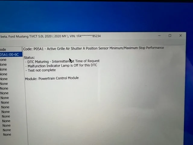

Hello guys, I just bought a 2020 GT with a Borla Type S exhaust and no other engine mods that I know of. I have noticed the surging in the video occurs while steady state cruising, it doesn't really seem to matter what gear though it's noticeable most in 4th-6th at lower RPM's. Here is a video, I used the vacuum gauge to illustrate that there seems to be something weird going on with the throttle perhaps?
I also noticed the grill shutters moving a lot while it was idling the other day, and I have the code in the attached pic for the air shutter limit switches. I had it at the dealer today for the PCM recall, hoping the reprogramming would help but it doesn't seem to have. The tech there blamed the Borla (of course) and said it was causing air surges. I'll admit I am not a mechanic but I have an awful lot of experience with modified cars and never had that happen with a cat-back. Anyone else have this issue, if so what is the fix?

That has absolutely nothing to do with the catback. It could be a malfunctioning active grill shutter though. Something may have damaged the connector or it's unplugged.

I did check, the shutter seems to be plugged in and the plug is fine. Car only has 6,000 miles on it so unlikely that anything is broken or damaged but you never know.

Well, I got some more information on the issue I believe. Last night on the highway about 2000 rpm in 6th gear (cruise set) I got a CEL. Pulled the code and got a P0369 Cam Position Sensor B Circuit Intermittent (Bank 1). Both cam sensors seem to be plugged in properly and don't look suspect, but I'm going back to the dealer with new info. I'll update if I get an answer.
