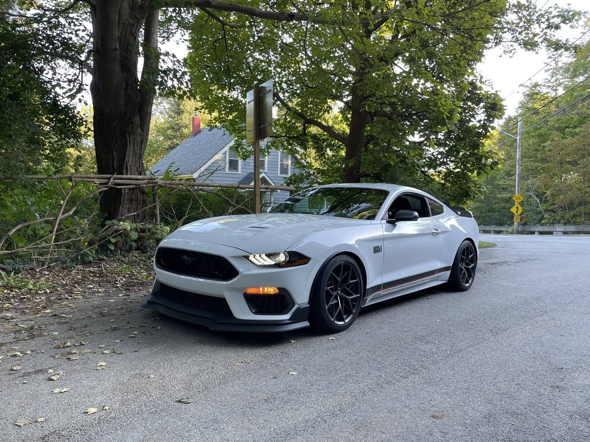

i got my Mach 1 only about a month ago, after modifying the pp1, and realizing I was on borrowed time with the trans, fighting diff over heat, wanting new struts, and seats, the mach1 made sense.
After a track day I went home, built a Mach to my spec and checked Inventory. Found my car on dealer floor in Oshawa, which they had for like 4 days. Just perfect timing. Traded the GT for what I paid 3 months earlier, and paid Msrp for the Mach. Couldn’t have been a better opportunity.
for me I needed a base car, leather recaros were an absolute no fly for me. Mine is a base, handling pack, recaros, and I think it has Nav.
