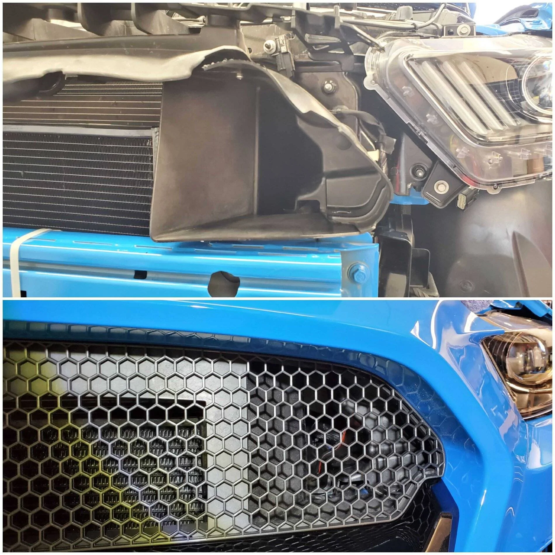

So this popped up in my feed and I'm glad it did. I've been battling a low speed surge and startup/idle issues with my 3.0 whipple and had numerous tune updates to try to address it. My MAF readings were all over the place and surprisingly no one ever suggested that it could be my grille.
In all my wisdom, I thought that opening up my grill and designing a ram-air funnel/duct like the GT500 would help my supercharger breathe, but it appears I was wrong :) The GT500 is Speed Density, not MAF, so it's not impacted like our MAF cars are by this.
Needless to say, I'll be experimenting with creating an ABS shield to divert air with my new bumper.

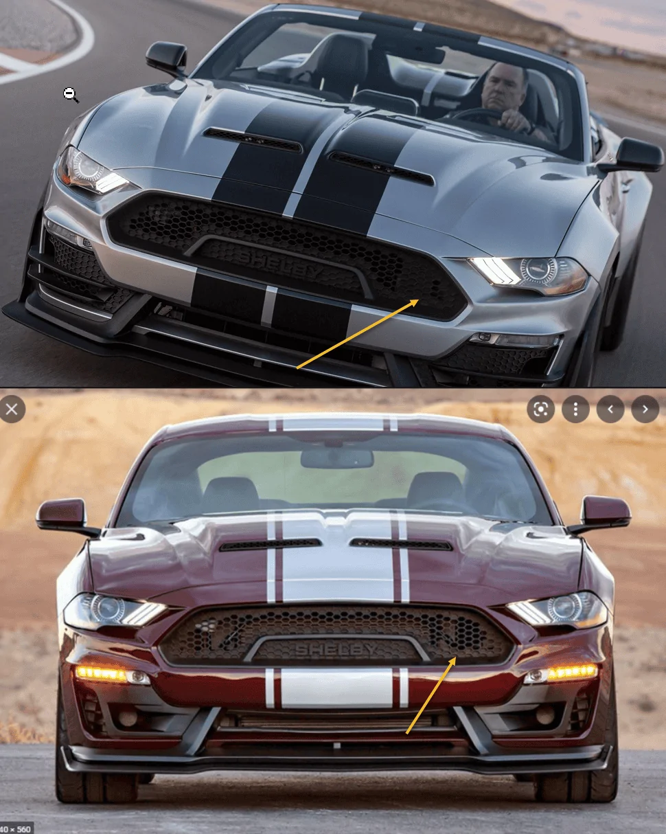

Also, did some searching after reading this thread and found these images. Notice in the 2021 Shelby Super Snake, the grille is mostly blocked off for the snorkel (like factory grilles), wheras earlier models are wide open like the Whipple picture posted on the first page of this thread. Seems to me that Whipple & Shelby worked together to fix this issue and Shelby issued a revised grill for the Super Snake in 2021.
Last pic is my beautiful funneled intake on my new grill lol. Back to the drawing board.

I had surging at cruise speeds only and was told the same thing about my aftermarket grill. I have 2016 GT PP 6-spd with VMP Odin that I installed myself and I couldn't believe the surging issue was caused by my aftermarket MMD grill that I love and had on car for 4 years. I was actually told to block off the inlet with a towel just temporarily to see if the surge went away and it did. With my MMD grill you can reach in all the way and actually touch the air filter. I then tried partially blocking the inlet with tape and cardboard (for testing) even some black putty to block say 80% of the opening all to no avail and I eventually put my upper stock grill back on that I luckily had sitting in the garage which has fixed the surging at cruise speeds issue. Now is the tune perfect? Not yet. Let's just say I'm on my 7th tune revision and I might just pull the trigger get my car dyno tuned.
Was thinking - looks like you tried blocking off the right side of the opening and leaving the left side straight through, which I think is the main problem. You want the air to go in and take a 90 degree turn. Wonder if you tried blocking off the left side and keeping 20%(ish) open on the right side how that would have worked out.
That's what I'm going to try with mine.
I dont have a picture of it but I tried this moldable black putty that cures when heated and blocked 80% of the snorkel inlet and I still had the surging issue. I still have my upper MMD grill and may try modifing it or the snorkel inlet again in the furure.

My car has this issue. It almost feels like the car is missing occasionally. I have the Roush Phase 2 with the California Special front grill. I see that the grill does have that section on the left mostly blocked with a small opening for air to go in. I can't tell if the issue is tune related or possibly the issue mentioned in this thread with the uneven air flow. I'm going to put some cardboard behind the grill to see if it makes a difference. The tuner indicated that he doesn't see anything in the logs. I have the C-series grill that I haven't installed yet. Sounds like that could possibly be an issue also.
FYI for those that showed a picture of the supersnake front end.... My dad drove his friends 2021 supersnake recently and he said the car did the same thing. Felt like it was missing slightly when cruising.
