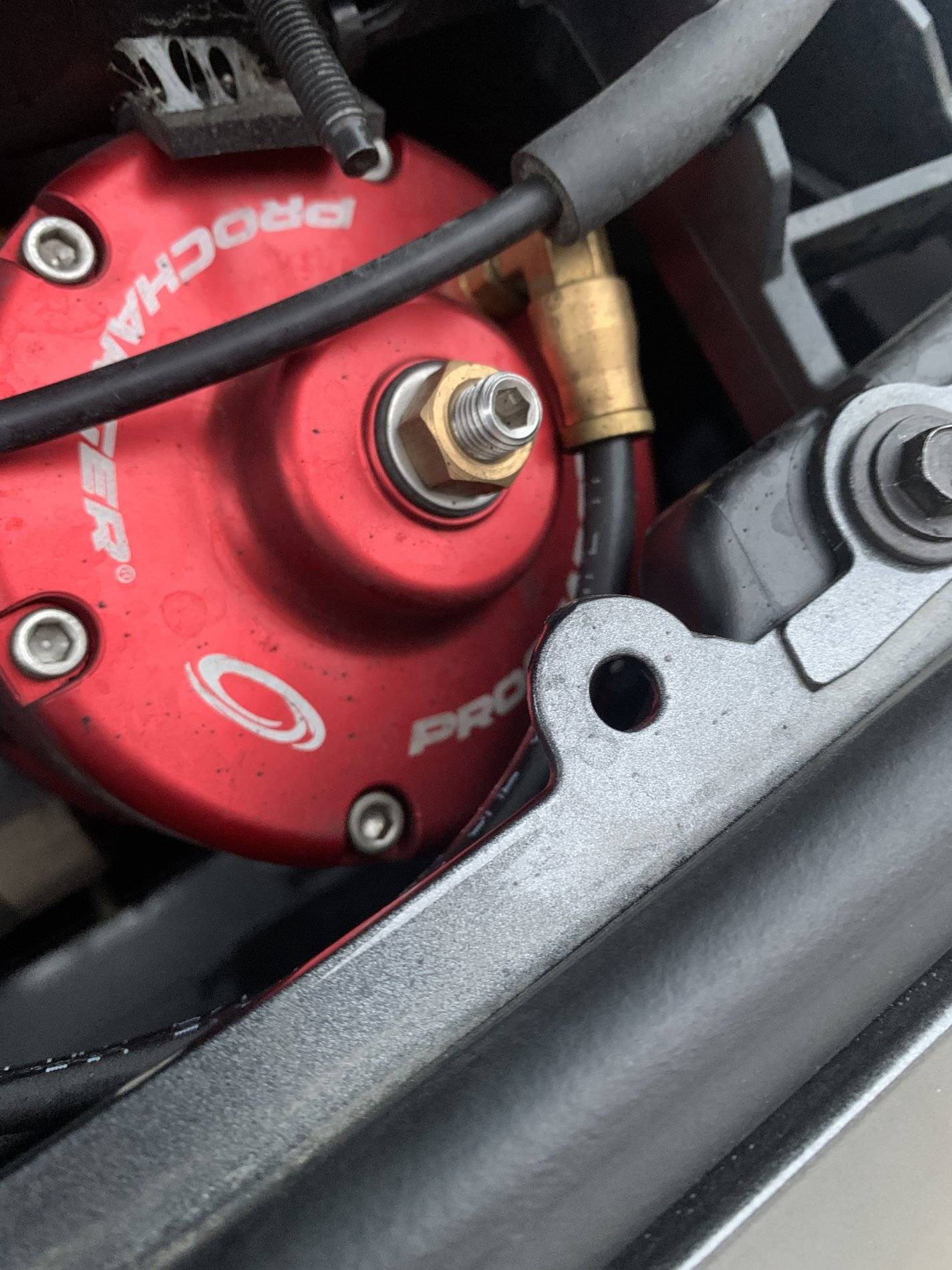

Running the ProCharger red valve. Also everything is being logged kr is always in a negative value. The noise definitely occurs when I’m in the throttle. The video may not reflect that, but that is the case. I was kind of thinking maybe it’s a boost leak. Guess I will have to smoke it when I get the time. Also probably going to eliminate the imrc’s just to rule out the possibility of them closing under load.

Spring preload set properly on red valve?
Wasn’t aware there was an adjustment for preload. I’ll check into that as well as any possible boost/vacuum leaks

2018 mustang gt
Any idea what the procedure is for adjusting preload on this valve?
