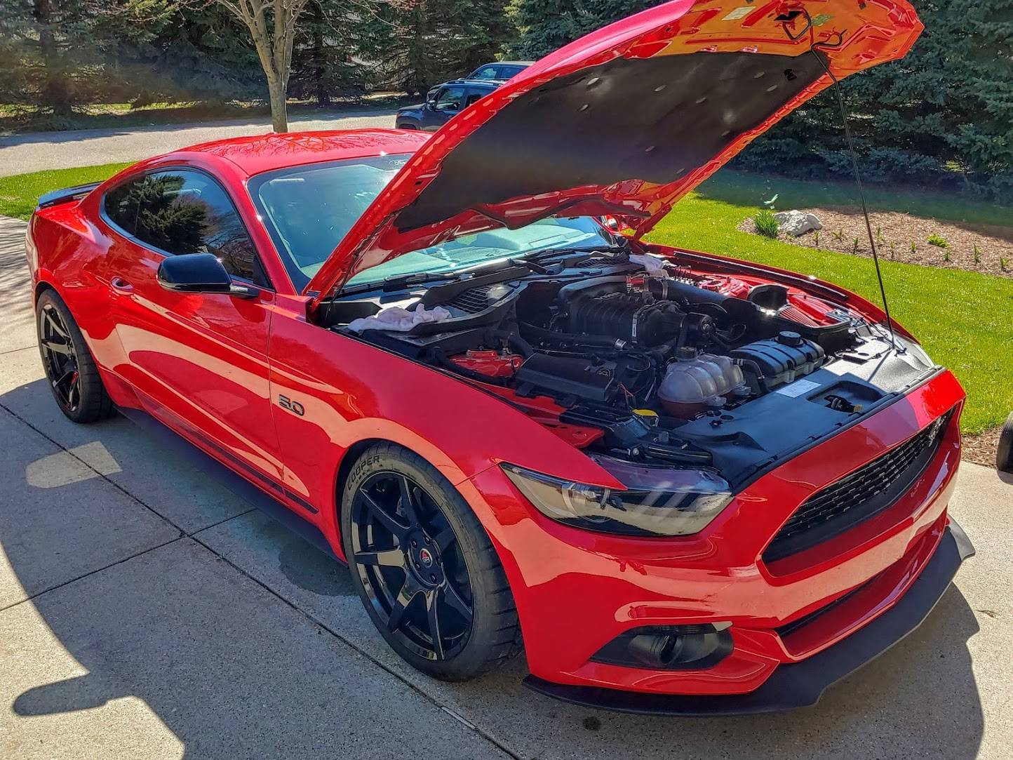

At the end of the day it is all about your goals and how much money you want to spend. 600 at the motor is easy with any setup and as far as breaking stuff that is a risk you run at any power level. You can break sh!t at stock power levels :) If you think you need more power, go for it!!
Here is my 17 and she hasnt broke anything yet......
