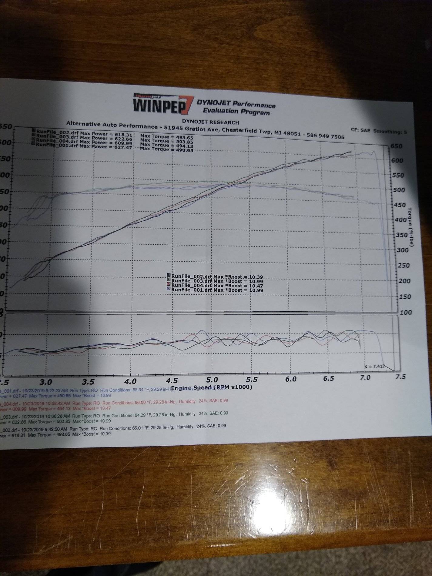

Here is the dyno sheet. This is SAE which is usually somewhat lower than "STD". Note that the car hit the MPH limit so the sheet is cut off there. Since the Whipple pulls to redline unlike the Roush TVS 2300 I had on the '11, if the car were run to say 7,800 rpm, the run might have shown 650-675.

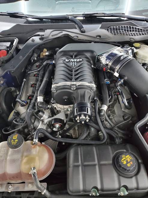

i have a 16, just installed a vmp gen 3, it will get you 100 more hp than you want, but we always want more. you cant go wrong with the whipple or edlebrock, i went vmp because i live in flo, and it has the best heat exchanger available and seems like the most tq avail at low rpms. very happy with my my setup

MyFirst5.0 did you dyno it and if so what fuel and pulley setup?
MyFirst5.0
Oct 15, 2015
1,208
337
west coast, Fl
2016 deep impact blue premium gt
no dyno, but it was installed at vmp and tuned by them. cars like mine with full exhaust they said put down low 700s all day. this is a stock 88mm pulley and 93 octane
