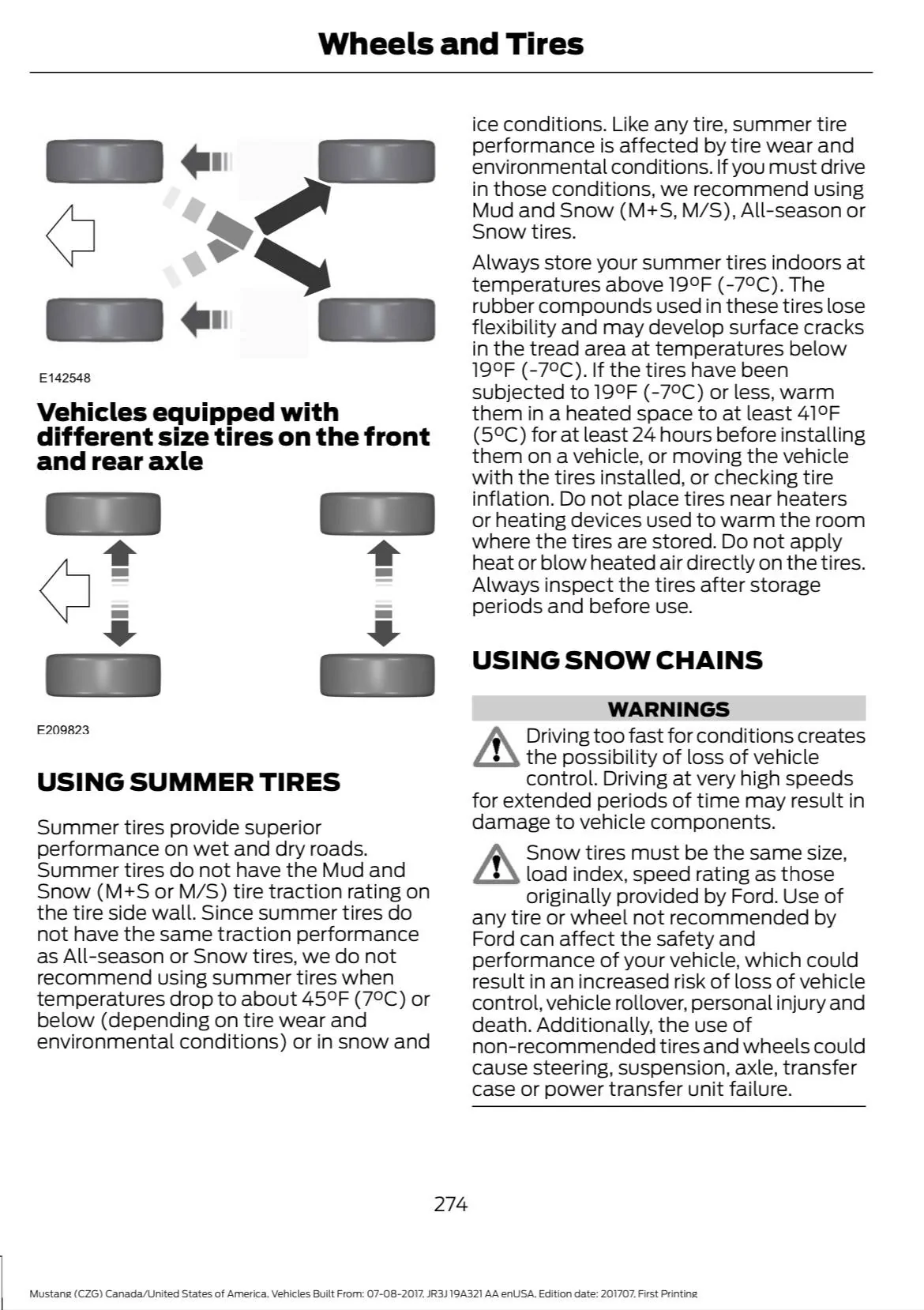

As for the initial question, if an owner was the original purchaser of their vehicle, in the glove box with the owners manual should also be the Tire Manufacturer Warranty docket for the specific tires on the vehicle. It will explain the tire use or operating recommendations.
The actual Mustang Owners Manual also has pages for the tires. For example, Summer Tire page from the 2018 Mustang Owners Manual (same exists in prior years and later years):
The statement in the manual is just a "recommendation" not to drive on Summer Tires for specified reasons on that doc page.
Does it mean you can't? No. It is just a recommendation that due to the tire compound and type of tire (tread, other ratings, etc) that if or when a driver does drive in those conditions to be aware that the tire's performance will be degraded.
There isn't any "right" or "wrong" with using/driving on such tires at 45* or below - it's owner choice and/or risk (if any risk is present).
The back and forth jabbing posted in the last few pages is ridiculous. It's like those who own a 4x4 or AWD SUV think they can still maintain excessive speeds on ice or heavily snow covered roads without any risk to safety. Its the same argument where those who do buy "snow only" tires for sports cars also think they're invincible from similar risk, just because they have a "snow" tire. For every owner with a 4x4, AWD SUV, OR those who have put snow tires on a sports car and made it through a season, there's 10 others with the same vehicles or used same snow tires and have wrecked....
Summer only tire compound will always change and become harder in lower temps, where All-Season compound or snow compound remains more pliable.

I remember reading about storing the tires indoors when I bought my Mustang and laughing a bit.
