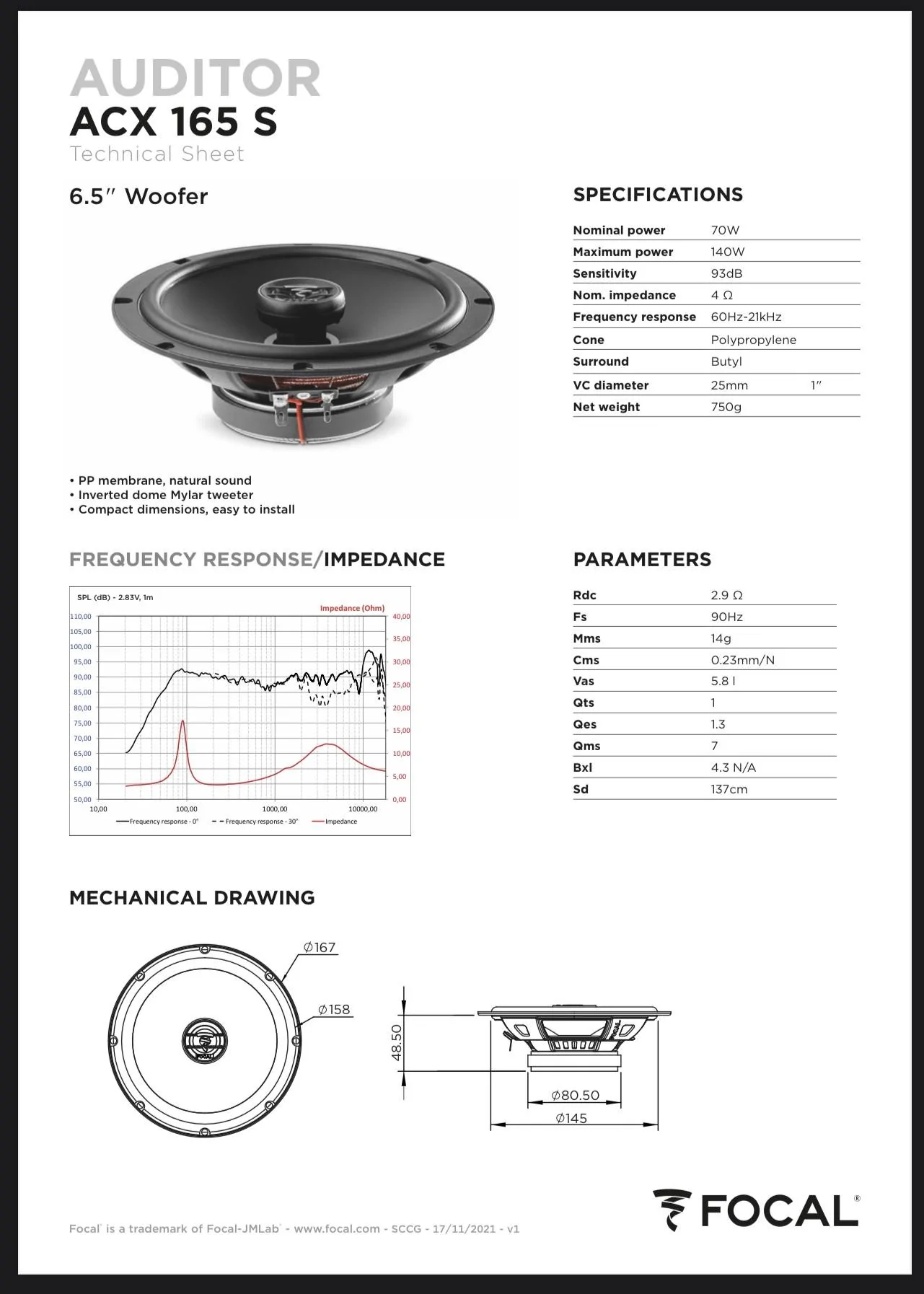

Quick question, if you don’t mind. I have no idea about sound systems but was reading through a bunch of stuff on here and wondered; can I just grab the rear speaker lines, put them into a small two channel amp, and run better coaxial 6.5s in the factory position and get a ton more sound out of the rear end without going through all the stuff other people are talking about on here? I’m just looking for a little more punch from the rear while adding some “fullness” with the added dome tweeter. Something like the Auditor RCX-165’s. Appreciate any feedback.
Yep. If you can find an amp that will accept a ‘high’ input (use the speaker wiring into the amp), you can amplify the rear signals and boost them, providing an output to some aftermarket speakers.
Before hooking up an amp though, you may be surprised to find that the Focal Auditor series of speakers are actually quite efficient and will play a little louder than the original speakers even off the OEM amp inputs.
Put a bit of sound deadening on the rear shelf and maybe alleviate some of the holes that cover the speakers in the OEM rear shelf carpet and it’ll give it a bit more room to breathe.
The shape of the mustang is great for throwing the rear sound forward without being too overbearing 👍🏼
Yep you can do that as have many on this forum. You should be aware though that the rear channels have a bass roll off and are equalized with the stock amp. So hooking up a sub using high-level inputs from the rear won’t give you the low end you’re looking for, it’s more of a mid bass band pass.
Just looking for the rear to keep up with the door woofers. They just seem sooo weak.
Here’s a recent video from Car Audio Fabrication that discusses this topic a little further for info purposes
Great info. So if I understand right, I’ll need an amp that has a built in DSP? Like my other reply I just want to bring the rears up to the power level of the lower door speakers. Already hooked them up and punched out the holes. if I fade it slightly rearward it does sound a lot “more full” but still lacks power in the rear.
Here’s my personal experience and opinion if you want it. Sound deadening. Adding sound treatment to the doors makes a significant difference in the OEM system. The 6.5” mid bass have more punch and and provides a deeper sound. If budget is a concern just doing this alone makes a huge difference and can be done at home by amateurs.
As for the amp, it does NOT need to be a DSP. There are non DSP amps that accept high-level input.
Looking at infinity primus 6002A
