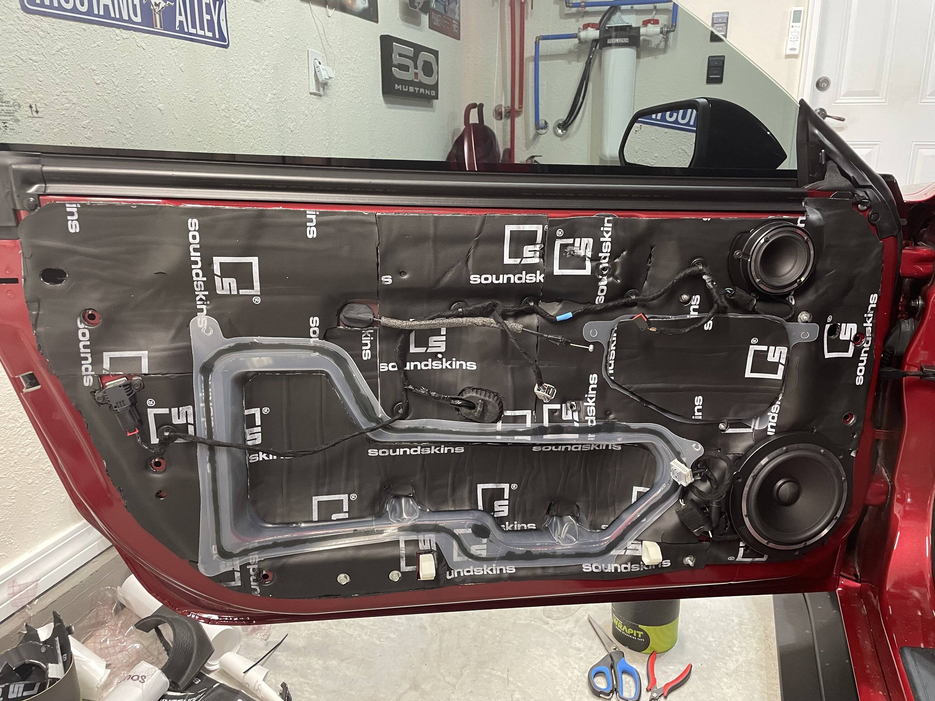

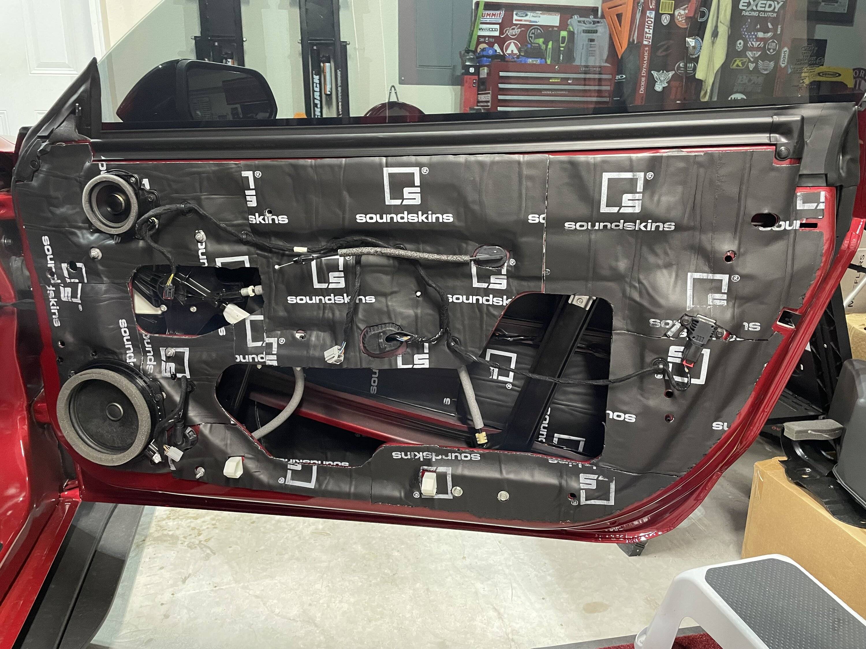

Look into SoundShield or Sound Skins. Dynamat isn’t bad, but you can find others just as good or better for less money. Here’s my doors using both above (they are built the same so you can use one or the other, or both)
