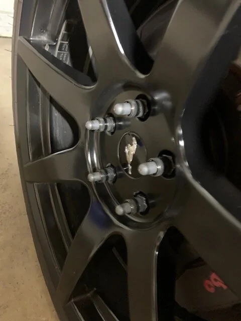

For lug nuts, IDK. This is what those GT4 studs look like poking well out of my street wheels (with a small 5mm spacer in there). They don't seem to corrode exposed like that (at least in Texas). The ARP studs I ran before were also fine exposed to the elements.
