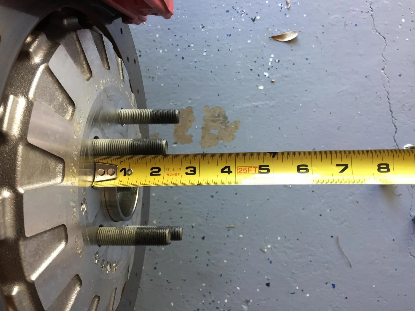

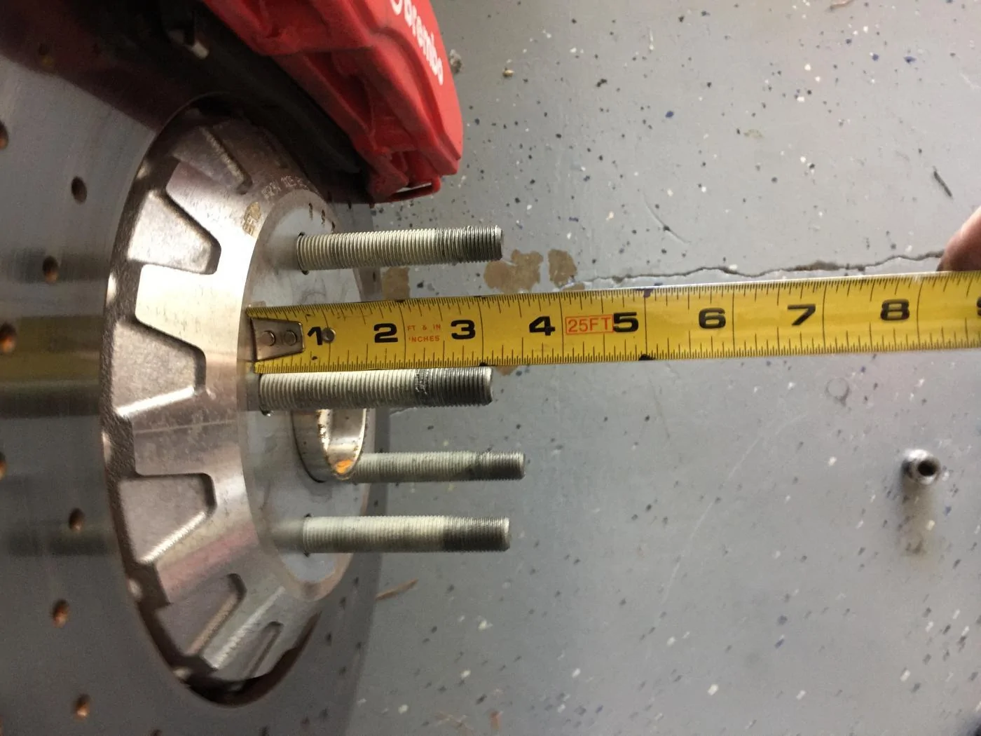

Cool... I thought I heard somewhere that the R had longer studs.
It does. 3" on the front and 2" on the rear. The only time you'll have to worry about this in terms of lugs however is if you are installing an aftermarket wheel (such at the 6GR) due to the lack of the substantial mounting pad thickness the Carbon Wheels have.
