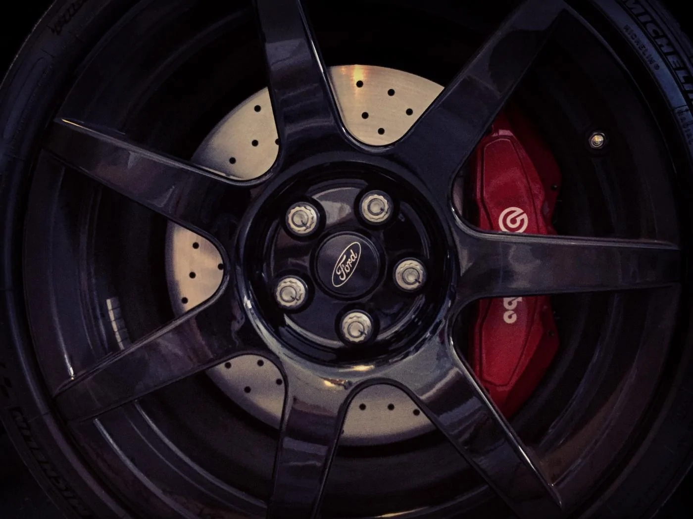

The OEM lugs are heavy. That's about all. They've a tendency to mushroom and deform on top of the fact that they're gaudy looking and unnecessarily heavy.
Once I installed my Ti lugs, I put reference marks on the lug and stud to track and easily identify any movement. 2 track days and they didn't budge a single micron.
Ozmo recommends Permatex 77124 Nickel Anti-Seize, so that's what I used.

Thank you RustedAngel for the info and picture. Will go with the Permatex Anti-Seize.
