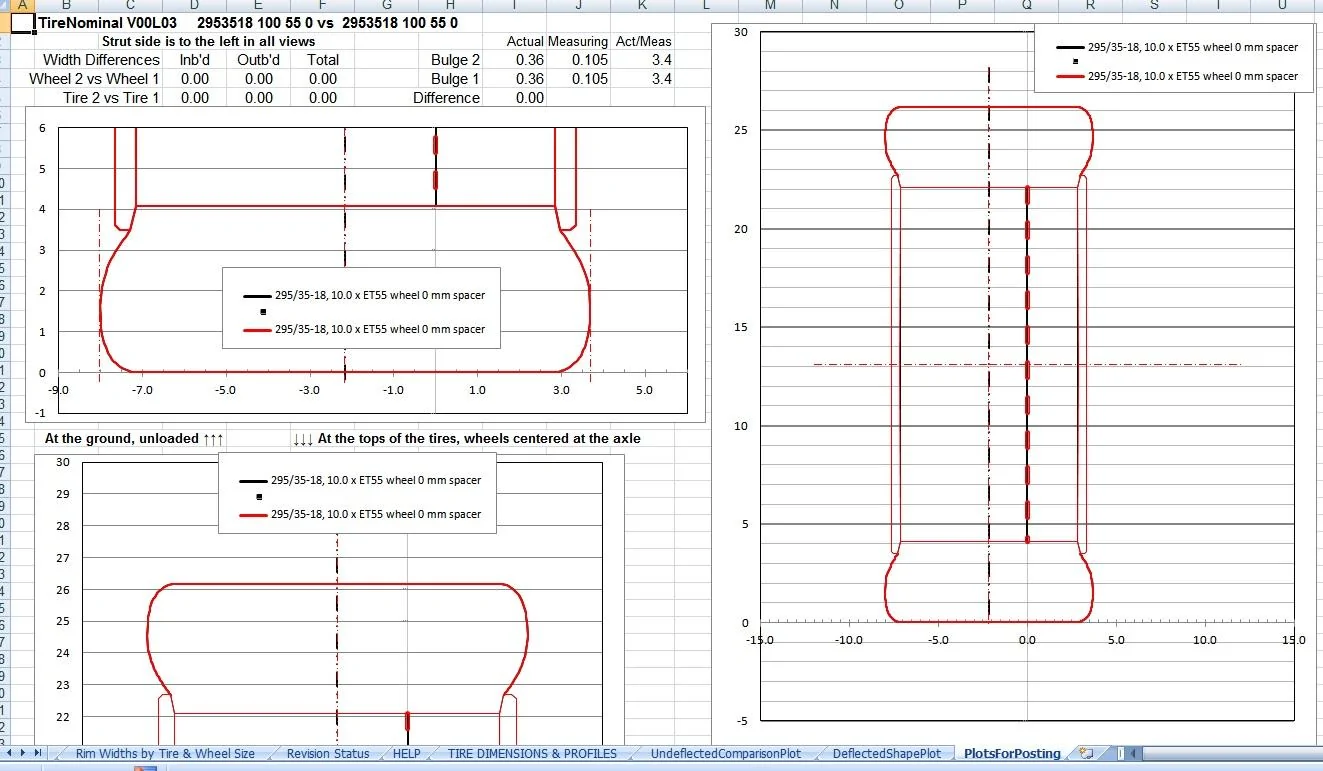

Here's a better illustration of sidewall shape relative to the wheel for a 295/35 on 10's, and the bulge is clear. 19" vs 18" is irrelevant, the 18" file is just what I had handy.

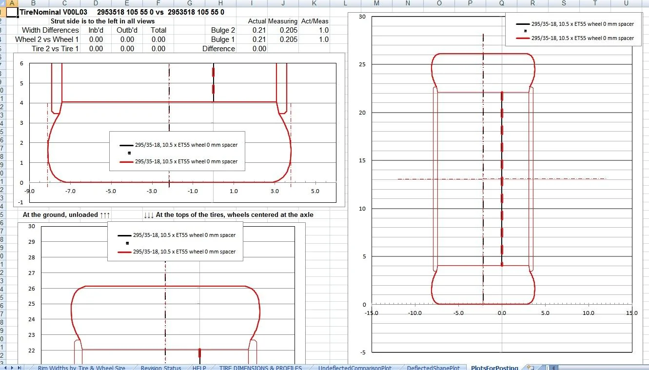

On 10.5" wide wheels. Note that there is still a tiny bit of 'bulge'.

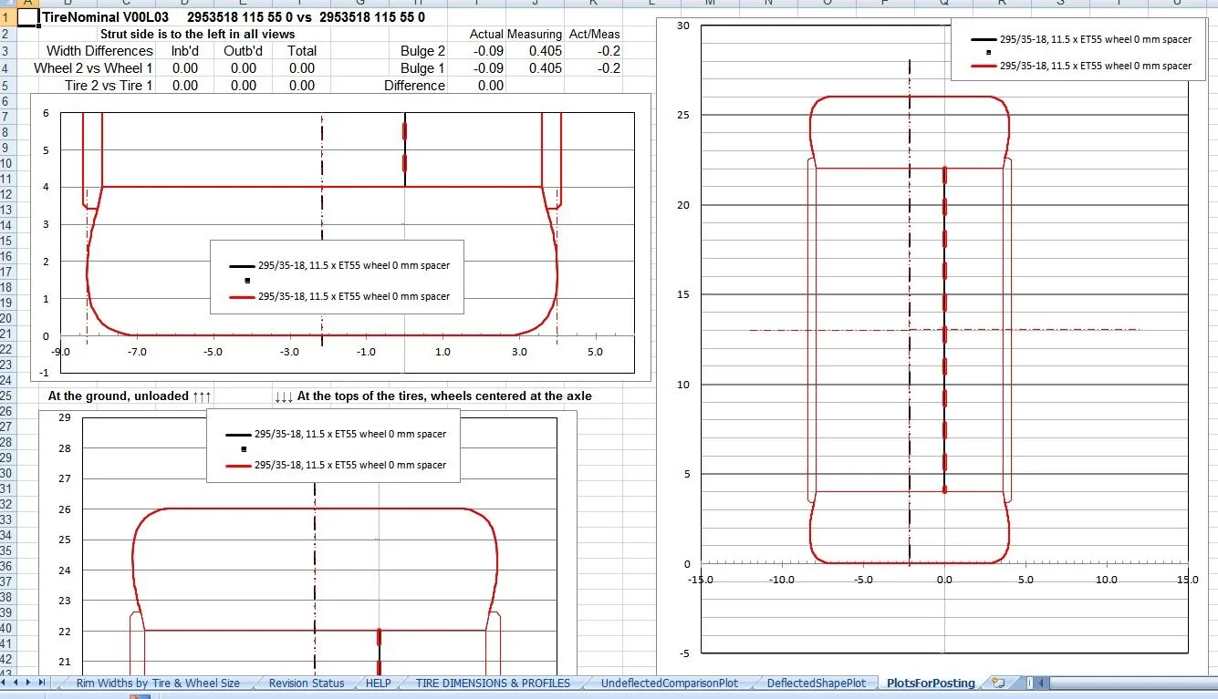

And finally on 11.5" (max-recommended).
