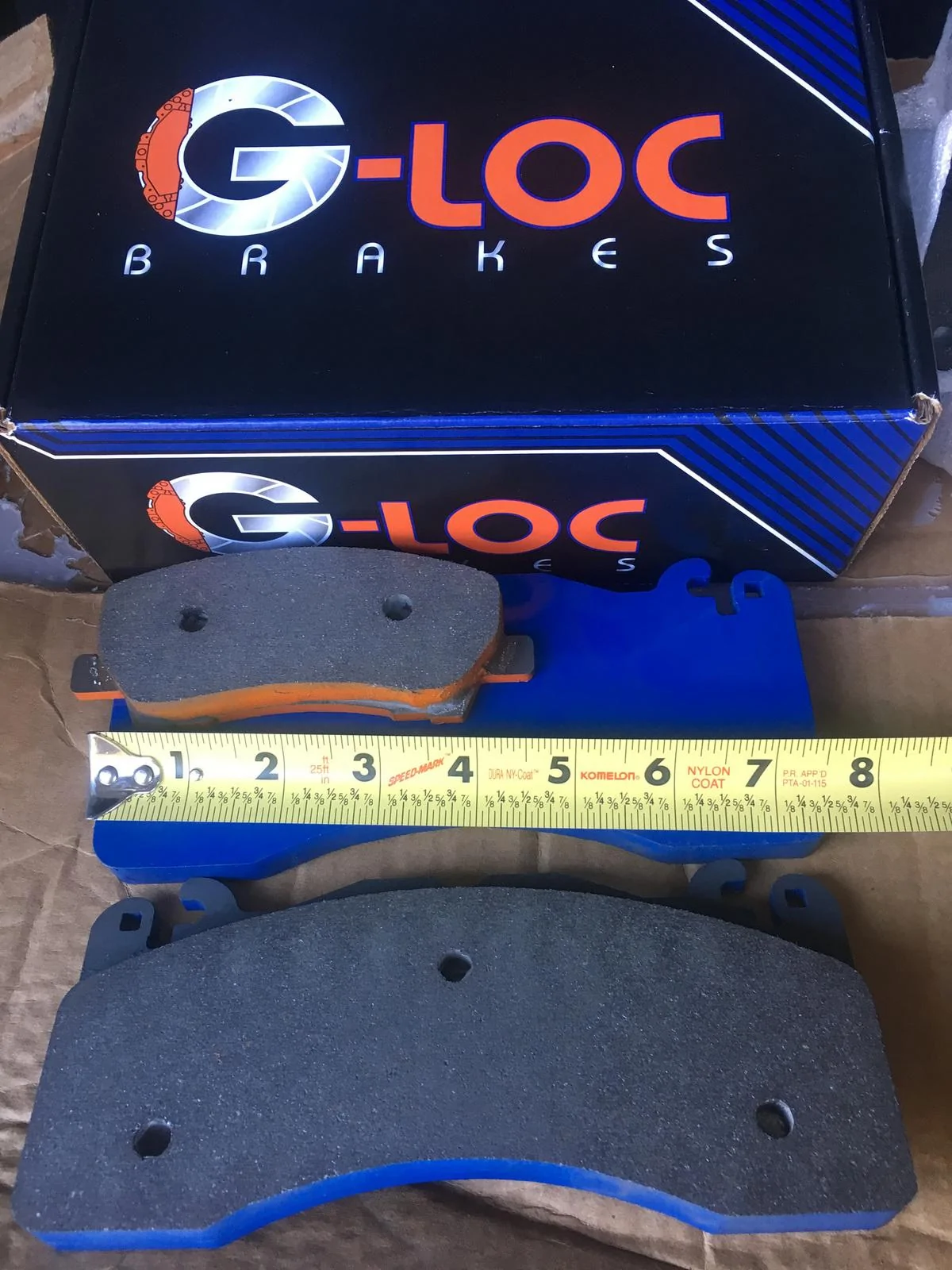

Don't you love it when the photo shows 3 parts, but nowhere on the page does it confirm Quantity 3? :mad:
I knew about them, just didn't think I needed them. lol

Thanks to [MENTION=22413]Optimum Performance[/MENTION] for the last minute brake pads!

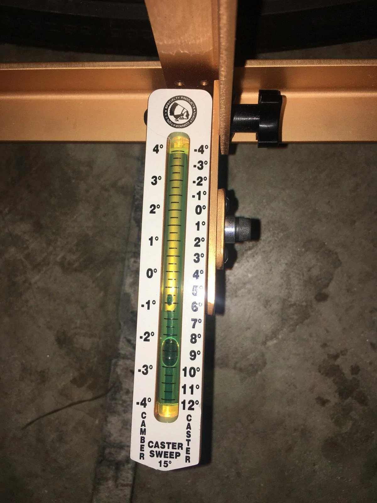

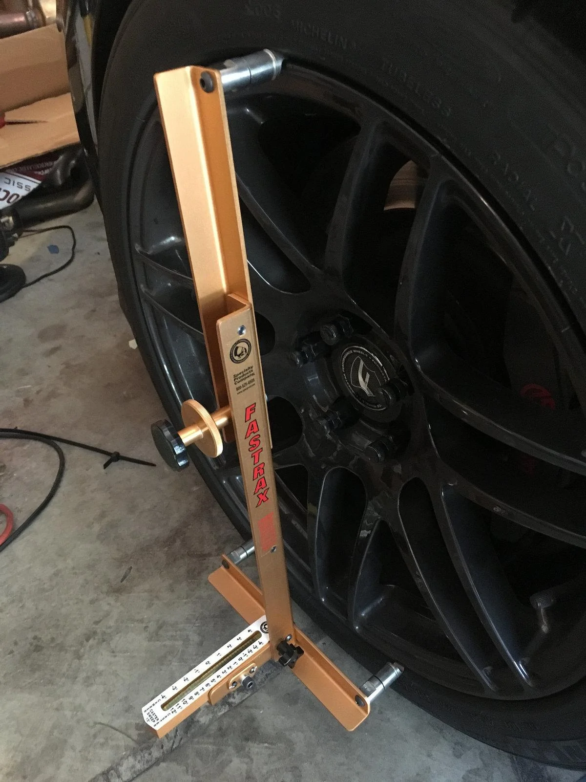

Finally I can dial in my camber at home. Firestone will be happy.

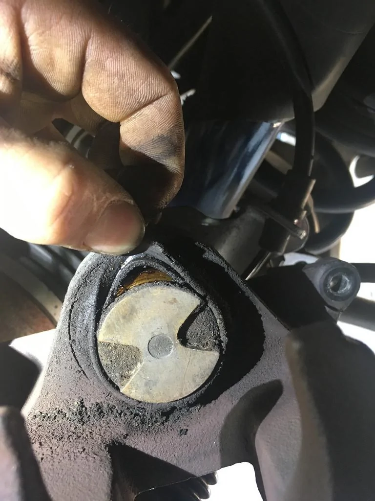

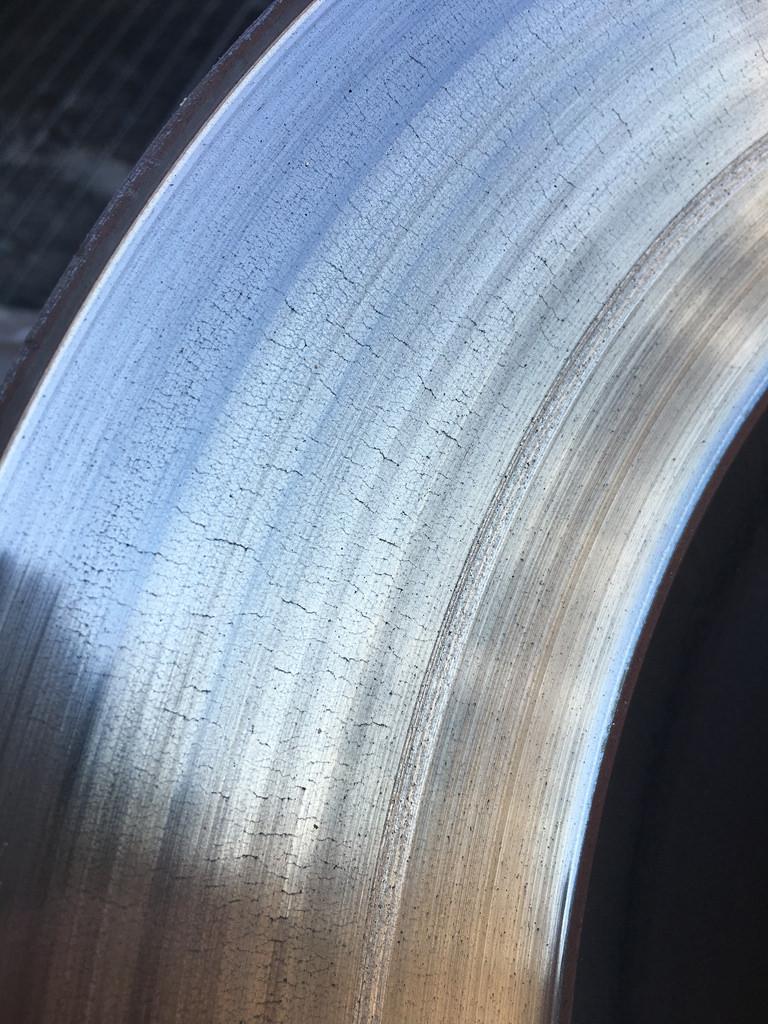

The brakes took more of a beating then I had expected... Front dust seals are toast on the Brembos, rears are just as bad or worse. Additionally there are heat cracks in the front rotors...
