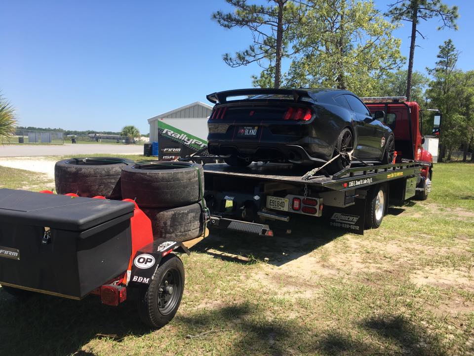

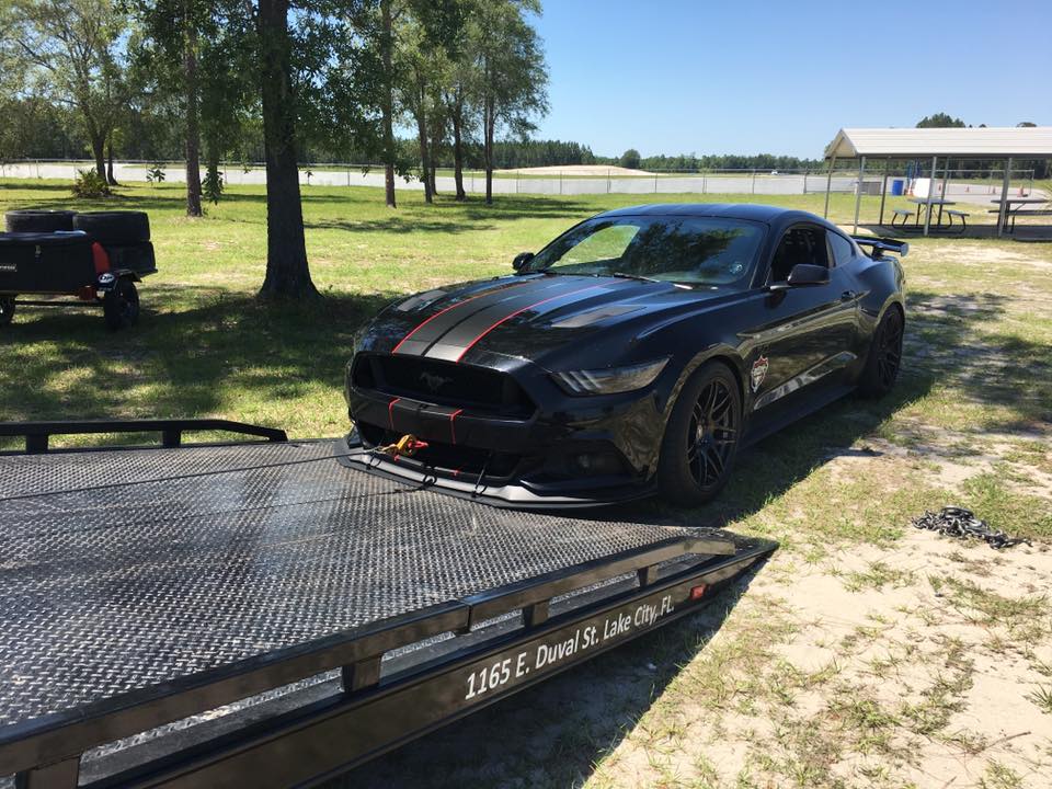

Well there's your problem...
Coming out of turn 7, 2nd to 3rd gear shift and the clutch only came halfway up. Tried 3rd to 4th and the same thing... Nursed it through turn 8 and tried another shift on the main straight. Nothing. Floppy clutch syndrome. Coasted into the pits and called AAA.
(Dusold Designs tow hook works as designed) :headbang:

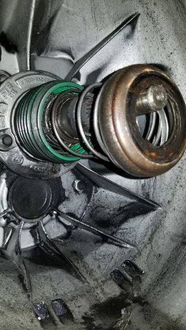

Since the trans was going to be apart I swapped from the McLeod RXT to the RST, installed a stainless clutch line, Ford Performance pilot bearing, and the obvious upgrade to Exedy throwout/slave.

Exactly what happened to mine. I had to drive home without a clutch. Started it in 1st gear and then banged up through the box till I got home. Stock clutch no good for track days.
The clutch was fine, it was the slave that failed.
Wish I had waited few months before getting the rxt. All of the information now finally coming out about it being too much for the mt82. I just got the damn thing last November. Seriously thinking about yanking and selling it and swapping for rst. Take the loss vs transmission
I haven't driven the car much since it was done, but so far I'm glad I made the change. No more 1st gear chatter, simple and smooth engagement and overall smoother shifts. I don't think the information about the RXT vs RST is new, just new to this forum unfortunately.
