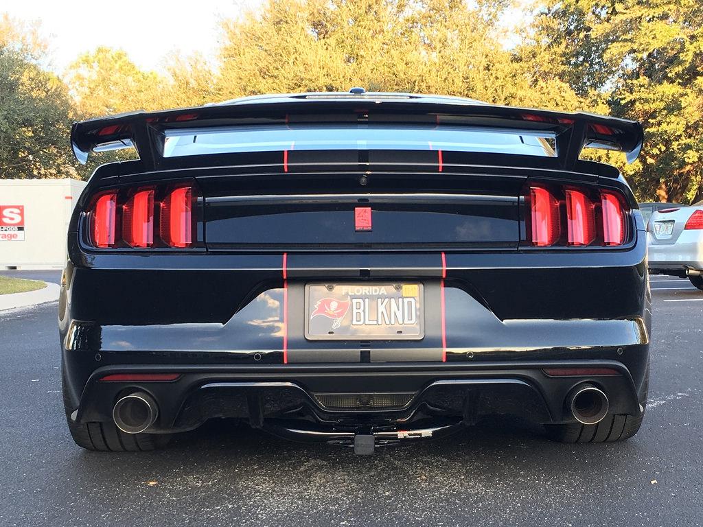

I picked up the hitch, 'euro ball', and plug and play wiring harness from auto anything for a little over $200 delivered to my door.
Auto Anything - http://www.autoanything.com/towing/73A3874A0A0.aspx
It took about an hour and a half to install on ramps by myself. With help it probably would have been half that. :)
(I didn't actually buy the hook)

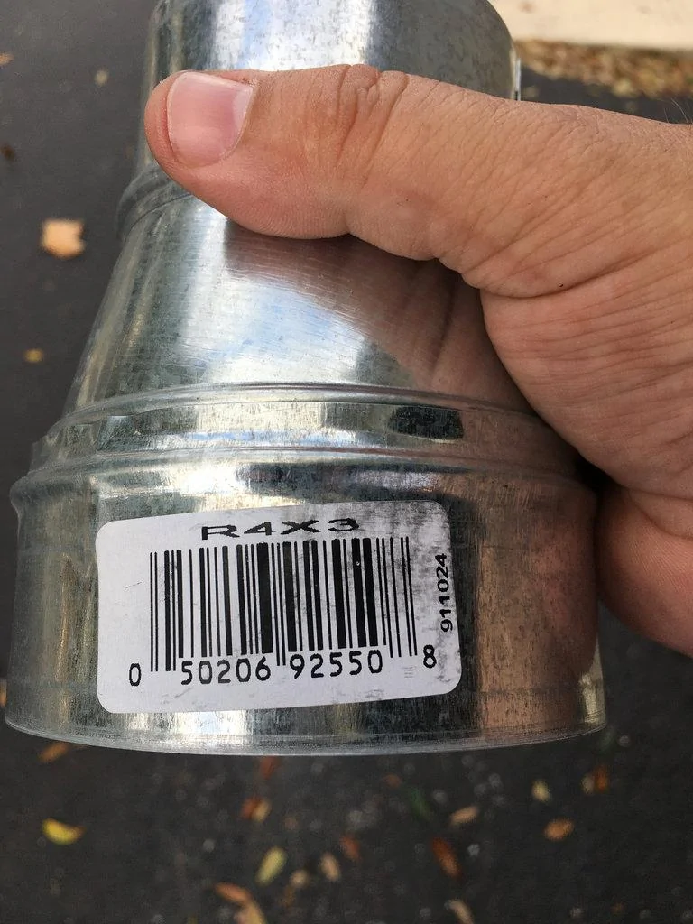

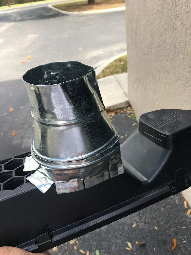

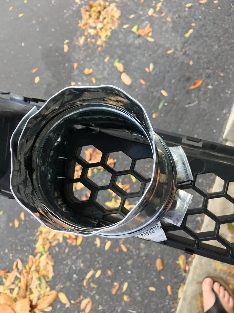

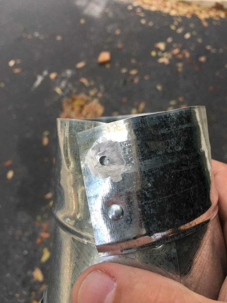

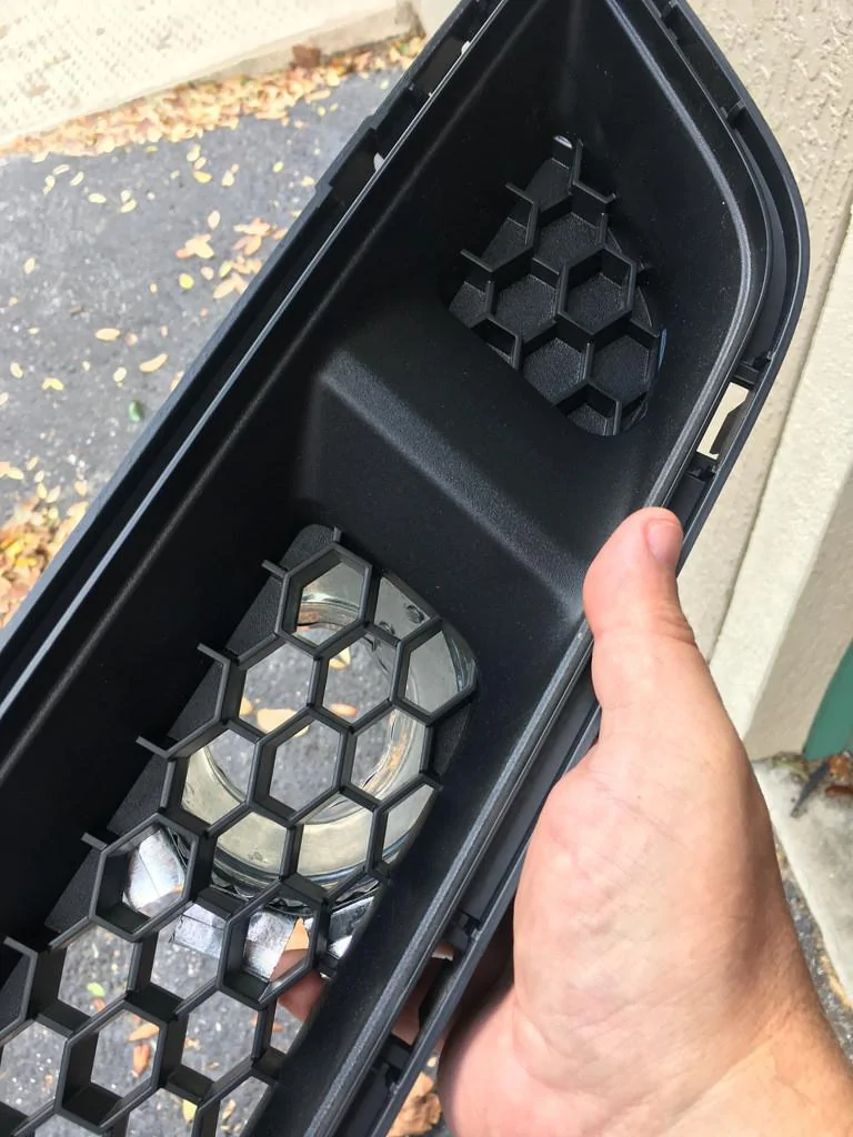

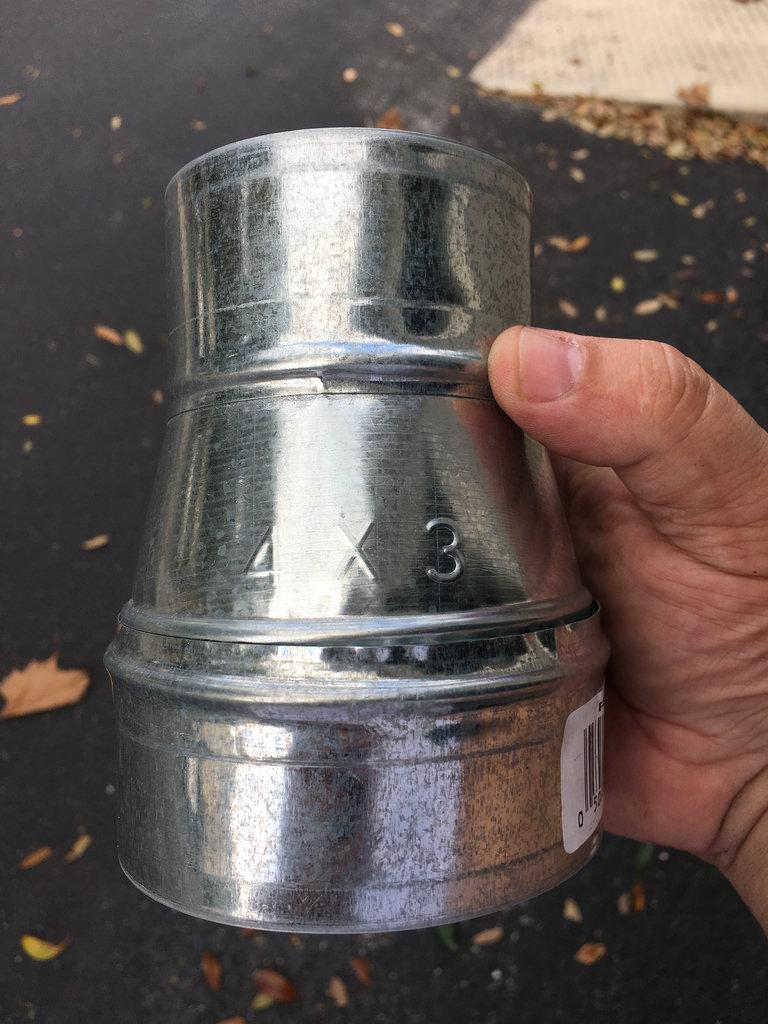

Brake duct project v2.0 -- taking back my fog lights.
I've been running the Full Tilt Boogie brake duct kit for several months and it is works great. However, I want my brake lights back. Someone <insert credit here> else had done a similar setup to what I'm trying but instead of using the the center section of the lower grill, opened up the outside sections of the grill.
Using the center should allow for a little more flow, and frankly should be easier to piece together.
This simply uses $10 worth of 4" - 3" return reducer from Home Depot. I could probably have used the plastic reducer/fog light insert that comes with the FTB kit, but I didn't want to cut into them should this setup fail.
Pics:
Untitled by Stoli-v, on Flickr

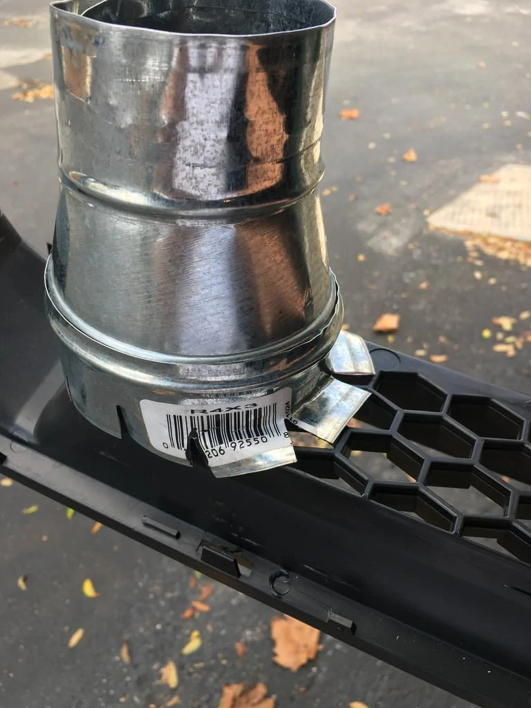

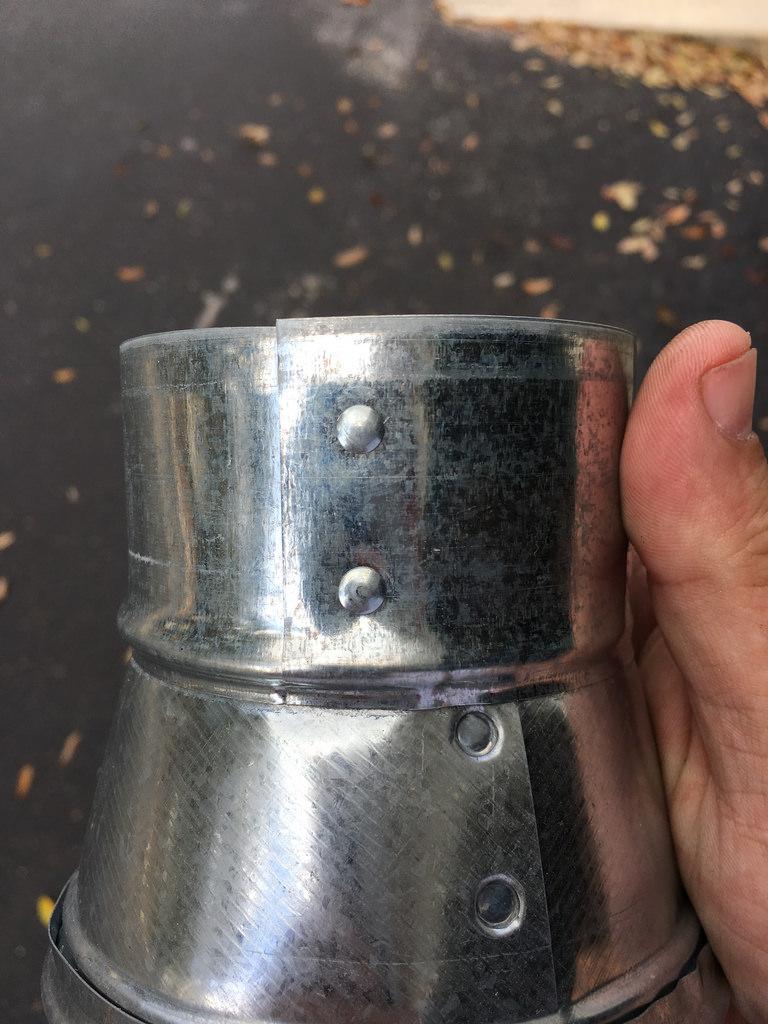

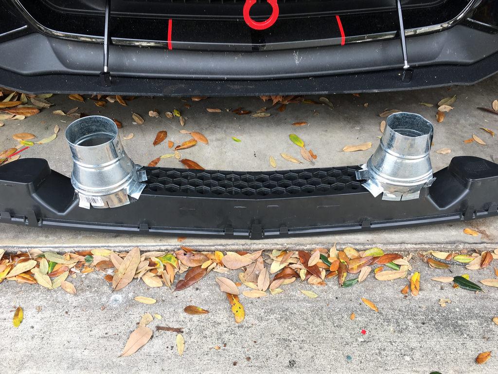

Sliced and bent for easier fitment

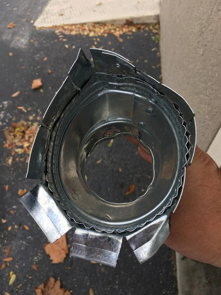

3" section is bent from me trying to get brake hose over it. Should have listened from the strat and removed the rivet. (It's winter in Florida, I had to wear sandles instead of barefoot)
Later this week I'll pull the bumper, test fit, and then clean it up and mount everything properly
