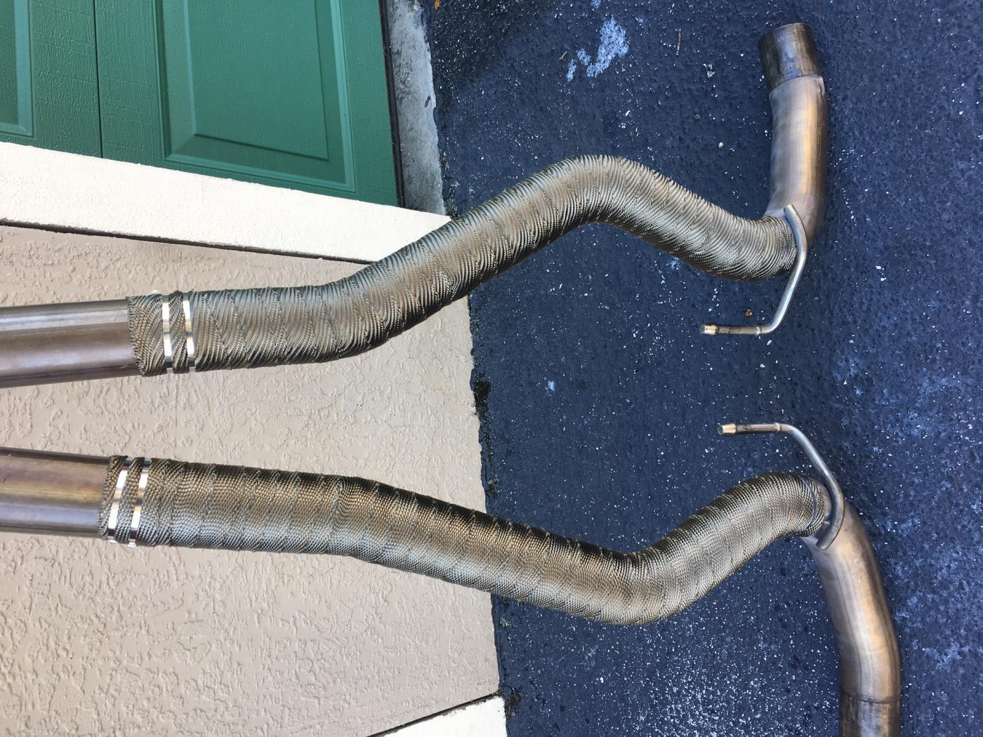

More heat reduction - heat wrap on the exhaust around the rear diff.

I like the titanium appearance better than the black that I used. I see you also used more overlap, which is necessary, IMO. I also chose 15' and did not wrap as far.
Think I will go 25' next time. I don't need it to go as far forward as yours. Thanks for the answer.

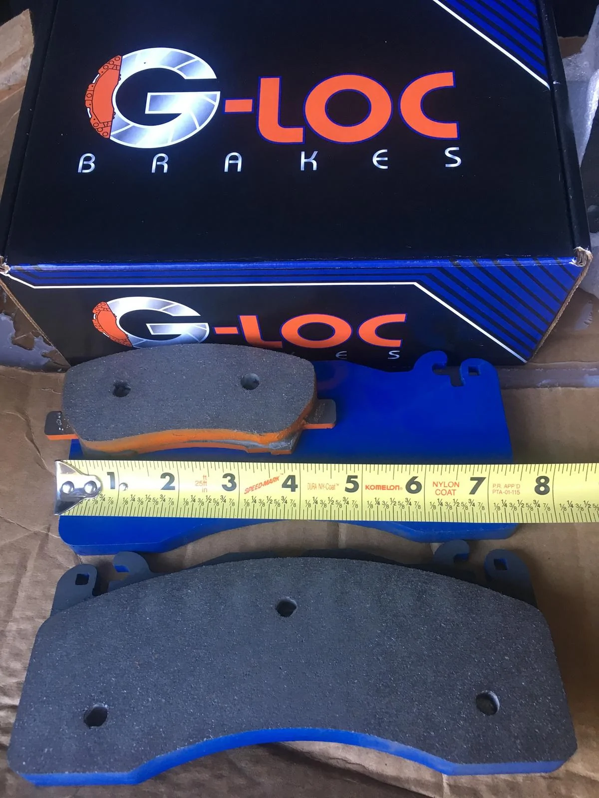

Thanks to [MENTION=22413]Optimum Performance[/MENTION] for the last minute brake pads!

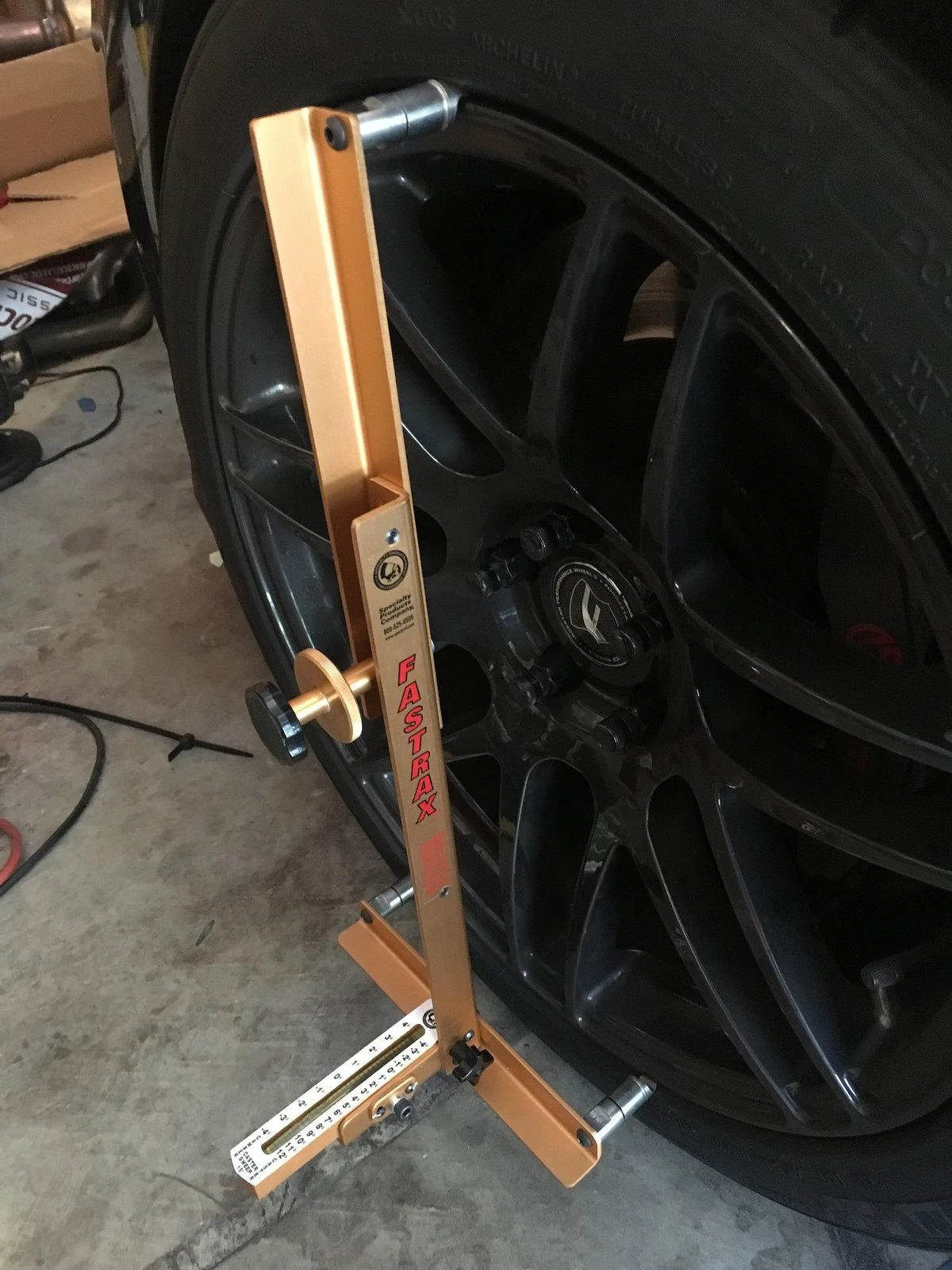

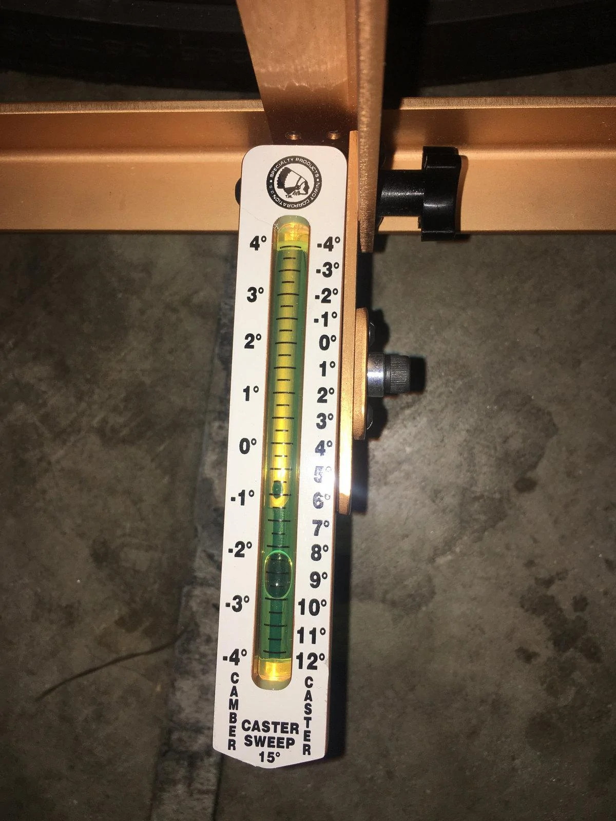

Finally I can dial in my camber at home. Firestone will be happy.

curious to see how you like the pads.
Which ones are those G8?
stoli
stoli
Fat Guy Racing
Sep 18, 2014
124
3,225
971
Lakeland, FL
John
'15 Black GT/PP
I had Carbotech XP10 front /XP8 rear and the fronts are toasted after ~5 months. These are R12/R10 - I don't expect these to last longer, but I do expect some more bite and less/no fade at the track.
I'll be @ the Firm Saturday to see how they do.
I run XP10 front and XP8 rear on my M3, they perform fantastic but as you discovered they do not last too long and the dust from the X10 is horrific.

I am going to change mine along with SRF after this round most looking forward to your thoughts.
See you Sat!
I honestly didn't find the dust any worse then the Brembo pads. That could also be in part to the Brembo dust being more brown and the the Carbotech being black/grey and blending in with my wheels better. ;)
See you Sat!
SRF is a definite. I wish I had skipped over the hassle and expense of the Motul and gone straight to that.
