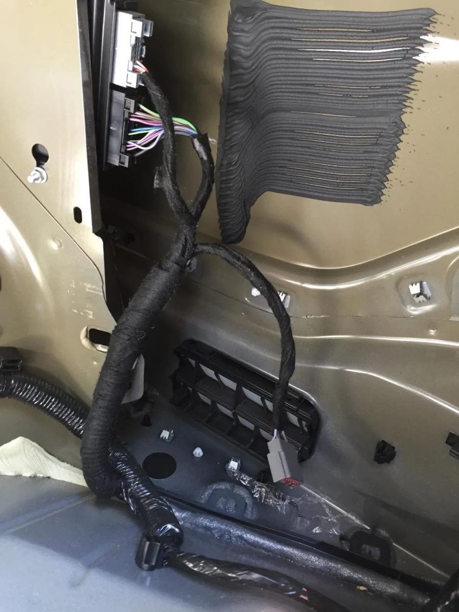

Just bought a factory sub, will not work on my 9 speaker setup. Missing factory connector. Had the original owner send a pic of his car 12 speaker setup and he has the harness while on my car it is missing.
Eddie
