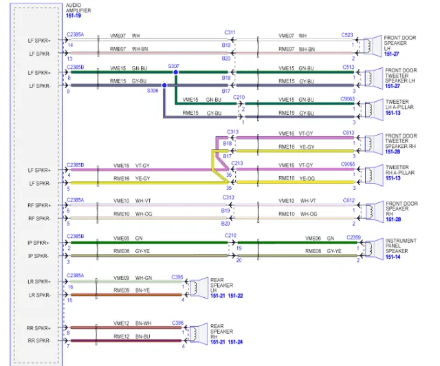

And another question looking at that.
The component tweeter in the door and the pillar tweeter are wired together? So there are two leads going to the 6.5 component in the lower part of the door? One for the tweeter?

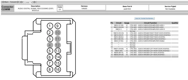

Thanks!
I remember seeing that in the thread (the connectors that is) but could not find it again.
So in this one I see the Sub out. However there are 4.
Pin 1 and 2 are the audio and pin 9 is the enable. Pin 3 is a 4 gauge wire? That cannot be right.
I don't know about that. We bypassed both amps when I put in my 5 ch amp. We just took the 4 line level signals to the amp. Point being that there is no dedicated sub out from the HU.
That looks like misleading labeling. There should be a dedicated channel going to each 6.5" in the lower doors. That's 2 channels from the amp.
There are 2 channels that feed the 3.5" mid in the upper door and the tweeter in the A pillars. That line is split (I believe) before the wire goes into the door.
The TwK-88 has 8 channels out. You need all 8 channels for your front stage?
4 L&R outputs.
Pillar tweets L&R
Door 3.5s L&R
Door 6.5s L&R
Center channel output
So yes the entire front stage will be used by the TwK88
