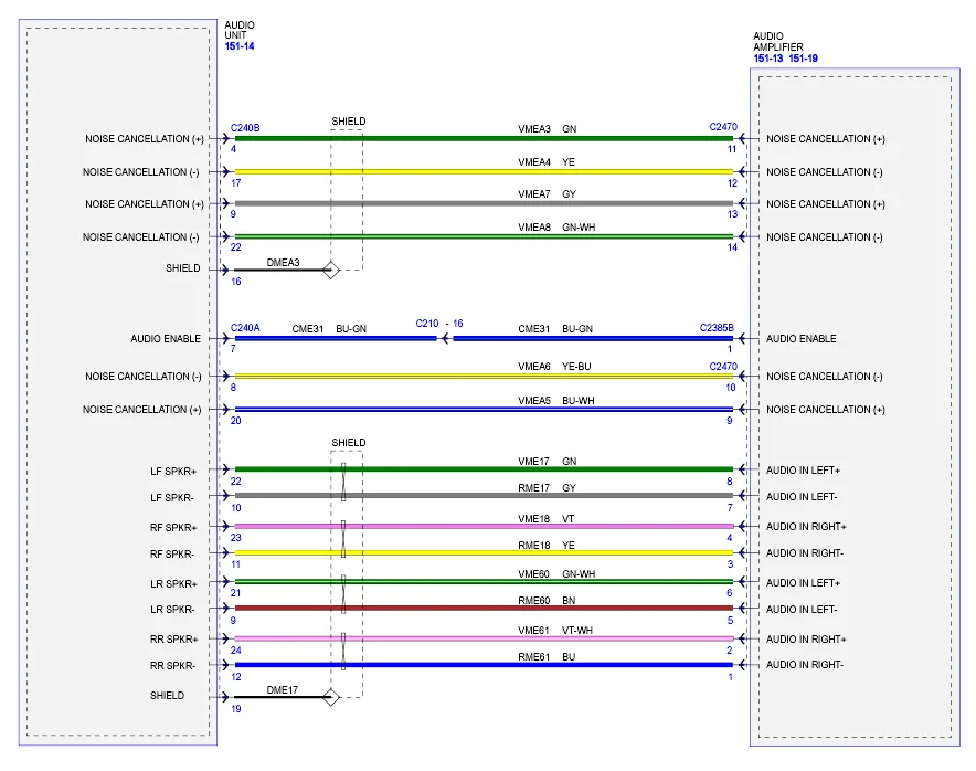

Although the diagram doesn't show a ground pin, I would suspect that the ACM is getting it's ground from the amp and now that the amp is not connected, the ground may be floating. Typically, a shield is a ground point, and the original diagram on page 1 shows pin 19 of the black plug as a shield. I'd connect a wire to pin 19 and while monitoring the hiss, touch the other end of the wire to the amp chassis which is still grounded and see if the hiss goes away.

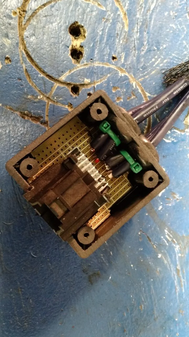

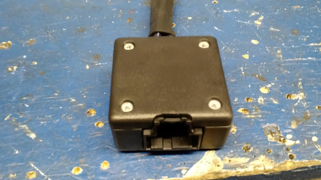

The Black plug unplugged and connected to my mouser socket with my own rca cables on pin 8&7 and Pins 4&3. I have a noticeable hiss, as reported before.
I made a new connector just in case.

I checked and rechecked my wiring and it is correct. I hope this diagram is correct.
eventually I used a ground wire disconnected the negatives on my RCA plugs and connected the ground to one channel RCA and the hiss went very quiet but still there a little?? i faded to the front and balance set to left and then right to confirm wiring is correct - confirmed it faded left and right.
all this makes no sense.
Can someone confirm this drawing is correct? how do run preamp outputs without this grounding issue?
Mumbles there is no pin 19 on the black? should I use pin 16?
Mumbles there is no pin 19 on the black? should I use pin 16? Sorry, I should have been more specific... I was referring to pin 19 (or 16) coming out of the ACM in the diagrame below;

I have all the mouser plugs. Simply soldered a RCA Cable to Pins 8/7 and 4/3 with the correct polarity.
I have multiple spares so I made a new one and with neat short wires. I tested it with my meter its correct no shorts and the polarity is correct. I am stumbled.

I have checked this and its also correct, besides I also have run it to my power amp and I have same problem anyway.
Pin16 is a Canbus negative so I nervous to use this one.

2 rca cables or 4 ? Are you using the rear channels?
Pin 8 is left front + / Pin 6 is left rear +
Pin 7 is left front - / Pin 5 is left rear -
Pin 4 is right front + / Pin 2 is right rear +
Pin 3 is right front - / Pin 1 is right rear -
Do not use the chassis ground for the rca connections.

Only 2 RCA, exactly as per your picture I have done the same. I only use Pin8/7 and 4/3
Should be simple and it is - cannot get more straight forward than that - so this tells me my issue is a problem with the ACM or you guys in the USA have something different in your wiring looms to the Aussie spec mustangs.
The Aussie spec has the factory amplifier in the passenger foot well compartment not drivers side. There has to be a difference.
I am going to cut into the preamp cable with it connected to the factory amplifier and tap off a pair of RCA cables leaving everything connected to the factory amplifier and see what happens as something in this black plug must be eliminating the hiss as the factory amplifier is not picking it up.

I'm glad you didn't cut into anything! It still seems like this is a ground issue... when you have everything plugged into the amp, the hiss goes away, correct? I think that is because when all the plugs are connected, you are picking up the appropriate ground on one of the pins... question is, which one? A semi-quick way to test this would be to unbolt the factory amp and pull it away from the chassis which should mean it's not grounded. If the hiss returns, then the amp is providing the ground to the ACM through one of the plugs.
What year is your GT? There have been differences noted between 15-16 years and 17 years, plus, yours is an Aussie version, so there is no guarantee the diagrams I used for my drawing match the wiring in your GT. The only way to be sure would be to measure the signals on each pin of the C2470 plug (blk).
Something else I noticed, in your post #539, there is a picture of a plug pin-out with highlighter markings labelled as pre-outs from the ACM, which should be on plug 2470. In the picture, the plug is labelled as C2385A, so something seems off there...?
Hi Mumbles - Sad to say I did cut into the loom and had to resolder with heat shrink each wire, fortunately..I am a soldering pro having worked on a production line in my early days.
To answer your comment about when I plug it into the amplifier the hiss goes away - if this was the case there wouldn't be an issue - my issue is if only 1 channel is plugged into the amplifier there is no hiss as soon as I plug the other channel in the hiss is introduced other than the hiss the audio is clear and I can fade left and right. The polarities are correct with my wiring. I also tried to disconnect one channels negative etc to see if it creating a ground loop etc but nothing seems to fix it.
Since the hiss is not present when the factory amplifier is connected in the system it does tell me that one of the wires in the ACM to the factory amp is eliminating the hiss. (grounding)
