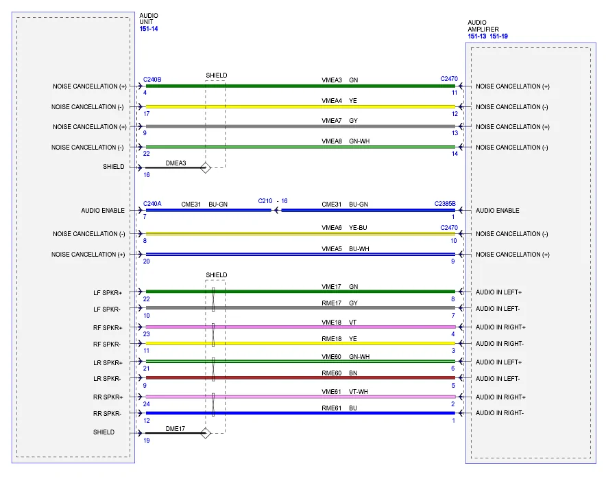

[MENTION=16062]rambunctious[/MENTION] [MENTION=20499]mumbles[/MENTION] [MENTION=25138]Fenix[/MENTION]
Having unpinned the 6 "Noise cancellation" signals I can confirm the "Engine Sound Enhancement (ESE)" (fake noise) is now gone. Thanks to you guys for that.
It got me thinking - are the 3 pairs of cables (pins 9-14 on the amp below) really all used for Noise Cancellation (NC)? It seems weird that pins 9 and 10 are not shielded with pins 11-14?
Do any of you guys know the exact nature of the signal on these three pairs? I had thought they were front/rear/sub pairs, but that would seem overkill for noise cancellation. Is it possible that pins 11-14 are front/rear Noise Cancellation pairs, and cables 9 and 10 are related to the "Engine Sound Enhancement"?
I could test this myself, but although I have a way to test if ESE is active, I do not know how to test if the NC is active - any ideas?
I think you may have just helped me to identify exactly which pins to remove from the amp to disable the fake engine noises once and for all :)

@rambunctious @mumbles @Fenix
It is my understanding that sound enhancement is only present in the Ecoboost and can be defeated either by modifying data in the ASM via Forscan or by disconnecting the mic in the rear headliner (or near map lights in the vert).
As for the shielding, not sure if it's because they are on separate plugs or ?
acull2000
Dec 7, 2015
275
43
UK
iPace
Thanks for quick reply. Had forgotten most aren't fussed by this as sound enhancement is Ecoboost only. I guess V8s have the same 3 pairs (which could either indicate all 6 wires are needed for noise cancellation, or that Ford fitted the same harness to all vehicles for cost measures).
Unpinning the harness is the preferred way to remove ESE:
  • Modifying ACM parameter (727-01-01 XX*X-XXXX-XX) in Forscan only tricks the car into thinking it's a base model and sends speaker level outputs to the amp. This disables ESE (and probably ANC too), but obviously stereo quality is compromised.
  • Disconnecting the mic disables ANC (but not ESE!).
I fear disabling ANC also reduces bluetooth call quality, so am curious how to retain ANC whilst keeping ESE disabled. Any tests I can do to check whether ANC is enabled/disabled?
Since the tweeters and mids are run in parallel in the three way system, I would tend to think that the 3 pairs of wires are run to the 6.5's, the mid/tweet combo, and the rears, but I could be mistaken.
I havent played with the ASM at all, so I can't comment there, but from all accounts, disabling the mic removes a low freq rumble often heard in the factory sub which sounds like some sort of sound enhancement?

I am sure disconnecting the mic does not deactivate the Engine Sound Enhancement - this can be tested on vehicles tuned with an Accessport (where the tune slot is indicated using the rev counter) - when changing tune slots the stereo can be heard emitting the "growling" noise depending on rpm. This happens even with engine off, showing the ESE is active.
Disconnecting the mic does not disable this effect, but I imagine it does trip up the ANC.
I can only image those people disconnecting the mic are disabling ANC, which in cars with any acoustic mods (exhaust, tune, cabin/ stereo mods), may also remove any untoward noises from the sub, caused by a mis-match of stock ANC and the new acoustics of their particular vehicle.
Still looking for a way to test for presence of ANC and I can prove this!
ANC is only on ecoboost
ESE is only on GT350
ANC is disabled by open door or trunk lid
I believe the reason for 3 pairs noise cancel lines is the ANC/ESE is only feed to door woofers and shaker. On GT350 rear shelf speakers are woofers and feed ESE
see factory service notes at
http://www.mustang6g.com/forums/showthread.php?t=89170
ecoboost and GT350 have ESE
ESE in GT350 was the big surprise for many of those buyers......
